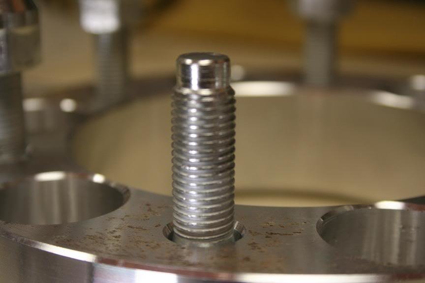

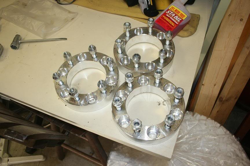

    Pic of the 3 good spacers
    Pic of one of the studs, they all look good

    they do look like they are in perfect condition. correct me if i'm wrong though (quite possible i am), but aren't 2001s supposed to be running hub-centric? if so, i think we've found the problem. if not...my bad

    yea I think thats your problem, lug centric wheel spacers are bad news and disasters waiting to happen. If i were you i'd sell those off or trash them and purchase some hubcentric spacers. It centers everything better onto your hub and reduces the chance of stress on the lugs

    exactly. with lug-centric, the wheel is both centered by and supported by the lugs, which would explain why the bolts sheared.
