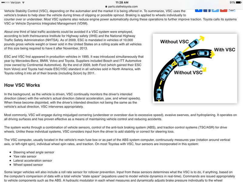

    Thanks for the info and exactly my plan. What exactly is VSC and why does the truck break on its own? Which sure feels like the ABS during a no traction situation.
    Could this be the reason why the service manager mentioned a yaw sensor? Which I was told that checked fine but they did reset to verify.
    Found a good explanation for it. This is definitely what I'm experiencing and explains how ABS is used during. There are many roads around here and through the pass that do not have an even flow through them. So it "senses" that I'm now turning harder and it takes over. In the pic above, when I'm on the middle line, it sends me towards the top line. That is what I have an issue with.

    As Jimmyh said...I think you are confusing VSC (vehicle stability control) to ABS(anti lock brake system). ABS is to stop the wheels from locking up by pulsating the brakes in an abrupt stopping or loss of traction scenario. The throttle control and how the vehicle wants to move a certain way is the function of the VSC. From what you are describing, you like to drive your truck like a race car at the track. Nothing wrong with that other than not being safe for other drivers on the road...should be for the track than public roads. But if you are normally driving and you are hot into the corners often...of course the VSC and ABS will not behave the way you want it. That's the reason why you disable VSC and ABS for those situation at the track when you want total control of the vehicle around the track.

    Yup. That's Toyota's fancy name for the internal gyro the truck has. :thumbsup:

    Yes. I did figure that out and researched about VSC.

    Yes exactly that. You can turn off the VSC by pressing the VSC OFF Switch for 3-5 seconds with the vehicle at a standstill. Of course you then have to do this every time you start the truck....
