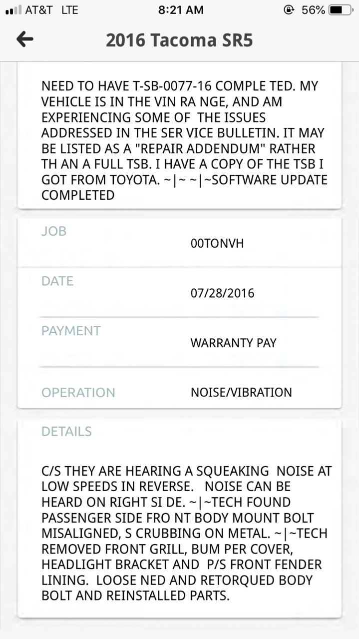

    Dealer took care of it in about an hour. They could hear it driving out of the Welcome area.

    do you know what the dealer did?

    Here's the service write-up. It's the bottom one.
