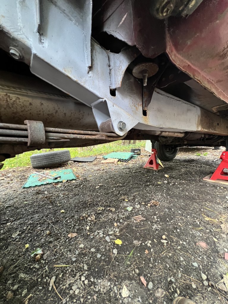

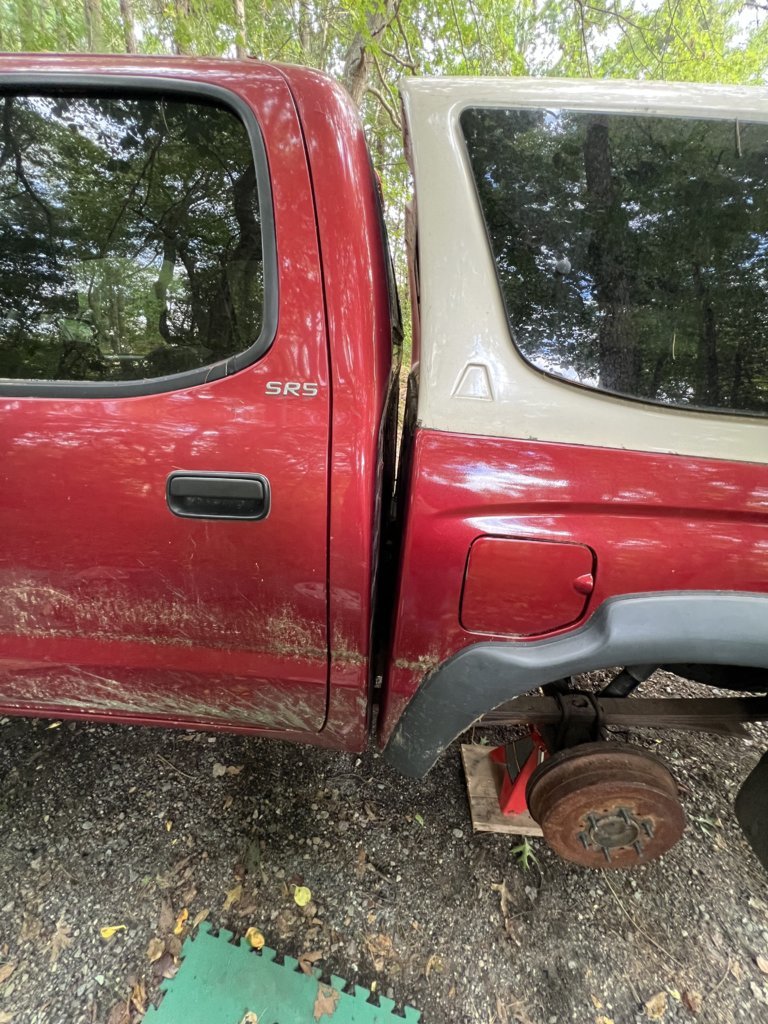

    So I had my welder friend weld on a leaf spring safe t cap the other day and now there’s a substantial gap between bed and cab. (There was a negligible gap before) it was supported on jack stands for like a week before he welded it. I was going to do the other side and replace leaf springs but something tells me there’s a bigger issue. Any advice would be appreciated. Thanks!

    Most likely the frame has distorted as a result of heat from the welding. I believe what happens is that when the metal cools it shrinks, so in this case it pulled the bottom of your frame shorter sort of bowing it into a rainbow shape.
    not sure if it can be fixed without cutting the welds. You might just live with it. I’d be concerned about it getting worse when do the other side.

    Agree with @Jakerou
    Trying to undo (or redo) the weld reinforcement would be very difficult.
    Perhaps place spacers under the rear bed attach points to line the bed up with the cab. Be sure to brace the other side and go slow with the welding (too much heat on one run can cause distortion.)
    When it's all said and done you'll probably want to re-align your rear axle/wheels.

    I wonder if perhaps some of the mounts can be modified? Some sort of spacers on the rear ones?

    Heat deformation.
    Bet he did long continuous welds instead of jumping around short welds letting it cool a bit in between zaps.
    I might have bowed a trailer once putting too much heat in a weld. :anonymous:

    Might have to shim the bed up off the frame

    You’d need to cut the side he welded and square it up when you do the other side.

    I'd think about cutting a small wedge so it sits back down and then rewelding that cut. Maybe find a different welder...

    Take the bed off, cut the welds that allow you to put it back square with string / magnetic angle finder etc. and put some bracing on it while you weld - cheap sticks of 3/16 angle iron or .120 wall / schedule 40 round tube can be heavy tacked to the frame to help keep it square while fabricating.

    Take the lesson here and tack first, fill in in 1-2inch intervals
