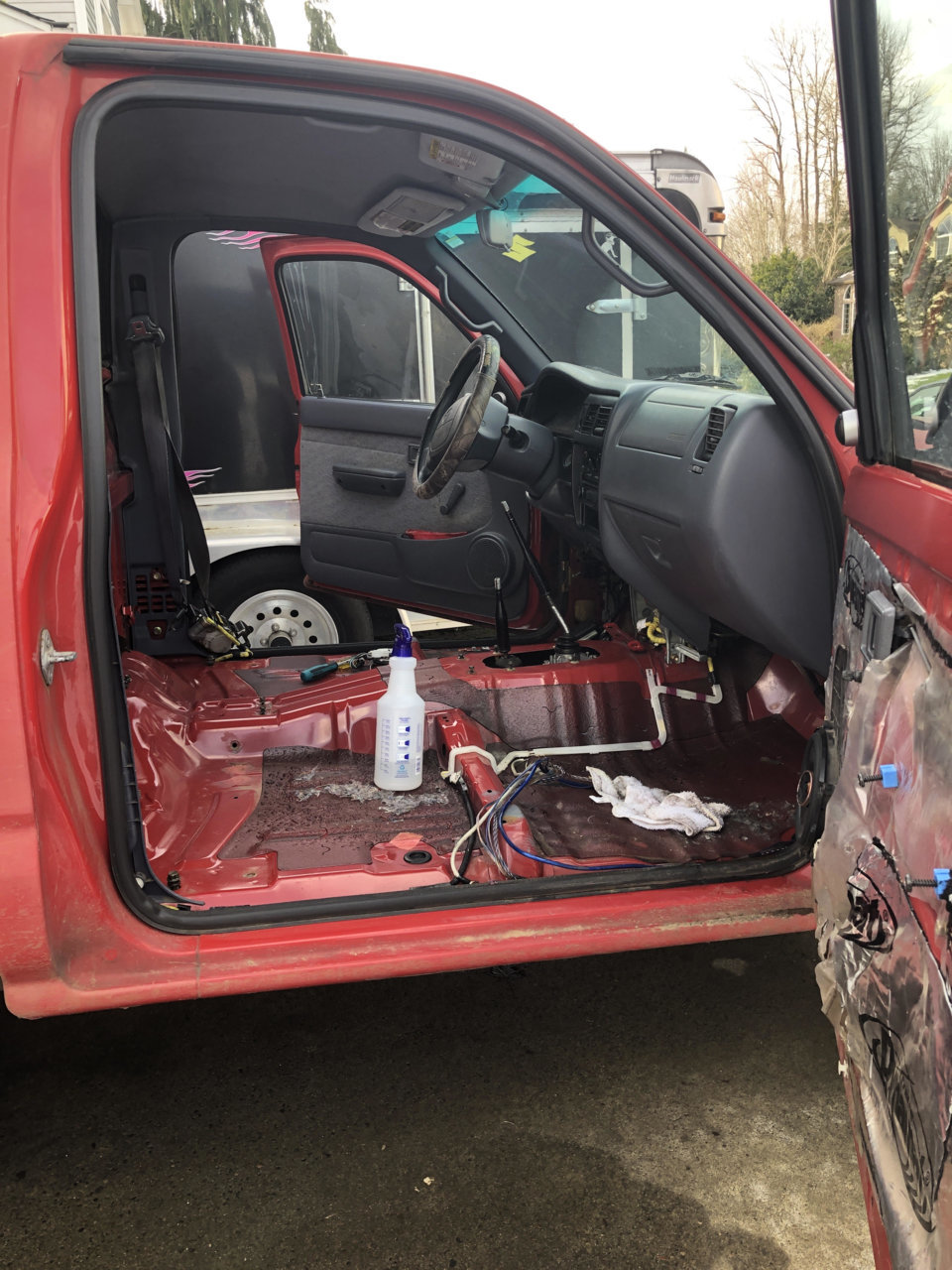

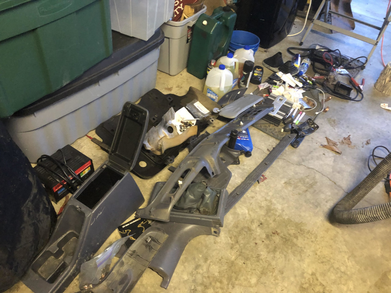

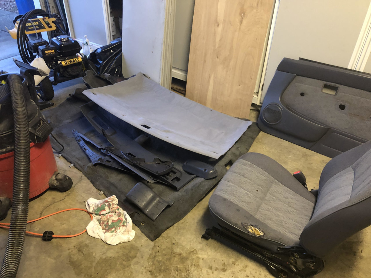

    We got a wicked snowstorm a few weeks ago, so of course I wanted to take my Tacoma out of the garage where it had been sitting since hunting in November but when I jumped in I noticed that the whole interior was covered in mold, Oh No!.
    I'm super grateful that the snow came when it did because I haven't found much damage that can't be scrubbed out but this has turned into one of those projects that keeps getting worse as you dive in. Initially I thought I'd just have to pull the seats and scrub the carpet but everything I removed had more mold behind it so I just kept removing parts until everything but the dash was lying on my garage floor.
    I've sprayed everything down with a vinegar solution to stop the spread, then used tons of carpet shampoo and a brush before wet-vaccing it all out and drying it in my garage. This has worked pretty well and I'm down to just the passenger seat and about half the trim pieces left to clean before reinstalling.
    Before I get it all cleaned up though, is there any cool interior mods anyone suggests? I plan on getting some cool fabric for the door panels and I would love to build some storage solutions into the space behind the seats or on the roof of the cab since space is at such a premium in a regular cab. I know the headliner is too weak to hold anything but is there a Molle panel that could be fastened to the roof? Maybe an upgraded rear-view mirror/dome light? Any ideas are welcome!
    I broke a couple trim fasteners in the process, I'm going to blame the 20yr old plastic lol, anyone know where to find the little doo-dad that attaches the plastic box around the seatbelt mechanism or the bigger round fastener that holds the trim under the climate controls/radio in grey?
    Last question, I needed to pull the chicken bars off the cab pillars and was super careful to use the right type of screwdriver, the driver's side came off way easier than expected but that lulled me into a false sense of security and I stripped the hell out of one of the passenger side screws. Anyone have a good method for getting that screw out of there? Damn thing came out half a turn then welded itself into the threads.

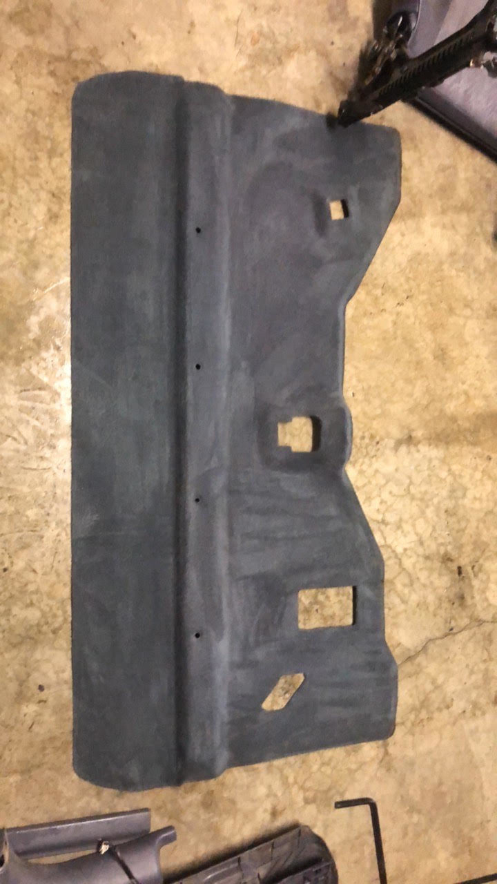

    Typical “sound deadener” on the floor will yield very little results.
    This type of product effectively gets rid of resonance by stiffening up a body panel that otherwise vibrates resonates.
    The floor of our trucks is already pretty stiff given all the bracing, seats bolted to it etc.
    The best product for the floor is mass loaded vinyl. It will cut down on the frequencies coming from that part of the cab.
    The doors (notably the outer door skins) and rear wall is where the sound deadener pieces will be incredibly effective.
