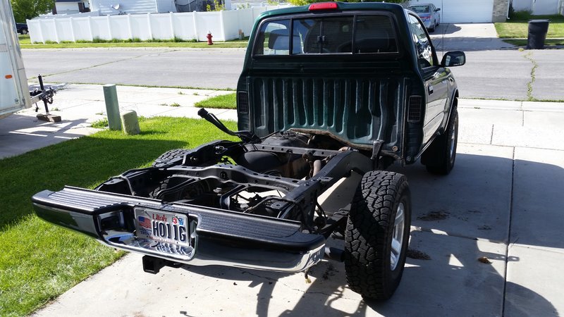

    #16
    retroboy1989
    retroboy1989 Single Cab 4x4
    Apr 8, 2016
    #183693
    738
    99 2.7L 5spd 4x4
    :goingcrazy:
    How i feel everytime one of these threads pops up.
    :rain:
    This was me a couple months ago..
    Lucky my truck had only lived in Virgina, Alaska, and Utah...
    :bananadead:
    DJB1 likes this.
  17. Jul 14, 2016 at 9:50 PM
    #17
    MatthewMay1
    MatthewMay1 I'm an amateur professional.
    Nov 21, 2011
    #67486
    11,107
    Matthew
    Lone Star Republic
    Supercharged '01 TRD
    Might be the cleanest looking stock rear bumper I've ever seen
  18. Jul 14, 2016 at 10:09 PM
    #18
    retroboy1989
    Apr 8, 2016
    #183693
    738
    99 2.7L 5spd 4x4
    Brand new oem. I had just bolted it on that day when I finished painting the frame.
    It sat in a Toyota box for 17 years in some guy's garage.
