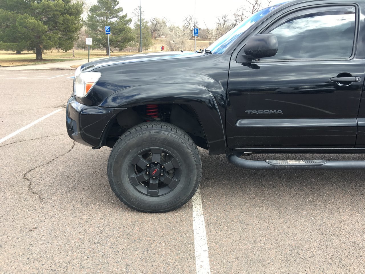

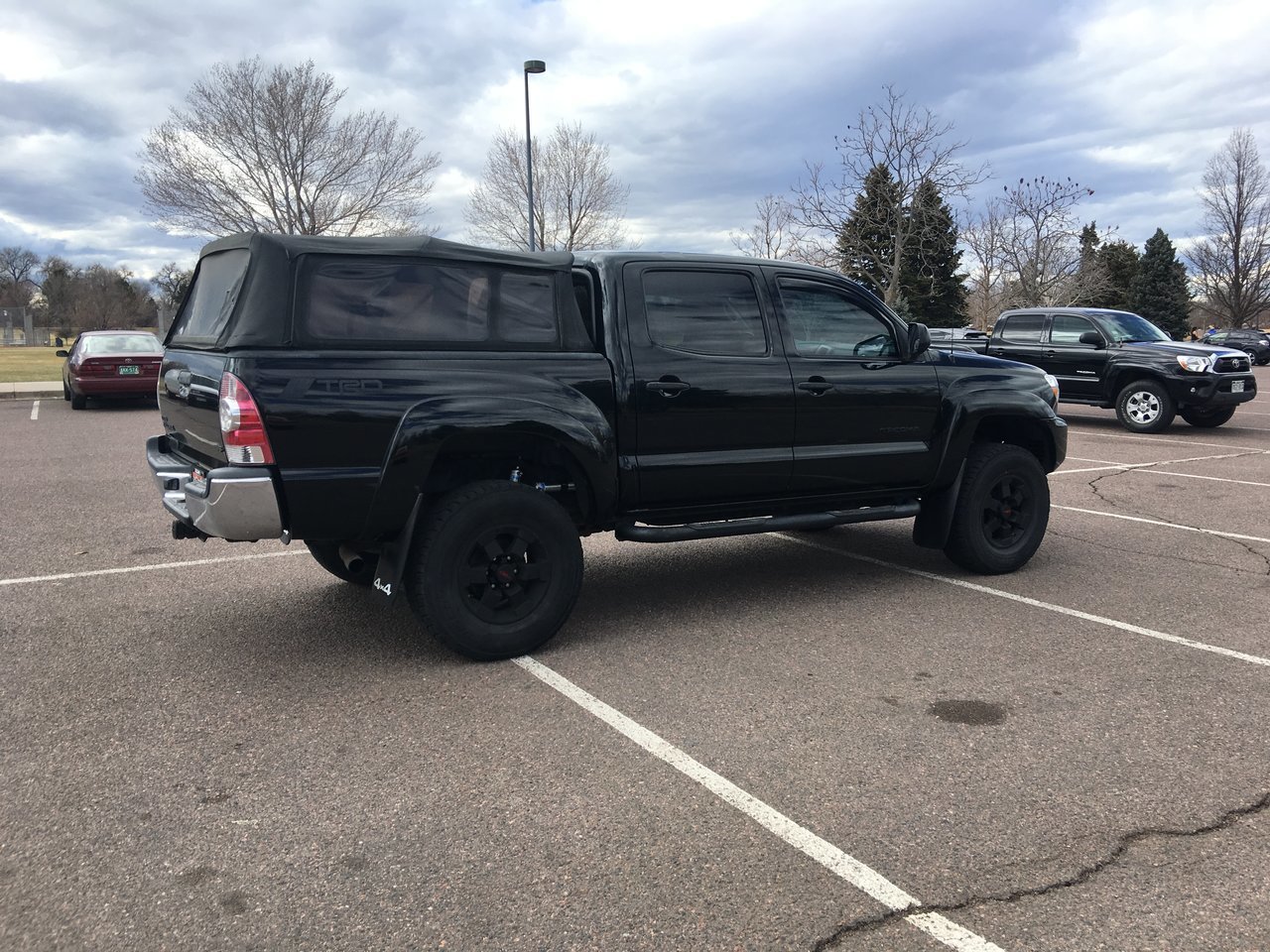

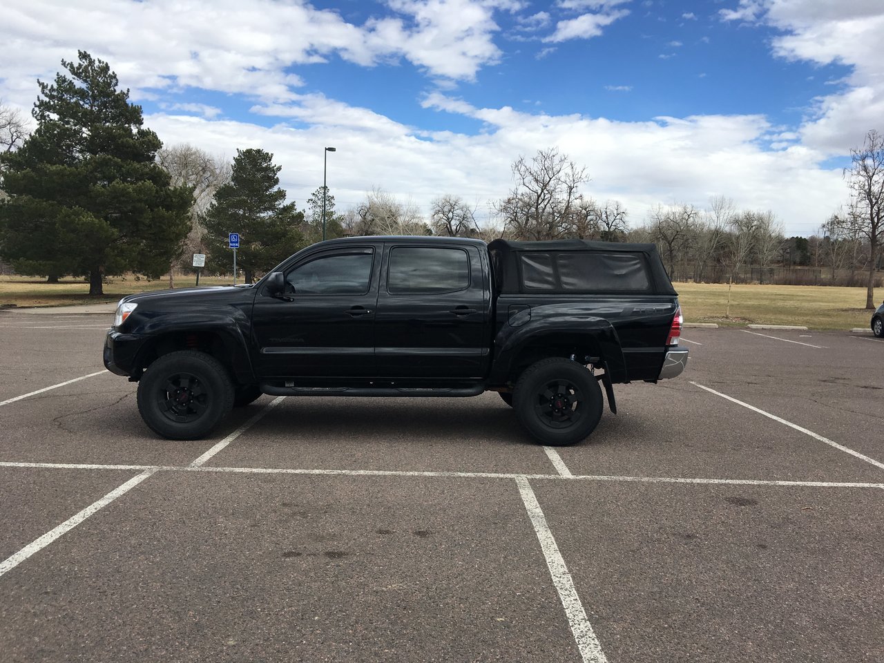

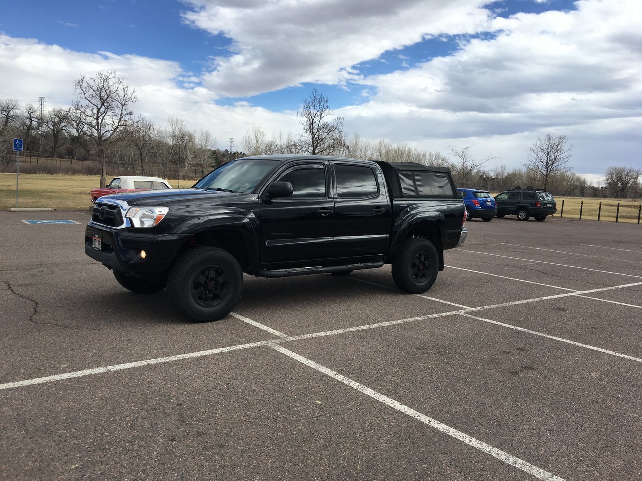

    Completed lift install last night. Running:
    TRD PRO Suspension System (Bilstein)
    TOYTEC TRD PRO 1" lift (spring perch)
    TOYEC BOSS Rear Leaf Springs
    Before measurements (Hub to fender):
    LF 20.25 RF 20.5
    LR 22 RR 21.5
    After:
    LF 23.25 RF 23
    LR 24.25 RR 24
    Net gain, about 3" in front and 2" in back.
    Everything went smoothly, except one of the front leaf spring bolts was completely seized to the sleeve in the leaf. Had to cut the bolt on either side of the leaf spring, and after going through several cheap blades the 'Diablo Steel Demon' blades from HD actually made very quick work of it.IMG_5389.jpgIMG_8568.jpgIMG_7711.jpgIMG_9445.jpgIMG_7664.jpgIMG_8700.jpg

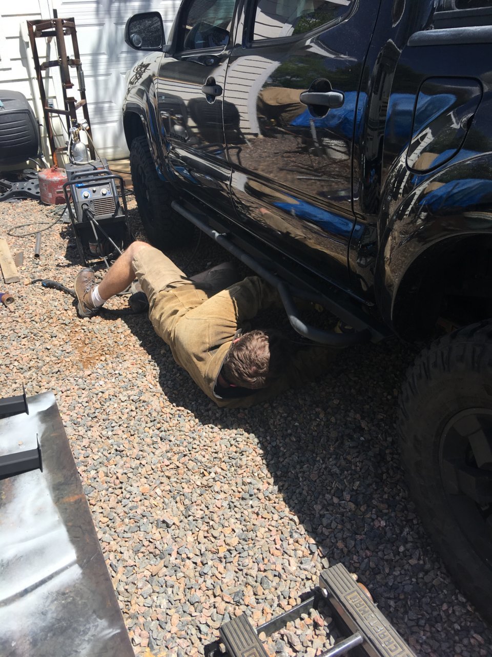

    Slider install a couple months back:F1557B92-B045-4BA4-8A19-74E13D40C654.jpg
