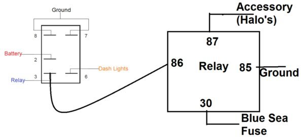

    2649e2149f1fd07638ef537802027cc8_525ed3060cb6237f800bafcb702f486844e3ccd7.jpg Here is the way to wire up the v1d1 switches. I am also using skygears fuse box for my accessories. So in my quest to have the switch work properly I actually undid my fog light wires and used the green on pin 6 and black/white pin 7. Now with me doing that the bottom portion of my lights will come on when I have the dtrls on. The top portion will light up whenever I turn any accessories on. I basically rewired my fogs to do this. But tapping wires for the accessories and ignition isn't hard

    I'll give as much info as I can.lol

    I had the switches working but the only way I got the bottom portion to come on was using fog wires. Now you can always tap those wires for the pins I mentioned as well

    I have the same halos trs xb. Usually its just a power and a negative but I wanted to be safe so relay it is
