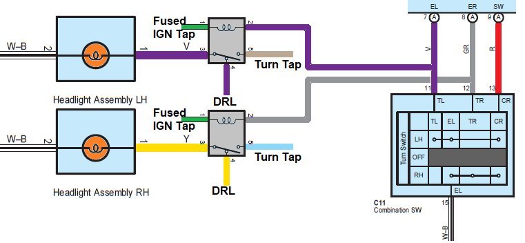

    The signal needs to be separated with a controller. If you plug it in without the switchback controller, the switchback bulb will just be amber. You can get around that on the halo, but not cleanly as your don’t have a constant DRL signal. It pulses with the turn signal.

    If you want high quality you’ll definitely want to use a controller or tap the rear signals to separate the DRL signal from the turn signal. Or coincidentally @Puppypunter has a solution for this as well with a harness so you wouldn’t have to tap the rear signals.
    I’ve only done mine with dual Diode Dynamics halos or currently Diode Dynamics 12” strips with Diode Dynamics halos. I have the led strip and halo turn signal wires soldered together to a wire going to the rear signals. When I turn on my turn signals both the halo and led strip both switch to amber at the same time and blink at together. When you turn off the signal there is a slight delay when the halo and led strip goes from amber to white. This happens in OEM switchback signals as well, not a biggie.

    @caribe makaira
    Couldn’t the DRL in this diagram be the feed for the white setting of the halo + switchback bulb (read the thread) and the TURN be the amber feed? Or some iteration.

    There’s different ways to do it. There’s actually an unused USB fuse you can tap in to in the cab fuse panel. I’m actually using that to power my RGBW high beams.

    DRL would turn OFF when?

    Well it should go off when low beams are selected. My question was, having a constant feed to Halo's and switchbacks with the DRL circuit. Priority in those lamps is TURN (intermittent) or DRL (Constant)?

    It would backfeed into circuit. Parking/Tails ON all the time.
