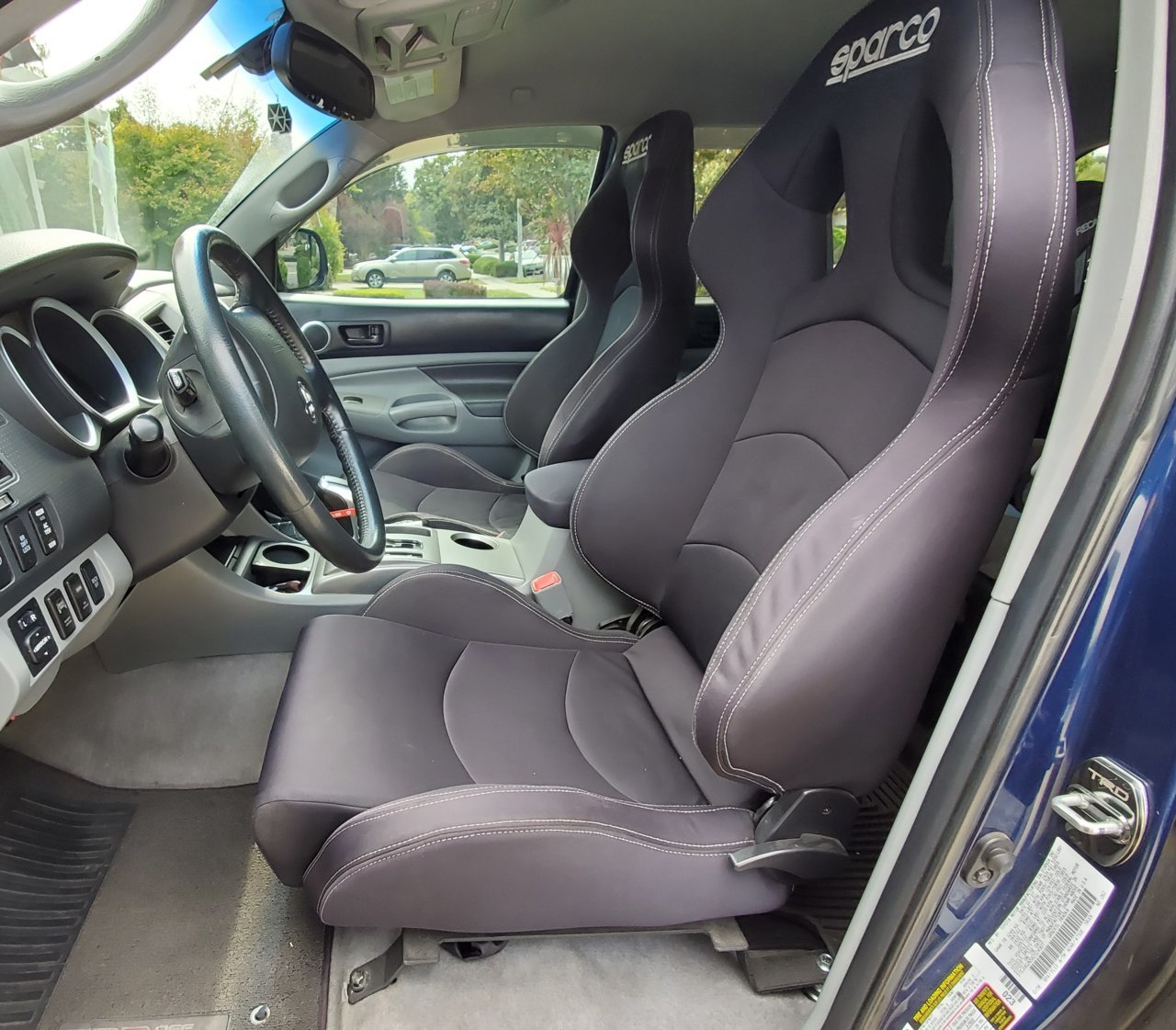

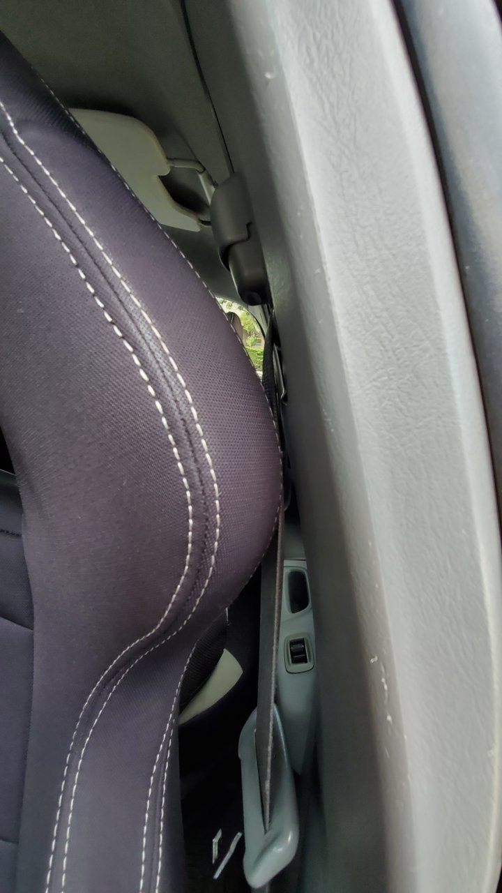

    @Oggy I'm 5'9 and here's my Sparco non-halo.
    This is my sitting position. Notice where the upper headrest is near the B pillar.

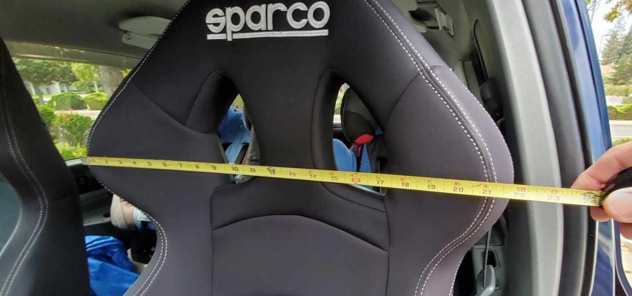

    Here's how tight it is to the center console.
    The widest part of the upper portion of my seat is about 22-23". Hopefully, the halo part is narrower.
    Hope this information helps your build!
