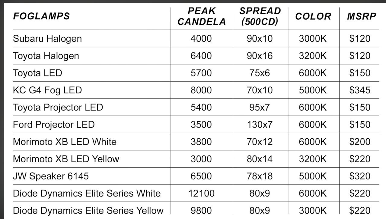

    Agreed on having wide fogs. Here is an output table published by Diode Dynamics:
    The Toyota halogen fogs in this table are the wide angle units. The Toyota OEM LED fogs on the Tacoma are the Toyota Projector LEDs, the other Toyota units are reflector LEDs found on other models.
    You can see the Toyota projector LED is slightly wider than the halogen fogs, but the pattern is shorter and output intensity is lower. The H16 fogs are not shown on this table, the OEM LEDs would be an upgrade over the H16s. You can see the Elite selective yellow are a pretty good upgrade over either, though slightly narrower beam pattern.
    I have not run measured tests with the Tungsram bulbs unfortunately and I no longer have the H11 fogs to do so. You can see in the table though the H11 fogs performance is quite good, and a bulb upgrade will only make it better. I’d use the Platinums over the +130s, the Platinums don’t have the blue coating on the back of the bulb so you won’t have the filtration output losses and get more output delivered to the roadway.

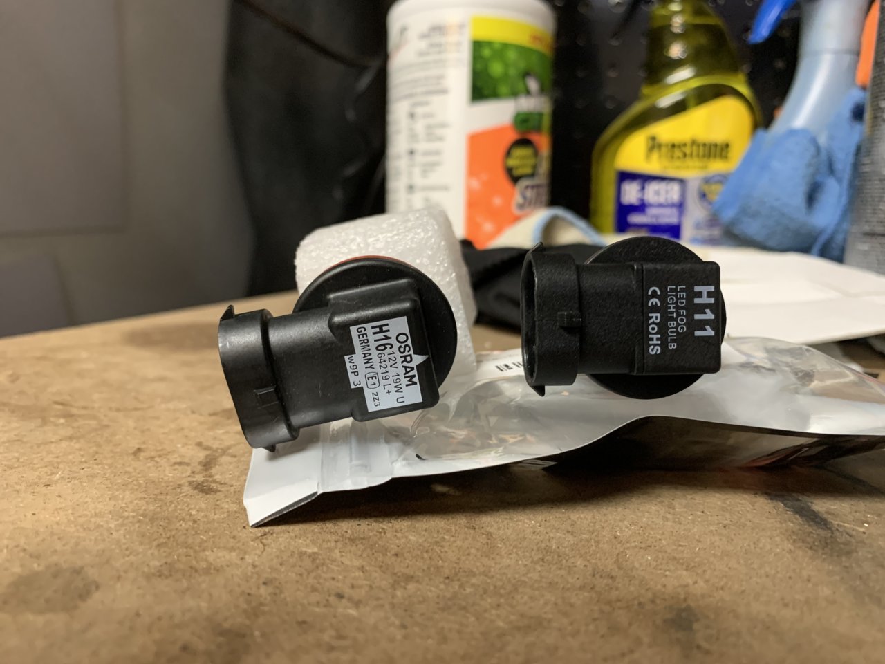

    Maybe the aftermarket bulbs are labeled wrong says h11/h16 bulb the oem bulb was a h16 but I thought I was putting a h11 bulb in.

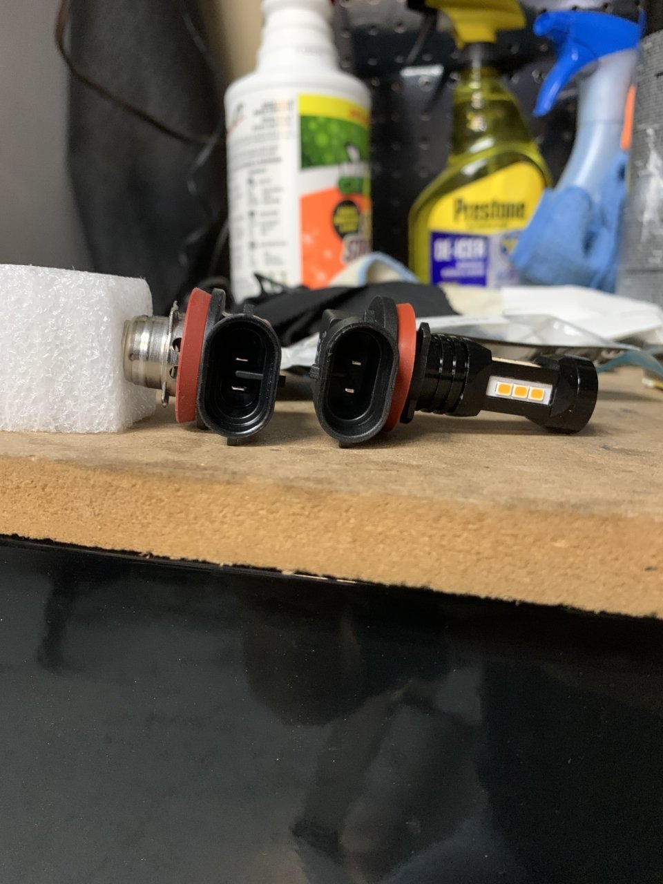

    Definitely do not put that garbage glare monster LED in there. Performance will be terrible and you will have crazy glare which is a hazard to other drivers and defeats the entire purpose of a fog light. If you want LED you need to swap to an assembly designed for LED to do it correctly, like the LED assemblies mentioned earlier.
    H16 and H11 use the same base plug, aftermarket LED manufactures will design LEDs to fit as many bulb types as possible with one product so they don’t need to make a bunch of different versions for the different bulb types, hence it is designed to fit multiple and labeled as an H11 but sold for H16 and H11, likely H9 too.

    @tacos4u as was said, please don't put that trash bulb in. The filament being the same size and in the same location is paramount in getting a focused output from your lights and as you can see that meets neither criteria.
