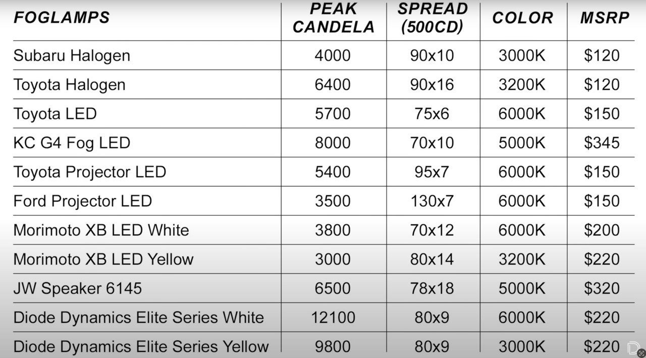

    I will disagree with one of the previous posts. I thought the OEM Fog lights were terrible even when properly aimed. I upgraded about 10 years ago to the Morimoto XB LED Tacoma Fog lights and they were much better/brighter. I have heard the new Diode Dynamics Elites are even better/brighter and probably the best.

    This is inaccurate. The OEM fogs use 1250 lumen H11 bulbs, the Morimotos don't even produce that in raw LED output ratings much less actual. The Morimoto XBs are so dated and no match for Toyotas OEM H11 halogen fogs. See output tables below, which mirror my own testing. Toyotas H11 fogs beat Motimoto in peak intensity, spread and height, aka every important performance metric.
    Diode Dynamics Elites are certainly superior, though the OP was asking specifically about halogens. While the Elites are great fogs they will lack the heat output to melt snow if that is a concern. Even when pairing with halogens, if snow melt is not a concern it would be worth considering the Elites in selective yellow to pair with the OEM halogen headlamps.

    I have to agree with crash here. I too went from OEM halogens in my 2014 Tacoma to the Morimoto XB's - and was very disappointed with the output. Then one, then the other failed due to corrosion in less than 2 years. Although they were promptly replaced under warranty, it was time to bail. (I now run Diode Dynamics SS3 Max fogs.) The OEM halogens with the above mentioned bulb upgrade should be just fine for the OP.

    I have heard of them, yes. I have not personally tried the ESUSE version of that product. They were one of the first widely available aftermarket SAE LED fogs on the market, preceding the Morimoto branded fogs. I believe Morimoto partnered with ESUSE to have them white label brand their ESUSE fogs as Morimotos. Aka the products are actually the same product. In comparison to current modern products, the Morimoto/ESUSE fogs are very dated. The products have a good pattern and cut off, but output intensity is much lower than the competition.
