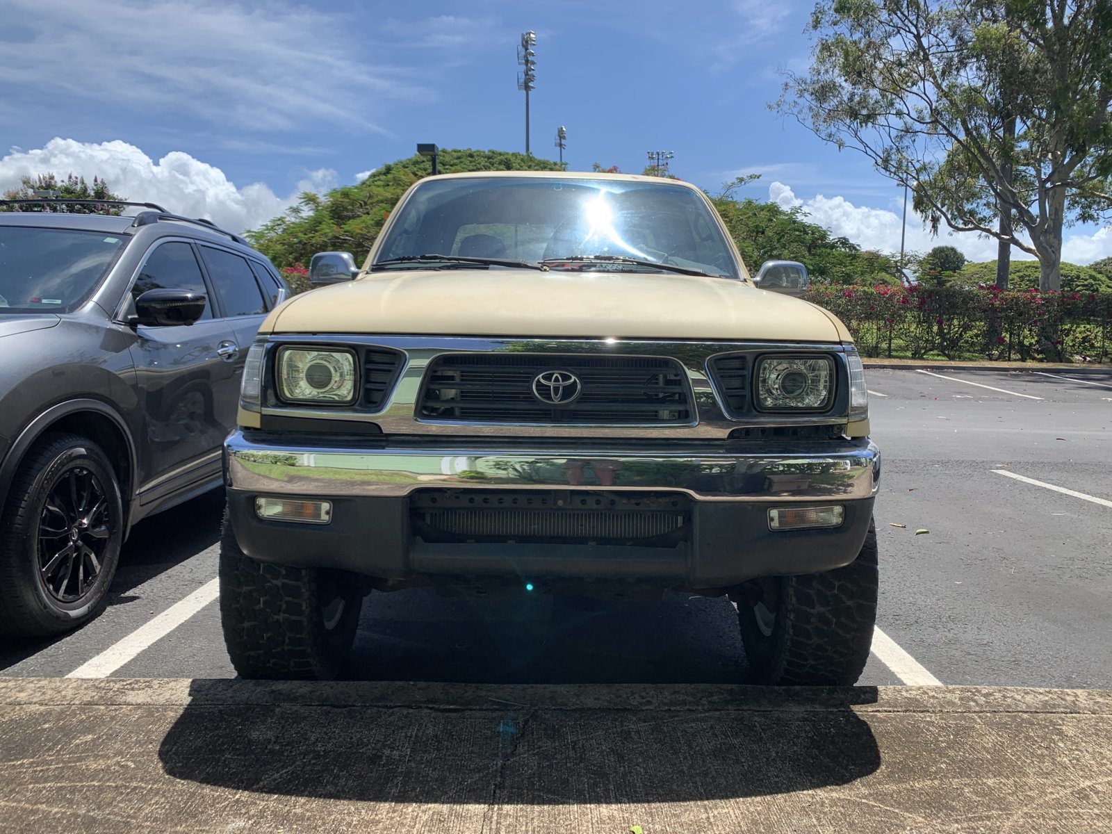

    Bob - Nice work. Those look great. Appreciate the recommendation. These are really the only aftermarket option I've seen that aren't sealed beam. Big plus that they're glass too.

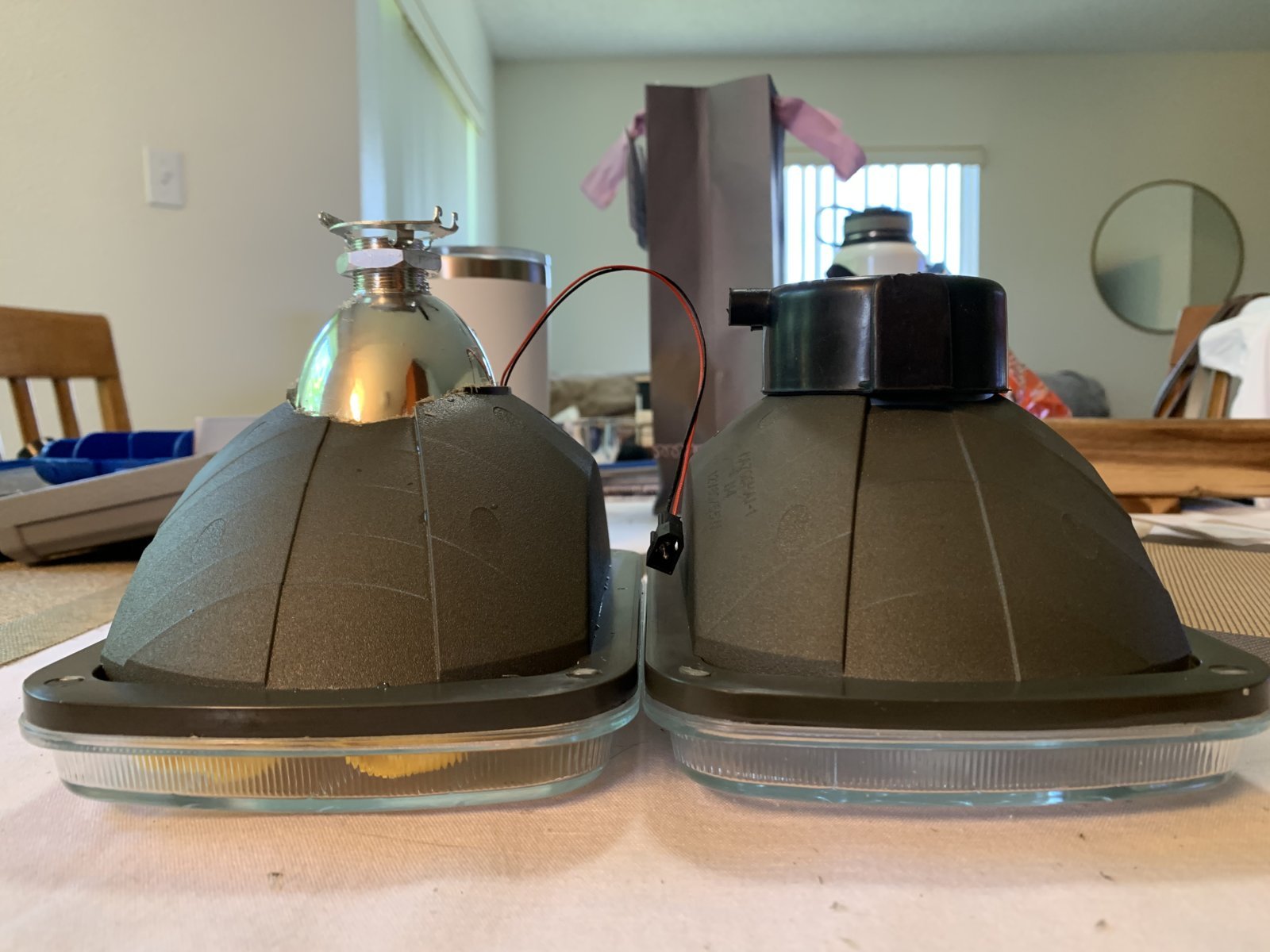

    I used a cheap retrofit projector kit from Amazon, Nilight brand I believe, that let you plug and play into H4 housings but they were too long. I ended up using a dremel to trim the housing down to fit it then plastic welded them together

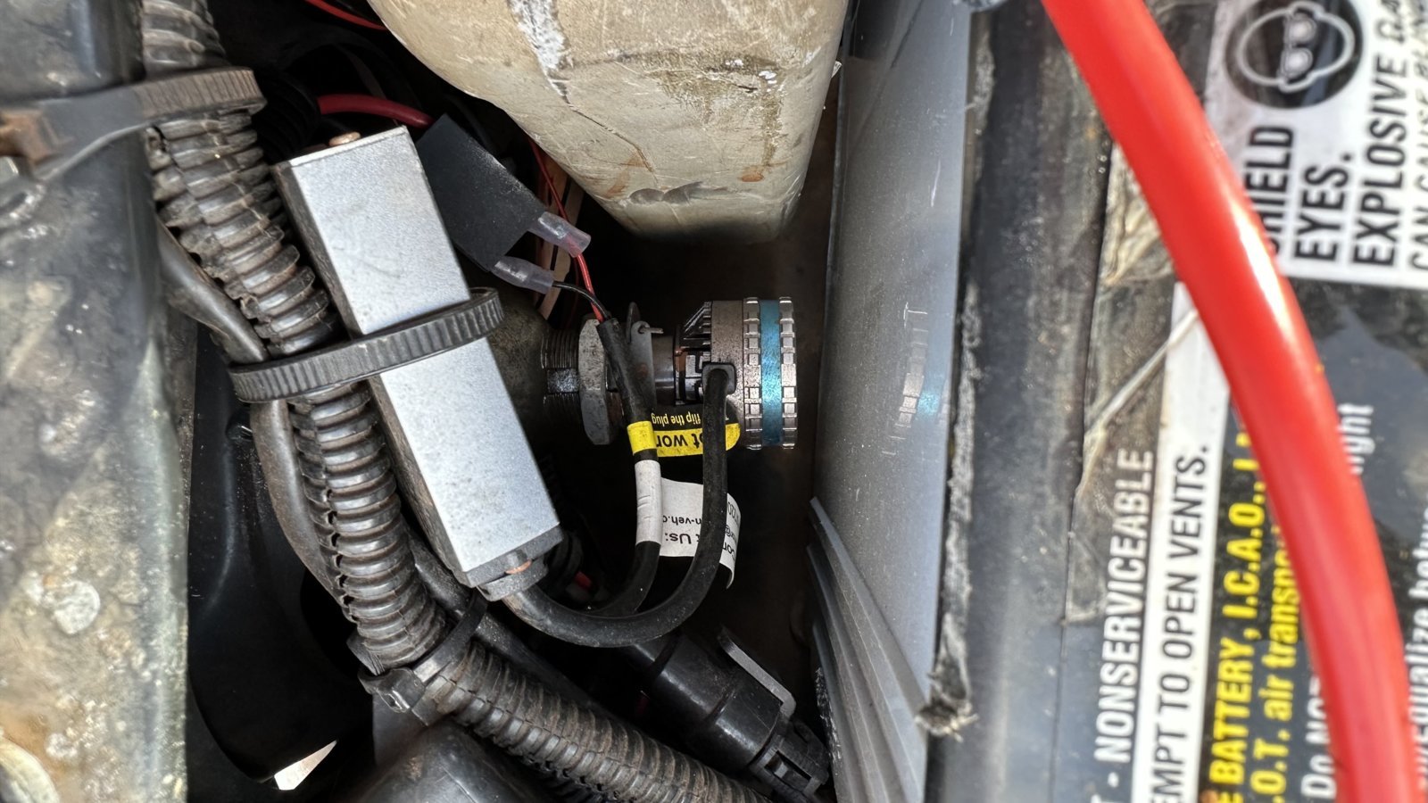

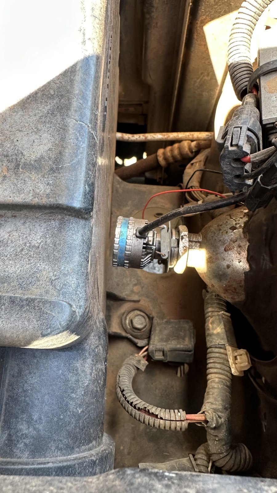

    How close did the back of the projector end up coming to the battery on the driver’s side headlight? Also, did you do anything to weatherproof it?

    Pretty close but just as far as the coolant reservoir tank is as well. Airbox side is pretty similar

    Forget to mention that the projector doesn’t actually get that close but my LEDs have a fan behind them which get close
