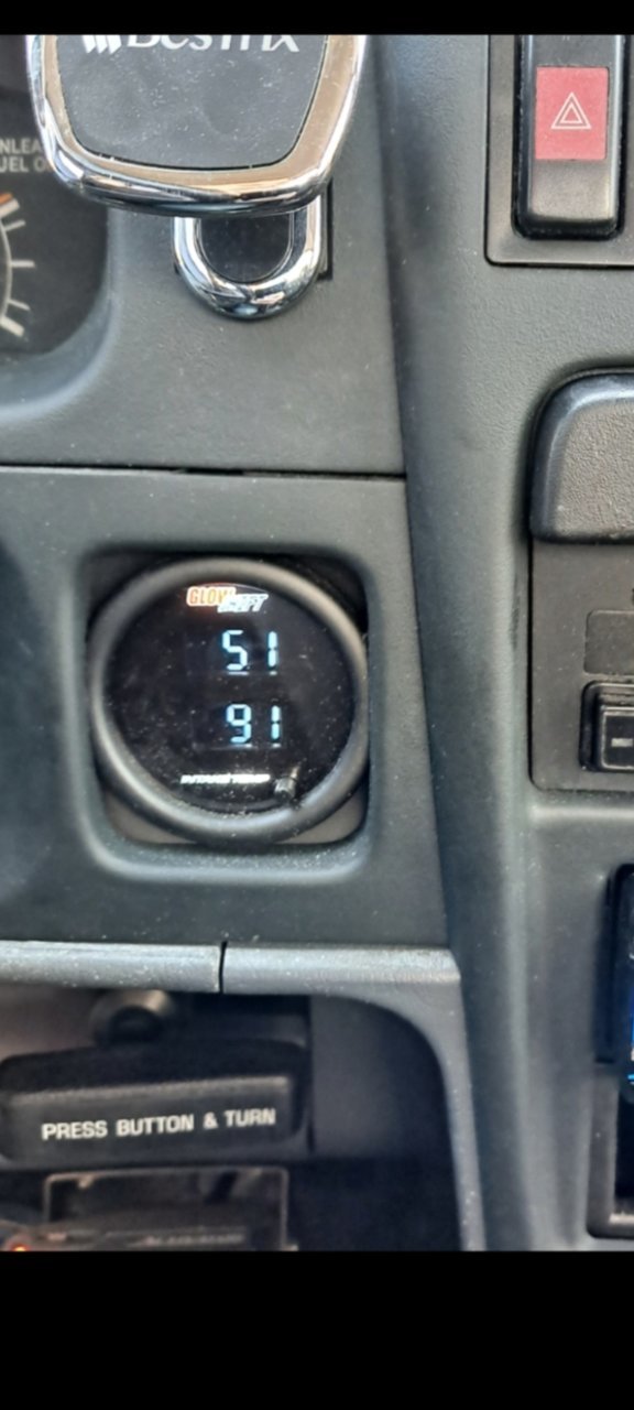

    This is my before and after temps in winter At idle , there is a minimum of 50 degrees or more And summer can be 100 degrees more in boost WITHOUT methonal
