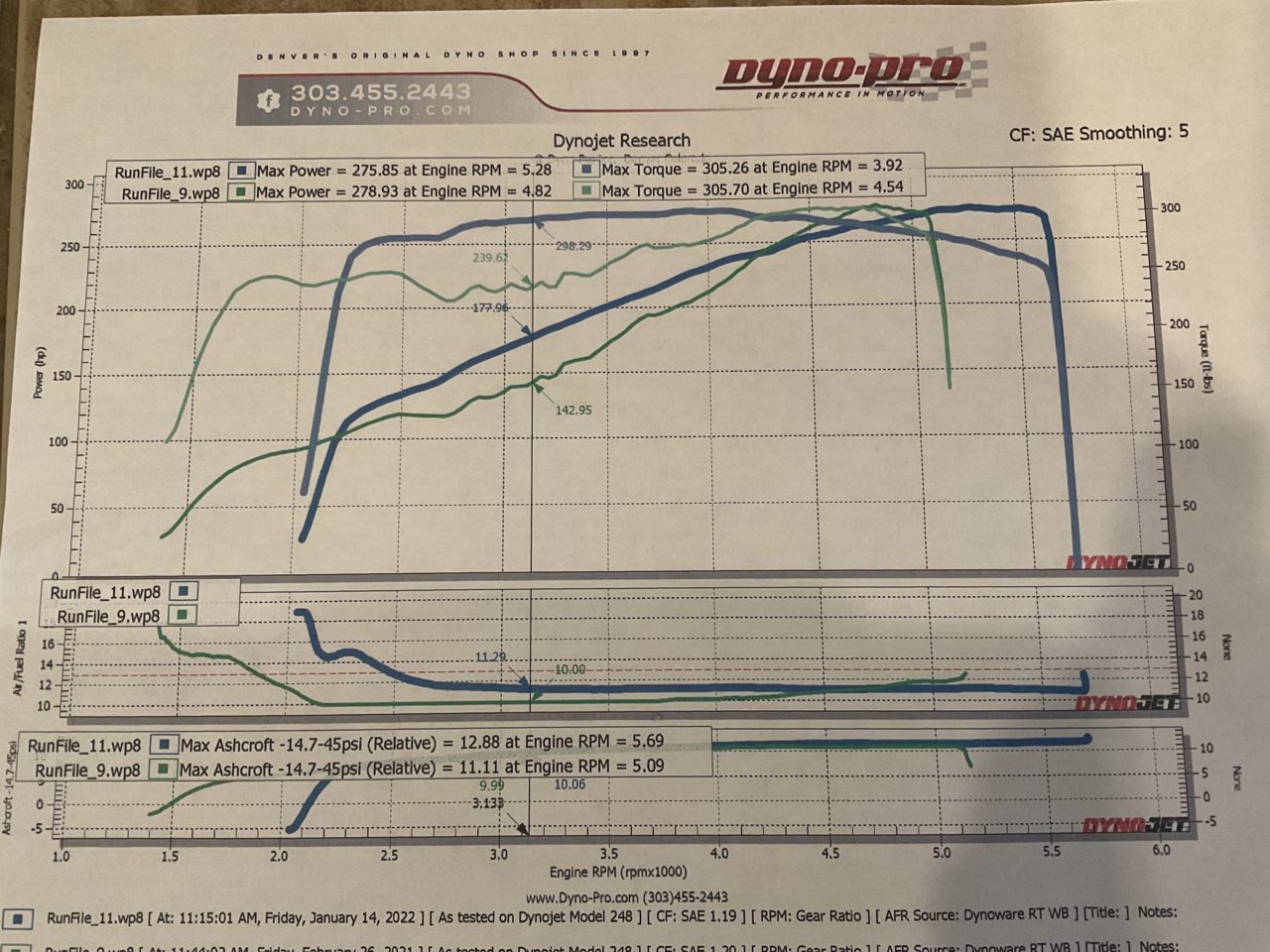

    That's really an impressive useable mid range improvement. I wonder if it is mostly the leaner mixture vs your stock ECU. How much, if any timing was added in those ranges?

    V6 5sp,RegCab,TVS1320 Supercharger, 56mm pulley, methanol injected Haltech ECU, AC Tvs1320 supercharger,(MUST DO) every 125,000- 150,000 needs rebuild Projector headlights HID 5 speed manual Amsoil for all drive train Smaller 56mm custom pulley, (MUST DO) 2004 DESNO fuel injectors, zero ping ping, 2004 side door mirrors Dick Cepek Rims, Michelin tires LTX, ATM Pathfinders Dynopro ATM ( that last 100,000 miles) Now running Dynopro ATM mud and snow tires KN cold air intake Cat back dual exhaust with ss exhaust tip, Raised exhaust tail pipe to 2" below body line Optima*dry cell battery,red top Alpine sirius radio, 200 watt amp, focal is165 split door pod speakers Focal door speakers Subwoffer behind seat Viper alarm, Electric Locks Dark tinted windows, bucket seats corbeau lg1 Tacoma Rubber floor mats TRD fender extenders, Bilstien shocks, King shocks JBA UCA trailer iv hitch, electric brake control, Drilled slotted brakes, High carbon steel (MUST DO) EBS green stuff 7000 series pads(MUST DO) TRD engine oil cap TRD stick shift, Marlin crawl shift kit. Rear sliding window 2002 4Runner functional hood scoop cut into Tacoma hood, 4Runner dual overhead map light Gentex Auto dim + Compass + Temp, garage,rearview mirror Snow Methonal kit stage 2 Custom 3 core aluminum radiator Linex bed liner Haltech stand alone ECU, Intake supercharger gauge. Stainless steel brake lines, Custom leather wrapped steering wheel, Haltech stand-alone ECU,
    It’s a combination of everything, NOT the mixture but mostly in the timing numbers and fuel map.
    Gabe spent a good amount of time finding the sweet spot on BETTER SAFE timing numbers and adjustments.
    The Haltech you have 100 percent control of every part of your tune.
    This power gain is from the haltech tune as every thing else was the same from a year ago

    Wow that HP dip from 2.5-3.5k still... I wonder if it'd be worth it to detune prior to that point so it feels more linear?
    You're also very rich (stock is insanely rich) in the low RPMs, presumably due to no intercooler. I wonder what the alternative would yield. Modern turbo engines can stay in the 12s until about 20 PSI on 91.

    Plans to raise redline to 6 - 6500? Not sure where valve float becomes a legitimate problem.

    No, I’m at 680,000 miles , I want more miles without any engine problems :)

    Probably, that can be cleaned up with fine tuning the tune, it’s a process to get a perfect

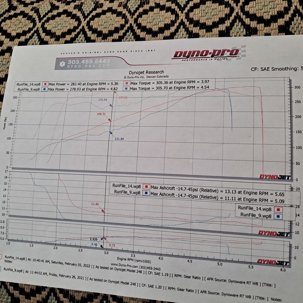

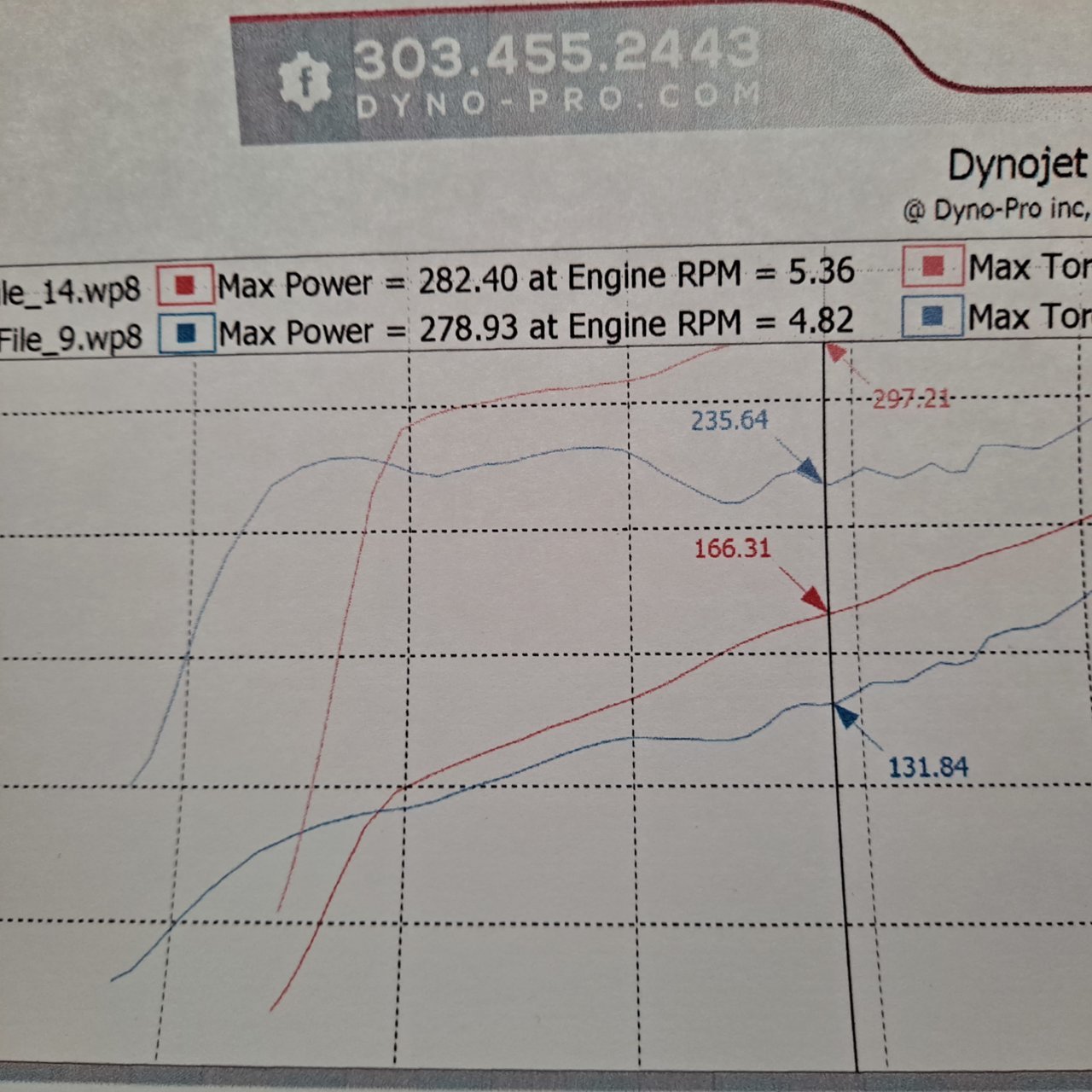

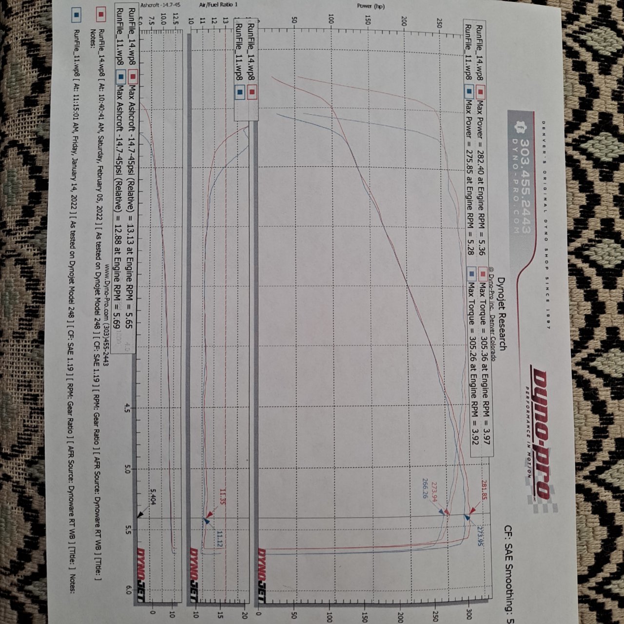

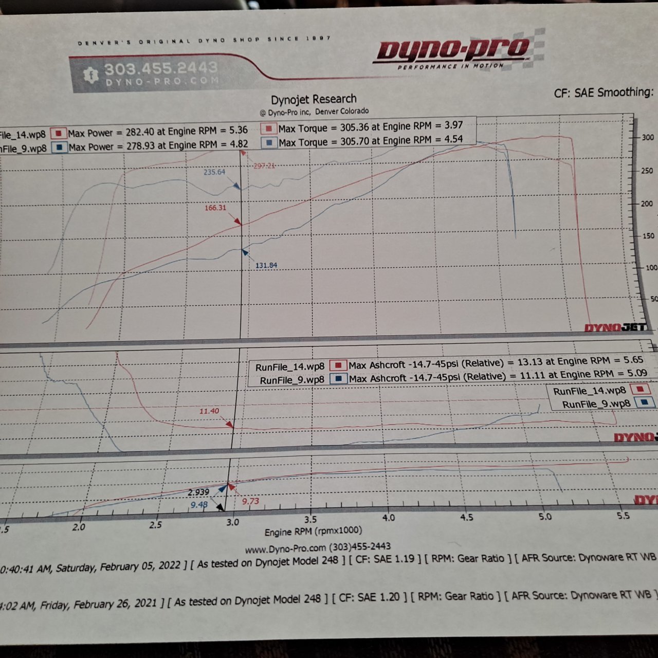

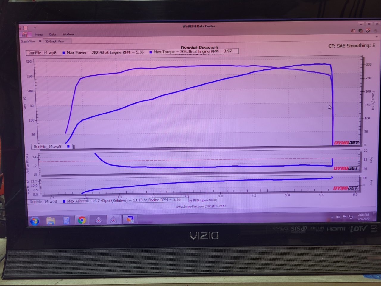

    282hp -305LBS torque
    Got the final tune done yesterday.
    Here's the new haltech dyno over last months dyno and last year's stock ECU dyno.
    The area you mentioned is good now that dipped and max power is 282 up from 275,
    Also picked up 7 -8 torque hp more in the 4krpms to 5600rpms up from the tune last month.
    Total Haltech improvement over the stock ECU with methanol is 62 Lbs and 35hp added to the midrange power curve for me!
    I'm really excited to have such great results just from a tune and nothing else added,
    Haltech is the tune to get the most out of your supercharger.
    Gabe at snpspeed.com knocked it out of the ball park 4 me.
    282hp-305lbs torque without methanol,
    300LBS torque at 3100rpms

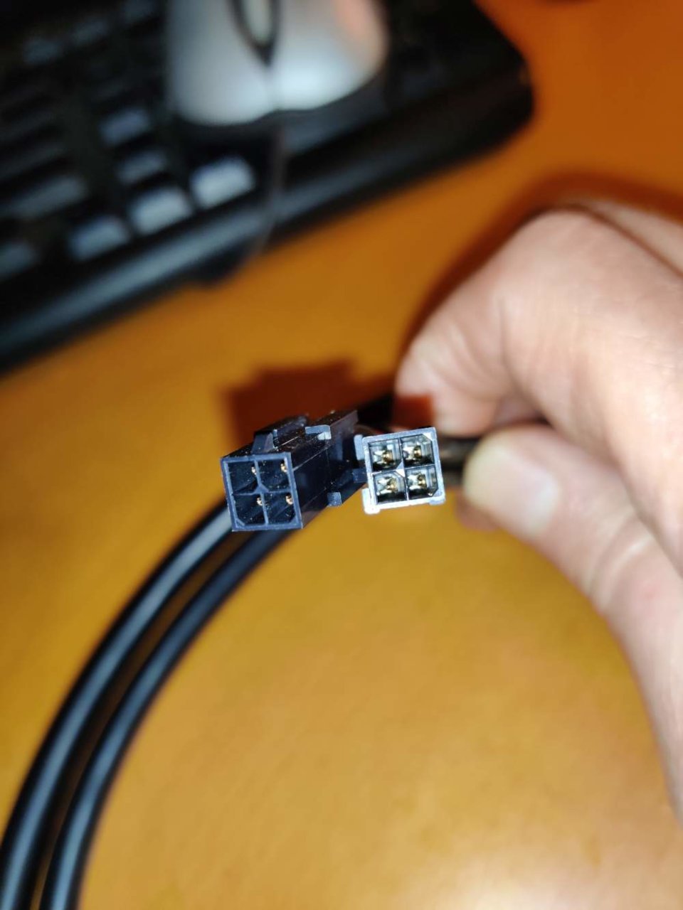

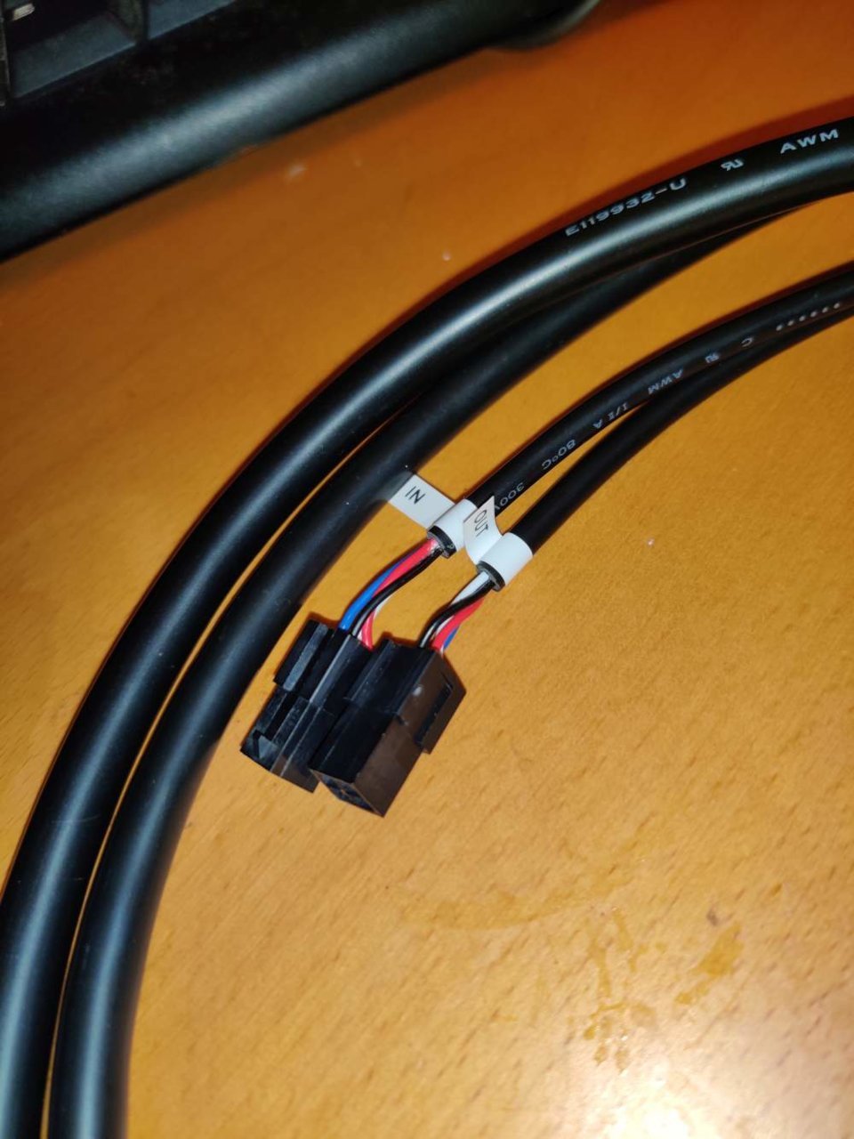

    Hey Haltech fans. Got a question about the Innovate PSB-1 gauge install I am working on. This wideband gauge has 10 connections coming out it's backside. I have a question about the use of two of those connection with the Haltech.
    The two, 4 prong connections are labeled Serial "in" and "out" in the Innovate manual.
    The manual refers to using these with the Innovate LM Programmer Logworks 3 software package.
    My question is, are you using these connections with your Haltech setup. If not, what did you do with them?

    I can answer this from an Innovate perspective. I reached out to them about the serial protocol they used several years ago and they basically told me it was proprietary and would only work with Logworks. Not sure I believe them, but "officially" they don't interface with anything else.
    Would be interested in hearing if anyone's had success otherwise.

    I suspect that I will not need these with the Haltech but I was hoping to be certain of that.
    There is so much stuff coming off the back of the gauge, I was hoping to just lop those off so they don't interfere so much with my A pillar mount.

    I think my SCG-1 has an O2 out separately, at least, and that should interface. But ya there's a buttload of stuff back there that makes it hard to mount.
