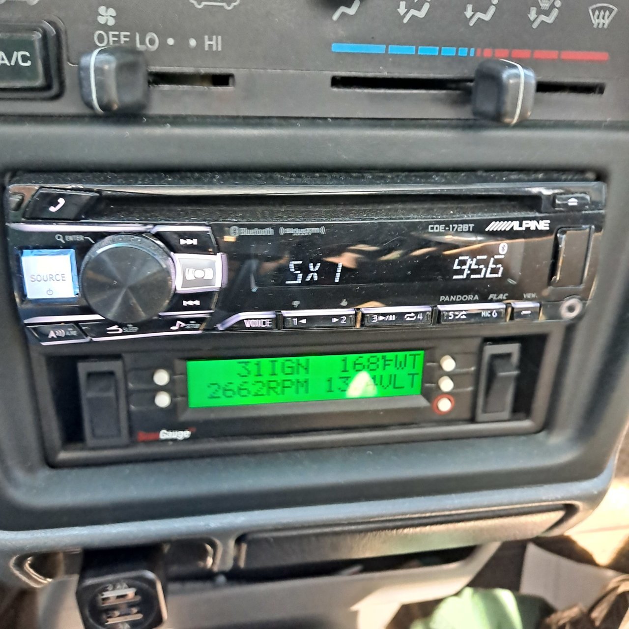

    Did you ever get your scangauge issues sorted out?
    With mine plugged into the truck's OBDII port, some of the parameters I monitored in the past are now inaccurate or the data is gone altogether. The one I miss the most is coolant temp.
    I have the CAN to OBDII adapter cable that came from SNP but when plugged into the Haltech, the SG only reads "connecting..." and never actually connects.

    Yes, Gabe got that all wired up and the scan gauge now is wired into the haltech, not the OBII.
    Coolant temp does work too,
    He might be able to fix that remotely

    :) working

    Is that plugged directly into the haltech?

    Yes, with an OBII adapter for the scan gauge and then is wired into the haltech by Gabe.

    Interesting. By 'wired by gabe" I presume you mean that he had to configure the haltech programming using the software so the adapter cable connection could work with the scangauge.

    Yup,
    I mailed him my scan gauge so it was wired into the haltech and programmed at his shop.
    Then it was plug and play when I installed the haltech with the scan gauge

    That is certainly different from what he told me when I bought my setup.
    He sold me a cable as an add on for $36 that is meant to plug into the scangauge on one end and the other end of the cable is a square type usb that plugs into the haltech. He told me at the time that that was all that was required to make the SC work with the haltech.

    the haltechs support OBD.. he should only needed to input the PIDs in the software and as long as the haltechs wired into the obd2 port it should function

    I don't think this is right. I am almost certain that the Haltech has nothing to do with the OBDII port. And I am certain the OBDII port knows nothing about the haltech because it relies totally on the data stream from the truck's UCU and it knows nothing about the haltech.

    My knowledge on haltech is only known from my buddy with his mr2. But it does indeed support regular OBD assuming it’s wired in and the PIDs are programmed in. It’s one of the advantages of a haltech.

    Yes, that’s the same thing essentially. My front haltech port was being used for the 02 sensor so he wired mine in.
    I added mine after the fact and my setup is not a piggy back but a stand-alone for the 1997 so might be a little different for you if it’s setup as a piggy back for the newer Tacoma

    With the cable I got, my SC does not complete the connecting process so it is definitely not plug and play

    The haltech is essentially a computer that can can be modified, programmed any number of different ways for each setup depending.
    Just call him and setup a time to get it modified if it’s not working, might be something very simple for him to do.
