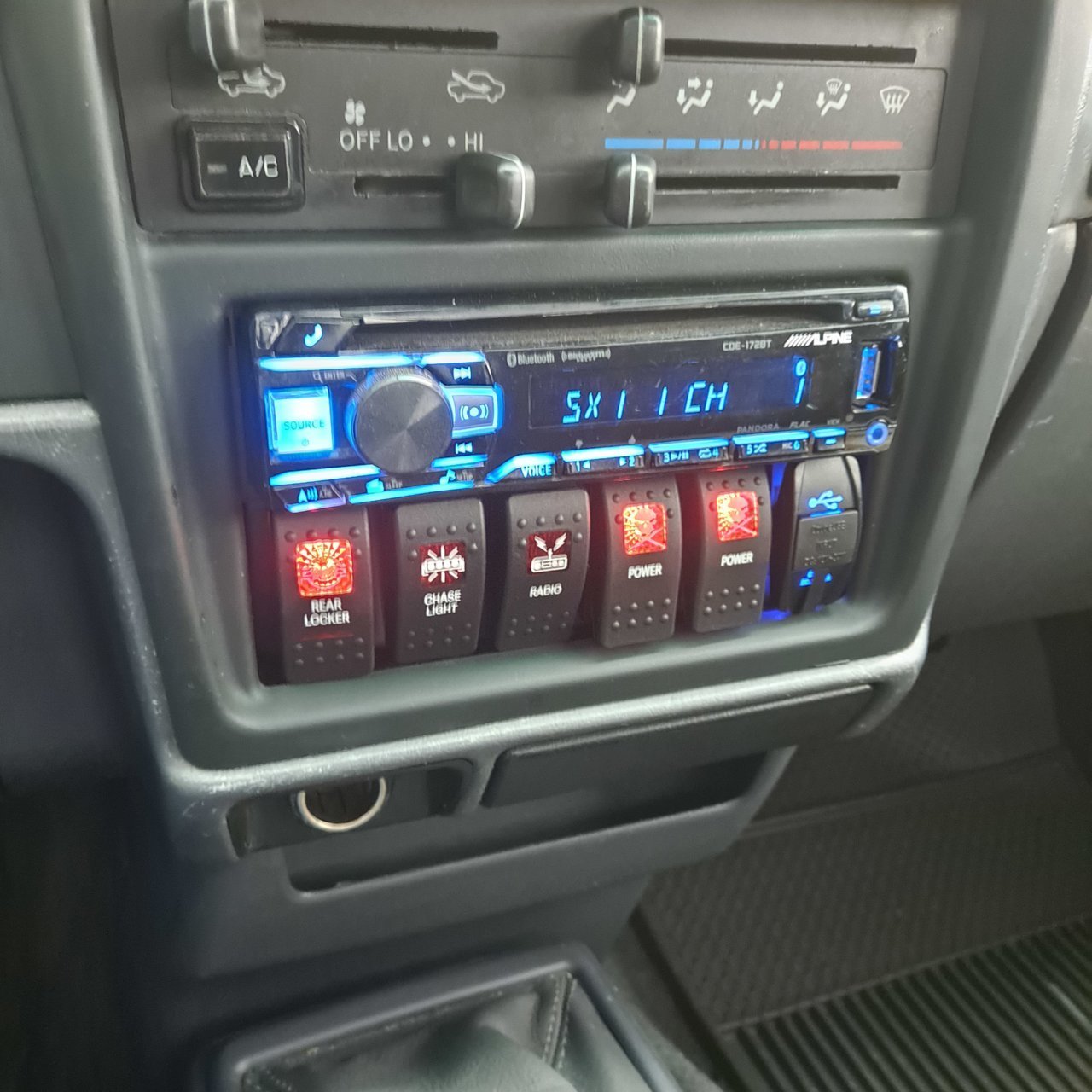

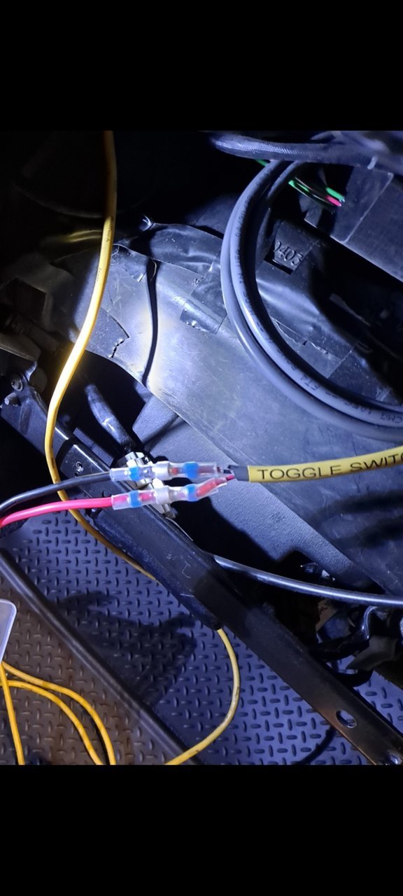

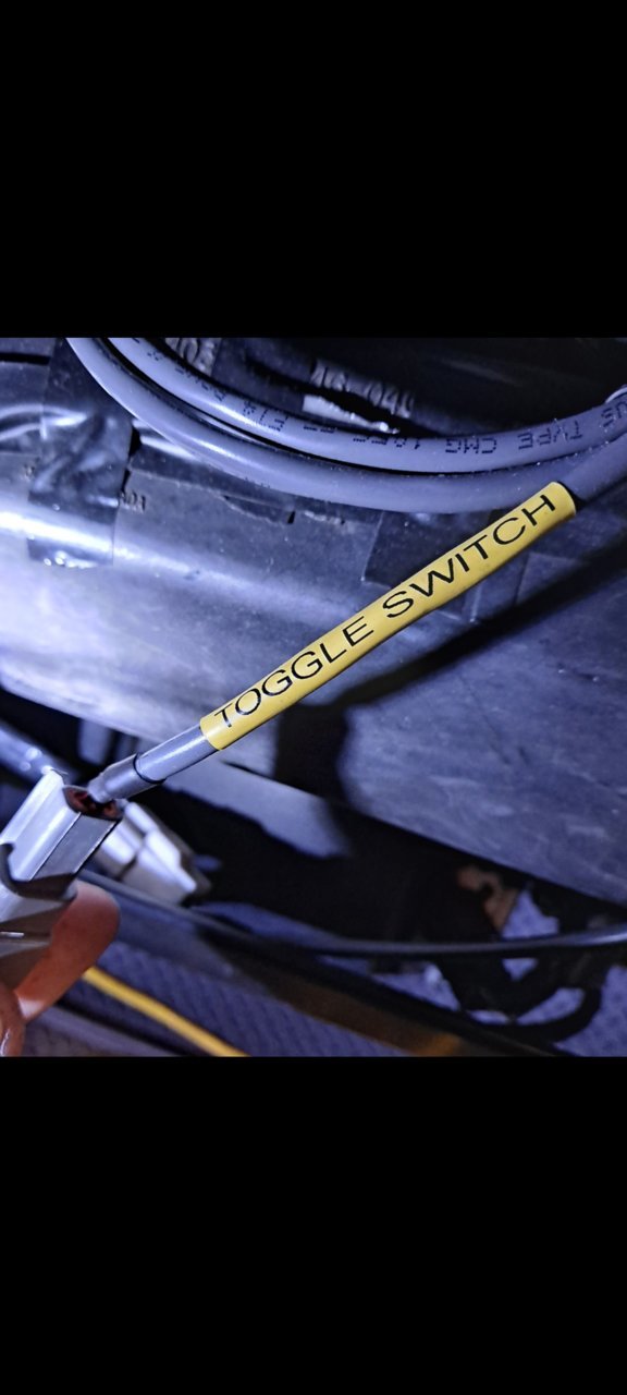

    wired in a methanol toggle switch into the haltech for the summer heat and now tuned.
    My setup doesn't need larger injectors or methanol for its tune, got lucky.
    I decided to run methanol for the summer heat to cool down the supercharger so with the toggle switch it goes into another tune mood for the methonal to spray
    Updated switch’s

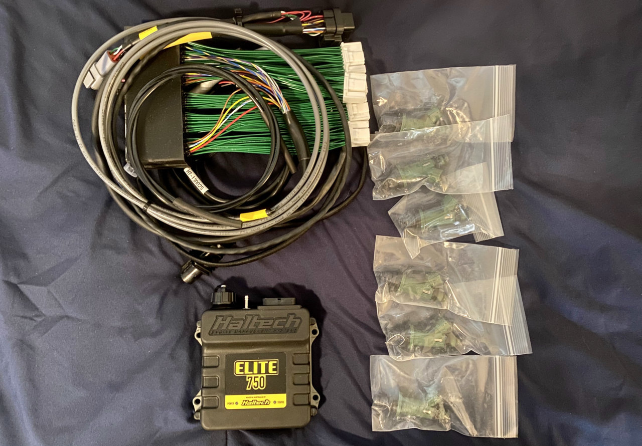

    Ordered a 750, Wideband controller, and boomslang for my build and I have some 850cc injectors.

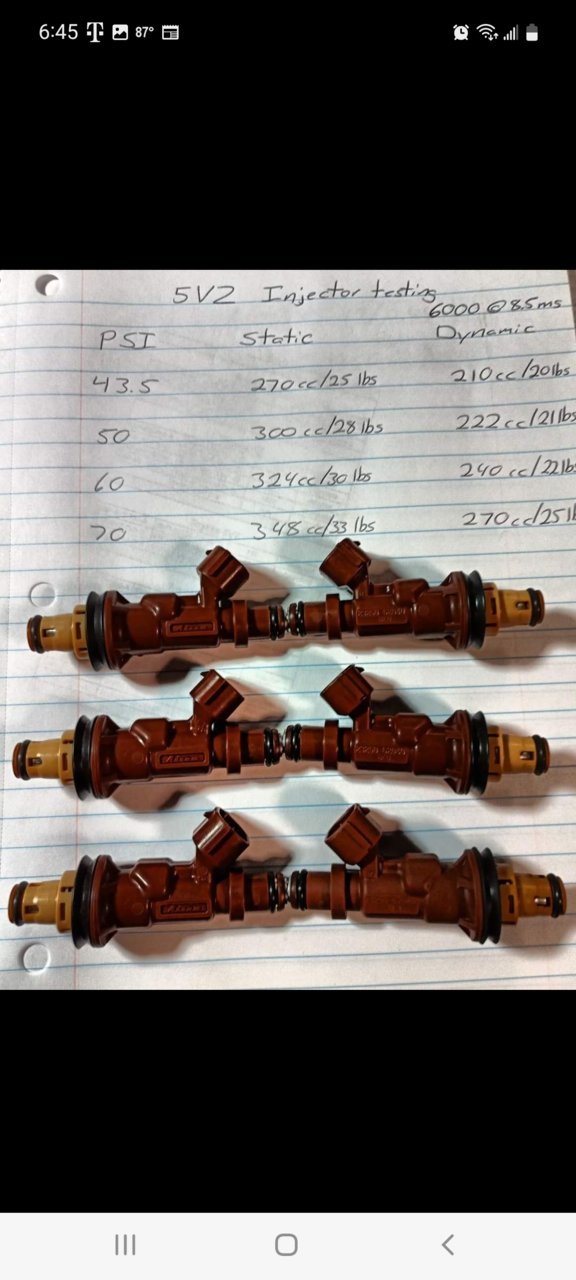

    Gabe did a flow test on the OEM injectors and shows an FMU will work just fine. I might try getting the vortech 3:1 FMU because
    the trd FMU I’m using is a bit inconsistent with my AFR 10.5-11.3 which is very doable and I’m able to run stock injectors.

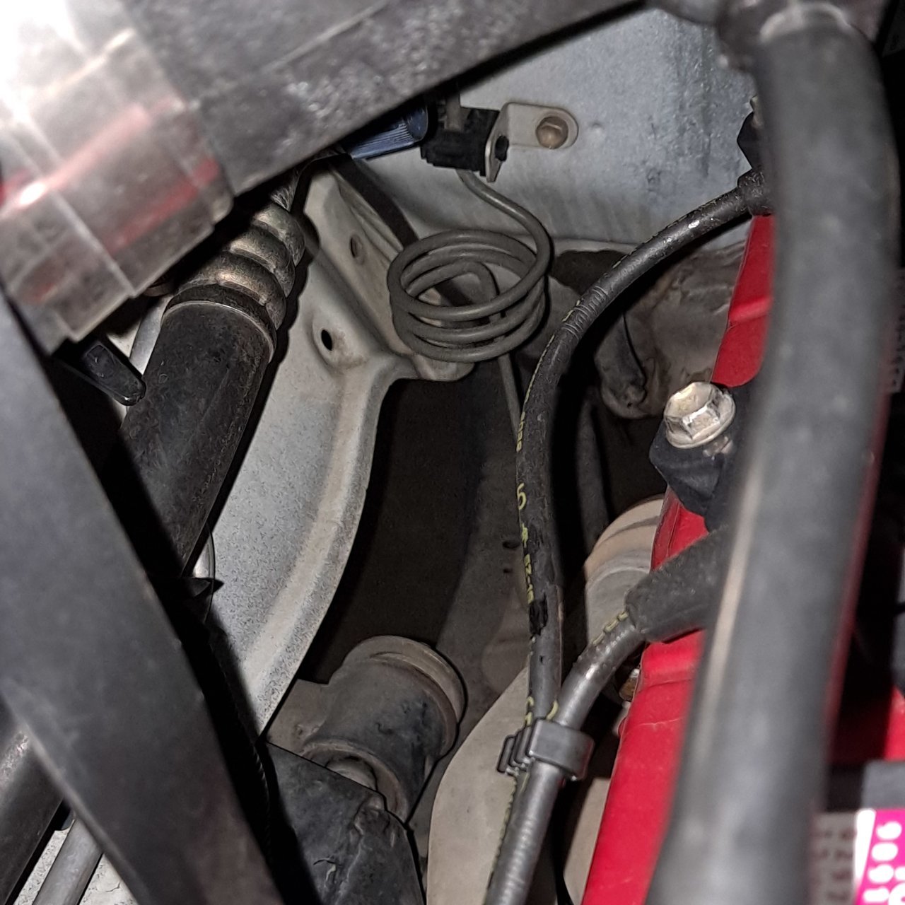

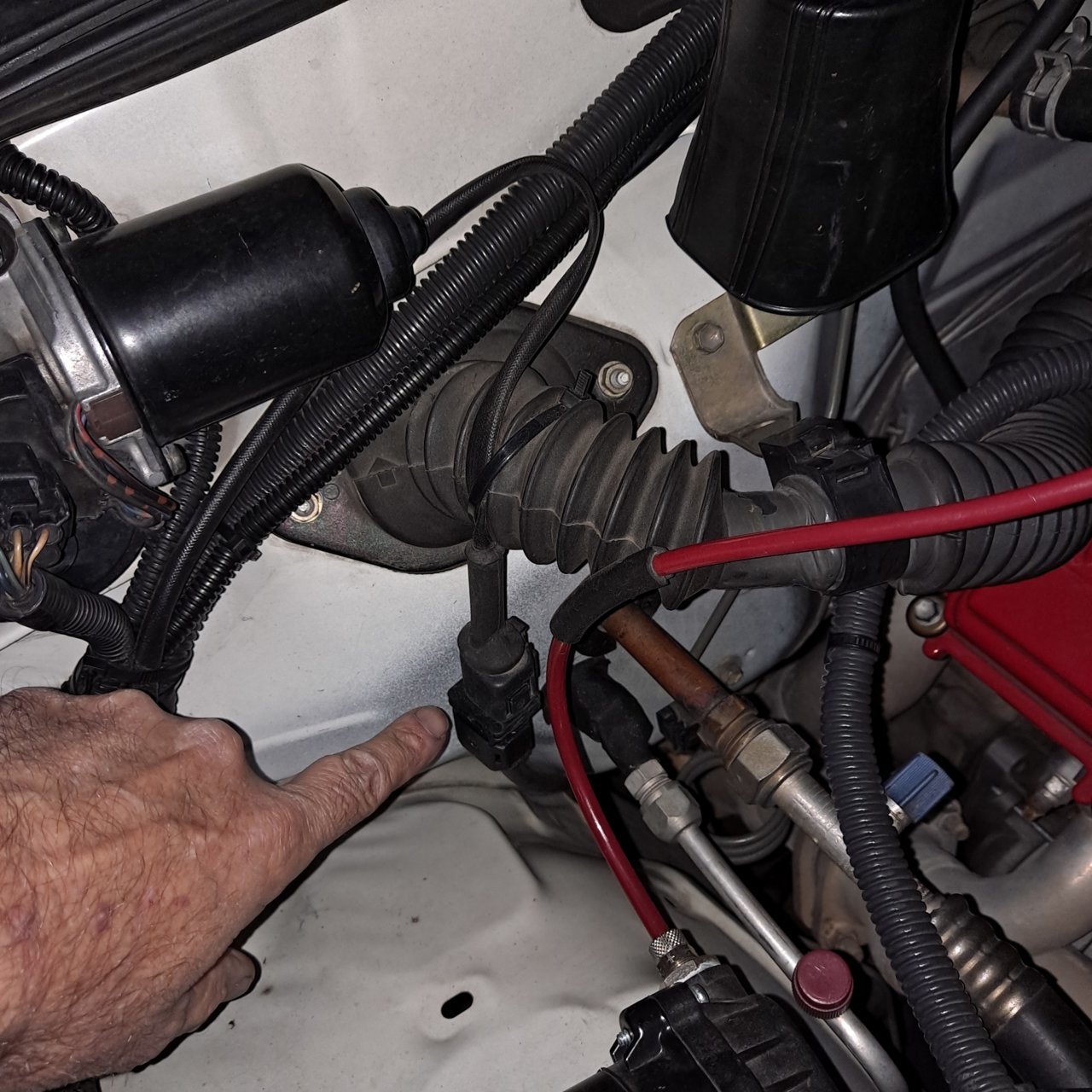

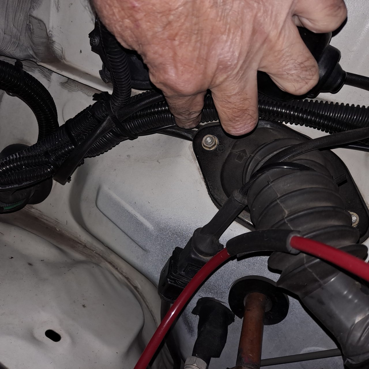

    To those of you running the Haltech, how did you run your 02 sensor wires into the cab? The connector appears to be too large to pull through the wiring grommets.
    1997tacomav6[OP] likes this.
  20. Sep 23, 2022 at 8:25 PM
    #300
    1997tacomav6
    1997tacomav6 [OP] V6 5sp,RegCab,TVS1320 Supercharger,Haltech, 800k
    Oct 5, 2013
    #113940
    10,386
    John
    Denver
    97 reg cab, v6 5sp 300hp supercharged, Methonal Injection, 800,001 plus miles, Original Owner
    V6 5sp,RegCab,TVS1320 Supercharger, 56mm pulley, methanol injected Haltech ECU, AC Tvs1320 supercharger,(MUST DO) every 125,000- 150,000 needs rebuild Projector headlights HID 5 speed manual Amsoil for all drive train Smaller 56mm custom pulley, (MUST DO) 2004 DESNO fuel injectors, zero ping ping, 2004 side door mirrors Dick Cepek Rims, Michelin tires LTX, ATM Pathfinders Dynopro ATM ( that last 100,000 miles) Now running Dynopro ATM mud and snow tires KN cold air intake Cat back dual exhaust with ss exhaust tip, Raised exhaust tail pipe to 2" below body line Optima*dry cell battery,red top Alpine sirius radio, 200 watt amp, focal is165 split door pod speakers Focal door speakers Subwoffer behind seat Viper alarm, Electric Locks Dark tinted windows, bucket seats corbeau lg1 Tacoma Rubber floor mats TRD fender extenders, Bilstien shocks, King shocks JBA UCA trailer iv hitch, electric brake control, Drilled slotted brakes, High carbon steel (MUST DO) EBS green stuff 7000 series pads(MUST DO) TRD engine oil cap TRD stick shift, Marlin crawl shift kit. Rear sliding window 2002 4Runner functional hood scoop cut into Tacoma hood, 4Runner dual overhead map light Gentex Auto dim + Compass + Temp, garage,rearview mirror Snow Methonal kit stage 2 Custom 3 core aluminum radiator Linex bed liner Haltech stand alone ECU, Intake supercharger gauge. Stainless steel brake lines, Custom leather wrapped steering wheel, Haltech stand-alone ECU,
    I ran the wire up the firewall, I pulled the rubber boot off and ran the wires here
    austinmtb[QUOTED] likes this.
