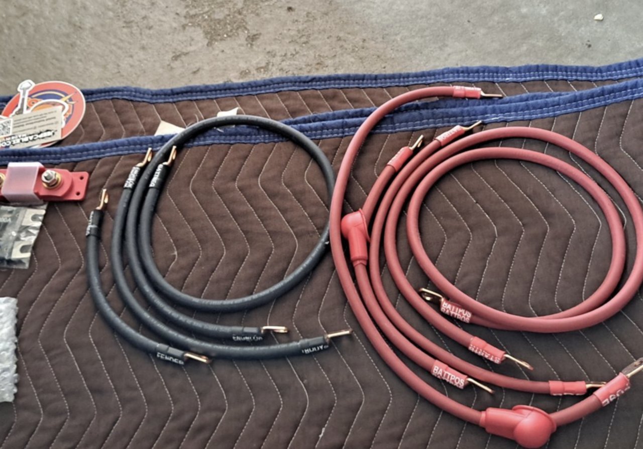

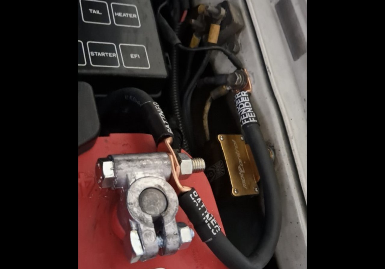

    If your having trigger issues,
    I highly recommend that you replace the stock neg ground wires with 2 or 4 gauge.
    Firewall ground wire to engine passenger head side,
    Neg Battery to fender,
    Neg Battery to engine,
    Engine neg to then go to the frame.
    the haltech is super picky needing as much voltage as possible and uses more than the stock ECU

    Did the big 3 awhile ago so that’s already done, thanks for letting me know though!
