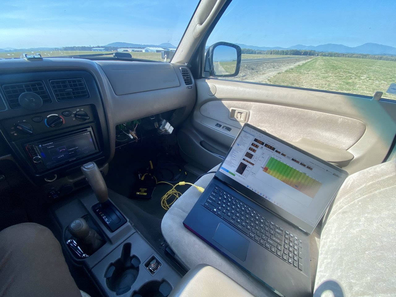

    Went out and did some WOT pulls today. Shifted around 5000 rpm every time.

    Also unfortunately starting to find issues with my tune. After slowing down for something and then getting back on the gas the truck sometimes stumbles and really struggles to climb back through the rpm range even with very little throttle input. It only ever happens right after I get back on the gas from a decel and the issue can drag out for 10-20 seconds until the ECU corrects the issue. Kinda odd...

    Any haltech errors triggered? Almost sounds like the spark plugs are loading up/fouling.

    I’m not sure, do I need to connect my laptop to the Haltech to check that?

    Yes. And ignition in the ON position. The truck can be started and running too if you want.
    My Haltech came with a yellow USB A to USB B cable that I use to connect to the laptop.

    Awesome thank you! I actually didn't know the Haltech kept track of errors. I'll check it out in the AM.
