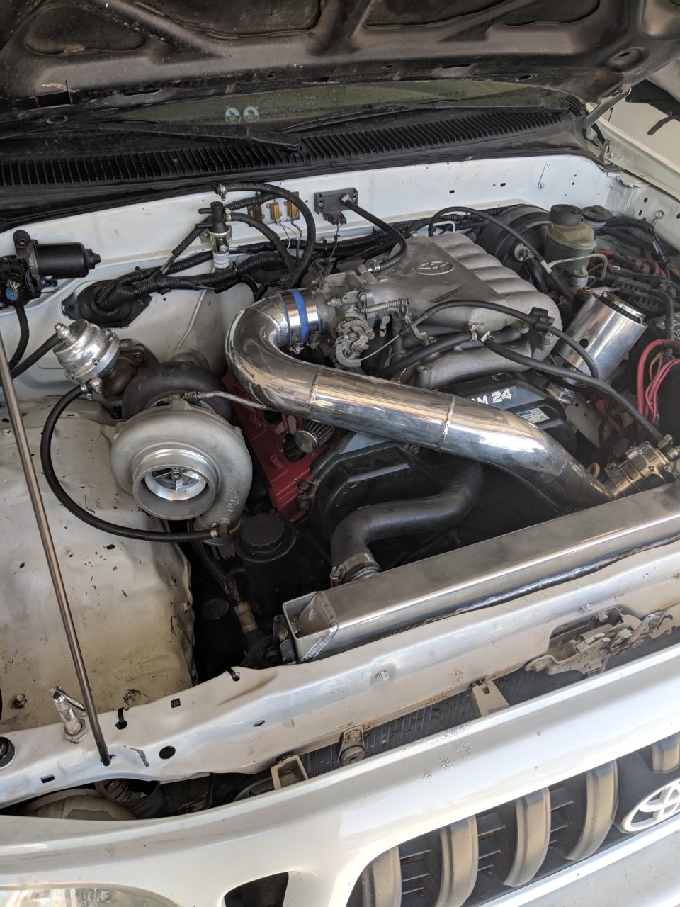

    We'll know in a few weeks. Started pulling my engine bay apart to yank the engine out, I've been running the Haltech NA haha. I decided I don't want to try to wrestle the crossover pipe and drill/weld the -12AN bung to the oil pan while in the truck. Might as well make it all easy and yank the engine and do the clutch while I'm at it.

    Yeah lifting the cab is harder I think but it's certainly a way to do it if you don't wanna pull the engine. I'm not using a CX kit so i don't know what all is included in those. But I have a 95-97 front end so the space behind the grille is super limited, I decided to go with a water to air intercooler setup instead of snaking tons of 2.5" piping all over.
    Gonna be hard enough fitting it all...
    Already gonna be 10lbs of shit in a 5lb bag according to the mockup engine and bay pics.

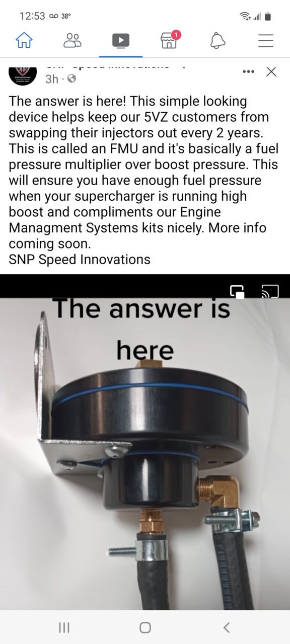

    V6 5sp,RegCab,TVS1320 Supercharger, 56mm pulley, methanol injected Haltech ECU, AC Tvs1320 supercharger,(MUST DO) every 125,000- 150,000 needs rebuild Projector headlights HID 5 speed manual Amsoil for all drive train Smaller 56mm custom pulley, (MUST DO) 2004 DESNO fuel injectors, zero ping ping, 2004 side door mirrors Dick Cepek Rims, Michelin tires LTX, ATM Pathfinders Dynopro ATM ( that last 100,000 miles) Now running Dynopro ATM mud and snow tires KN cold air intake Cat back dual exhaust with ss exhaust tip, Raised exhaust tail pipe to 2" below body line Optima*dry cell battery,red top Alpine sirius radio, 200 watt amp, focal is165 split door pod speakers Focal door speakers Subwoffer behind seat Viper alarm, Electric Locks Dark tinted windows, bucket seats corbeau lg1 Tacoma Rubber floor mats TRD fender extenders, Bilstien shocks, King shocks JBA UCA trailer iv hitch, electric brake control, Drilled slotted brakes, High carbon steel (MUST DO) EBS green stuff 7000 series pads(MUST DO) TRD engine oil cap TRD stick shift, Marlin crawl shift kit. Rear sliding window 2002 4Runner functional hood scoop cut into Tacoma hood, 4Runner dual overhead map light Gentex Auto dim + Compass + Temp, garage,rearview mirror Snow Methonal kit stage 2 Custom 3 core aluminum radiator Linex bed liner Haltech stand alone ECU, Intake supercharger gauge. Stainless steel brake lines, Custom leather wrapped steering wheel, Haltech stand-alone ECU,

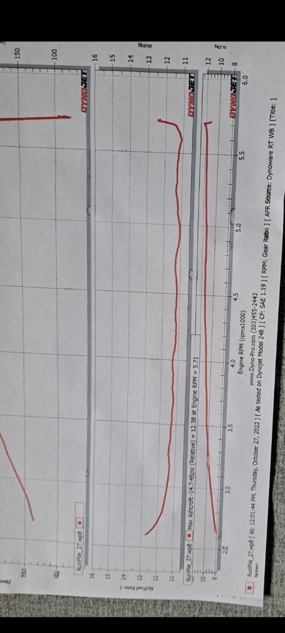

    An FMU ia now available if you want to keep your stock injectors with an AEM 340 fuel pump with haltech
    AFR are perfect with thus FMU at 6000 feet for me
