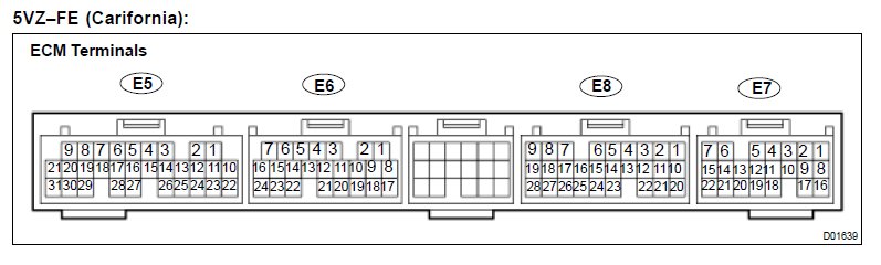

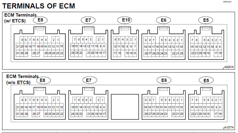

    Has anyone seen somewhere where you can buy the female ECU connector array, so I can make my own PnP harness?
    I've found the male connectors, but not the female, without desoldering a used ECU or something.
  8. Nov 21, 2022 at 5:12 PM

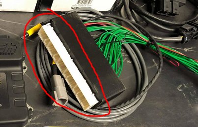

    I bought one from Tuning Technology to make my pnp harness but they are now out of stock. Here is another that comes with a board attached and includes a 3d printed housing https://speedyefi.com/product/denso-76-breakout-board/

    Ah, I remember seeing that one now, thanks! Guess the problem was I didn't know what it was called
    DrabT100[QUOTED] likes this.

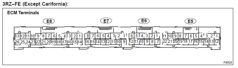

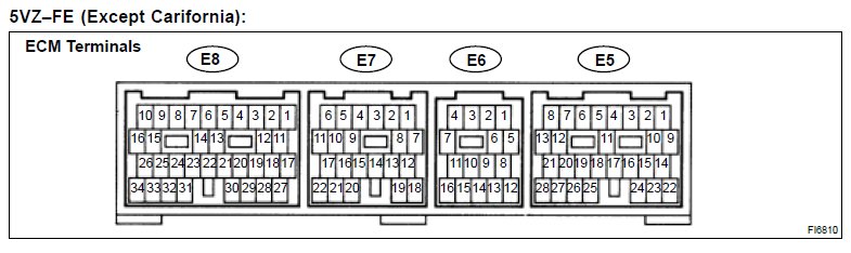

    Wait a min. Isn't that for the 3RZ only? Pretty sure the 5VZ has 3 or 4 rows of pins..also may be that I have an automatic..
    Think I found the 76-pin manufacturer P/N though: https://www.te.com/usa-en/product-178780-3.html
    https://www.te.com/usa-en/product-178780-9.html
    https://www.arrow.com/en/products/178780-3/te-connectivity

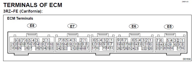

    I did find that one as well in my quest last night...unfortunately that's not correct either. I think that one is for a later Toyota truck actually, since they have curvature and blocks in the wrong places. Edit: I'm going to double check this. I thought I had seen something last night to disqualify it, but now it looks right.
    Here are all the 98-00 headers from my FSM:
    Looks the same as the 01-04 (w/o electronic control) below.
    Copied from above (P/N: 178780-3)(-9 is presumably a newer revision):
    "Think I found the 76-pin manufacturer P/N though: https://www.te.com/usa-en/product-178780-3.html
    https://www.arrow.com/en/products/178780-3/te-connectivity"
    Here's that one from tuningtech from the manufacturer - few bucks cheaper (P/N:1-5178203-6):
    https://www.te.com/usa-en/product-1-5178203-6.html
    Buy: https://www.digikey.com/en/products/detail/1-5178203-6/A124498-ND/6200248
    https://www.mouser.com/ProductDetail/TE-Connectivity-AMP/1-5178203-6?qs=gt1LBUVyoHmRjCGh1aW1Jw==
    Here are what I have for 03 Taco (presumably 01-04, also 4Rs):
    ETCS is electronic throttle control.
