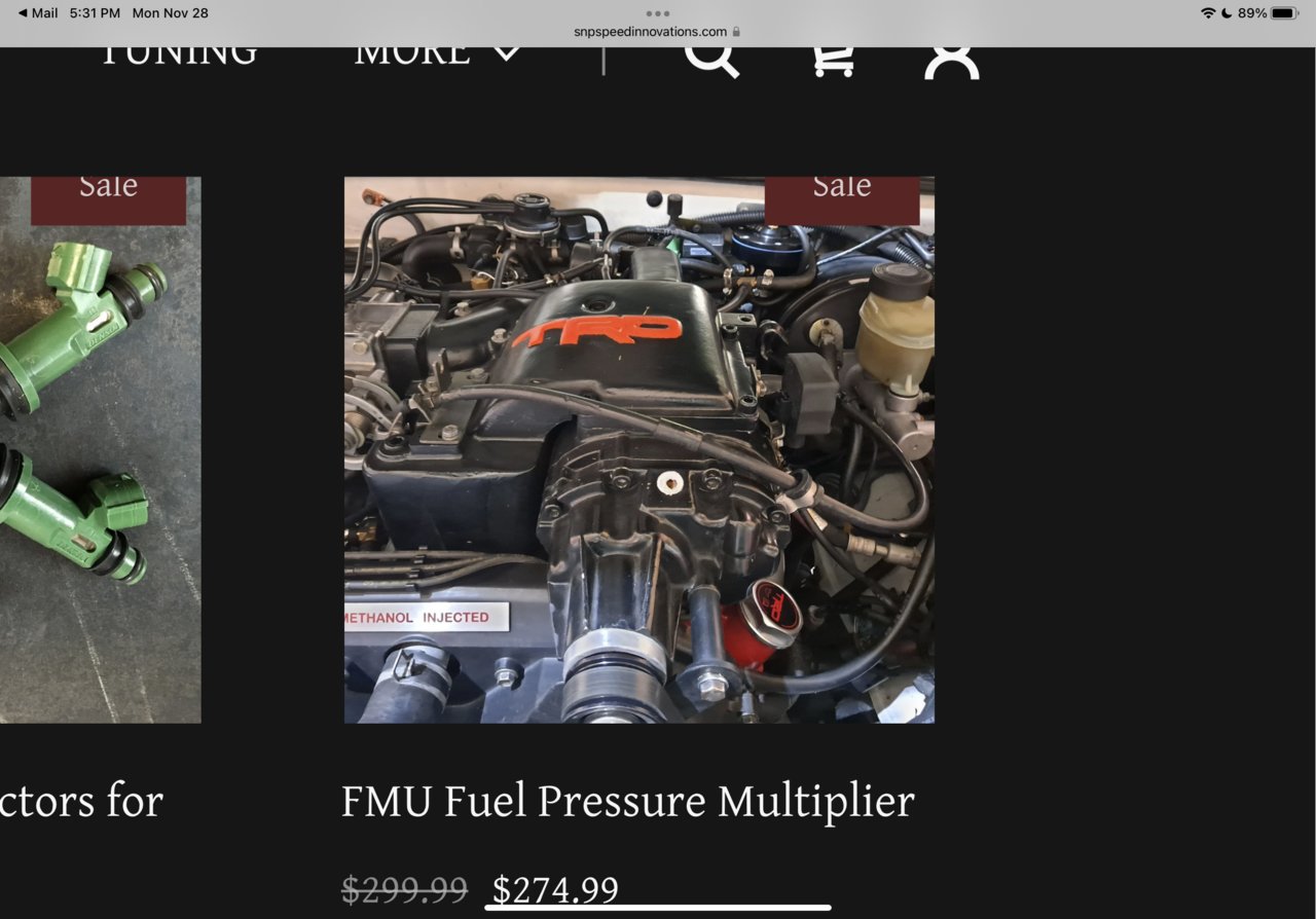

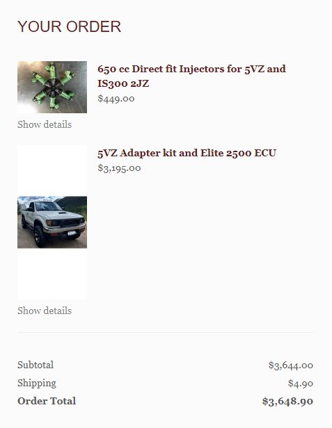

    Black Friday = almost free injectors basically :) (everything 10% off)
