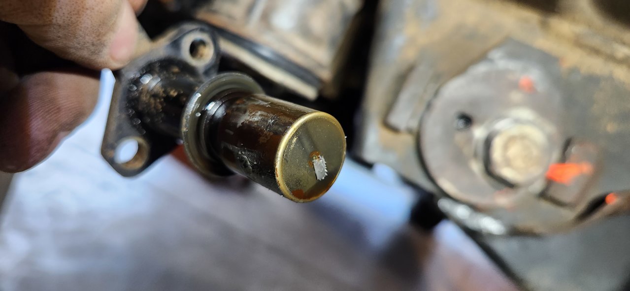

    It's a good idea to change or at least inspect your crank and cam sensors before doing a standalone.
    Both sensors are magnetic so will hold onto any ferrous debris
    This was muffling the signal on my crank sensor
    Signal was dropping out on cam sensor at around 5.6k rpm. Swapped it to a new denso to bring redline up to 6k
    Stick with denso sensors if you can

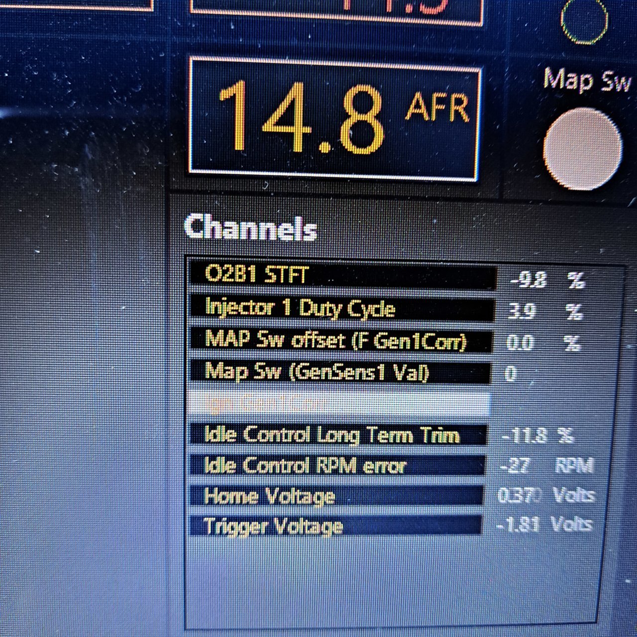

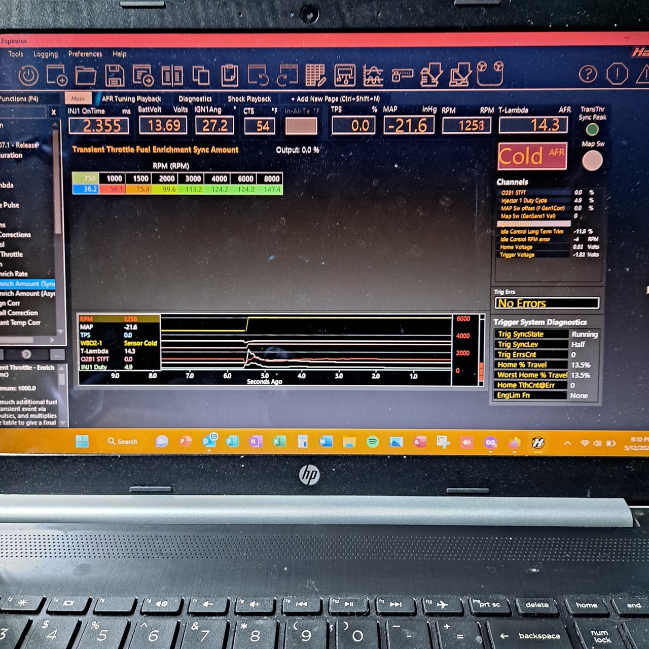

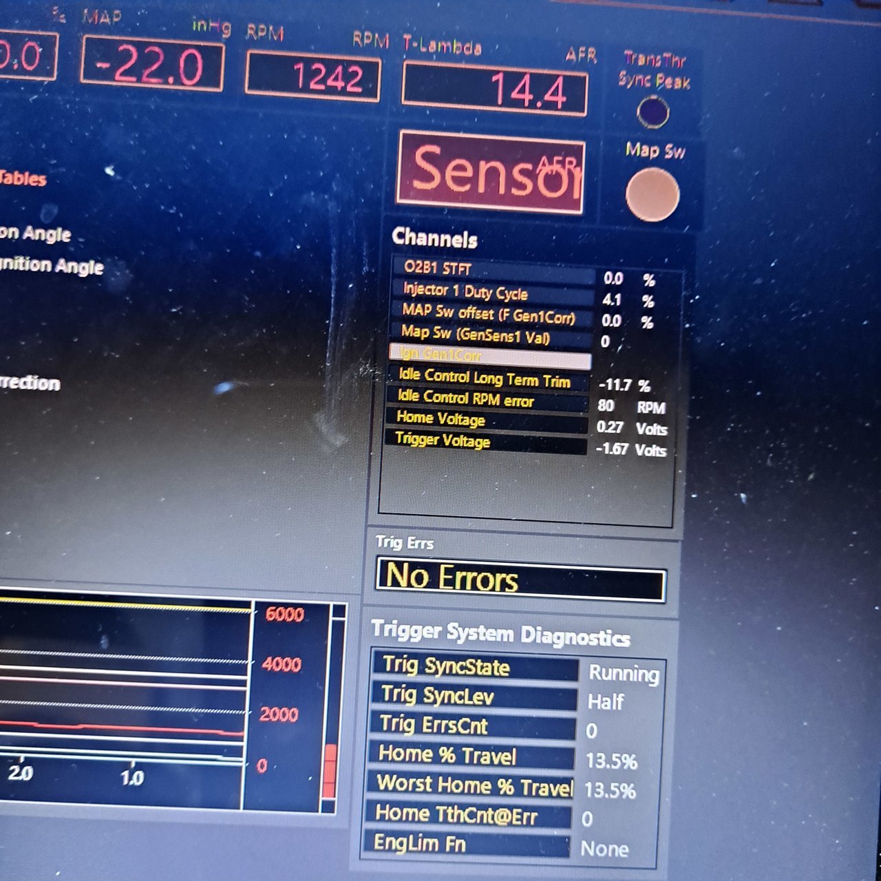

    Here is a new trigger section added with the updated firmware, shows trigger info, voltage crank and cam in real time and on a data log recording

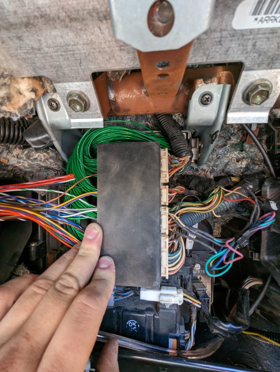

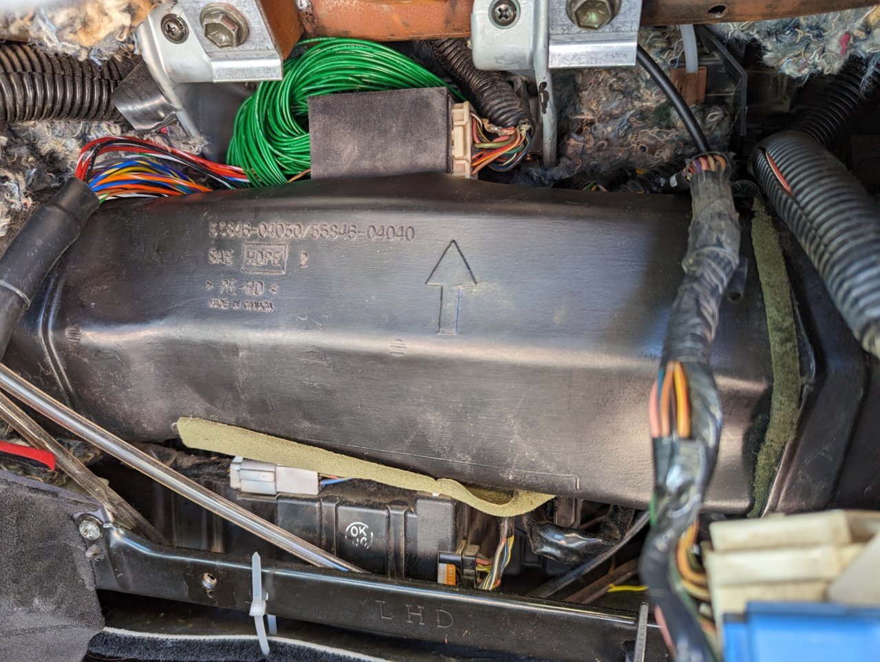

    Idk if anyone else has experienced this or if I'm the only one with an automatic V6 (largest ECU pin set) but there's literally only one spot the PnP harness can go due to the top connector's/harness position above the factory ECU. This means that the duct to the passenger air vent either cannot fit back in or you have to crimp it to get it in, restricting their airflow and probably destroying the duct over time, not to mention the poor seal at the end is now worse.

    I have a 5 speed and no airbag so there’s plenty of space, I know two others 2000 with automatic that were able to but I know it was tight however they did it
