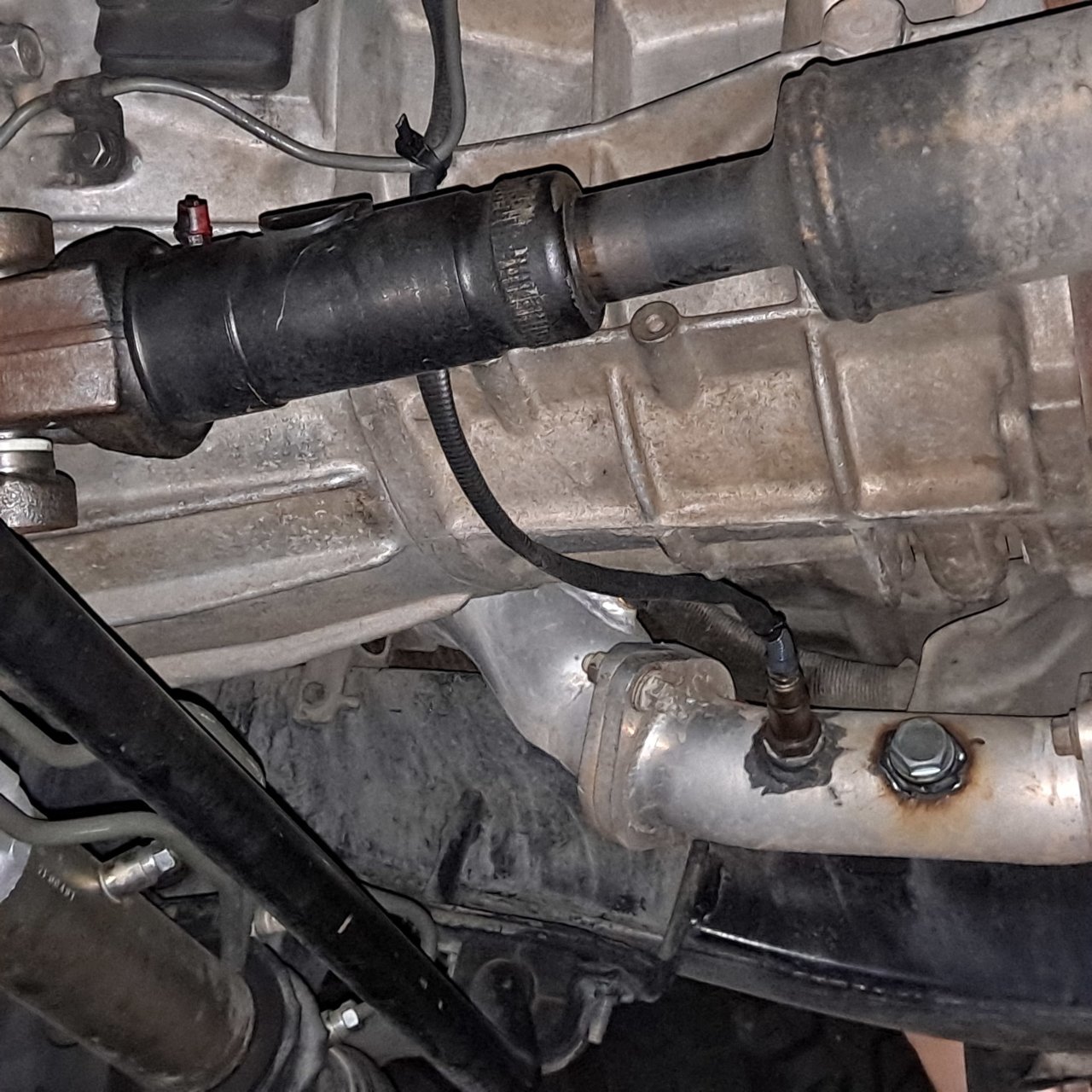

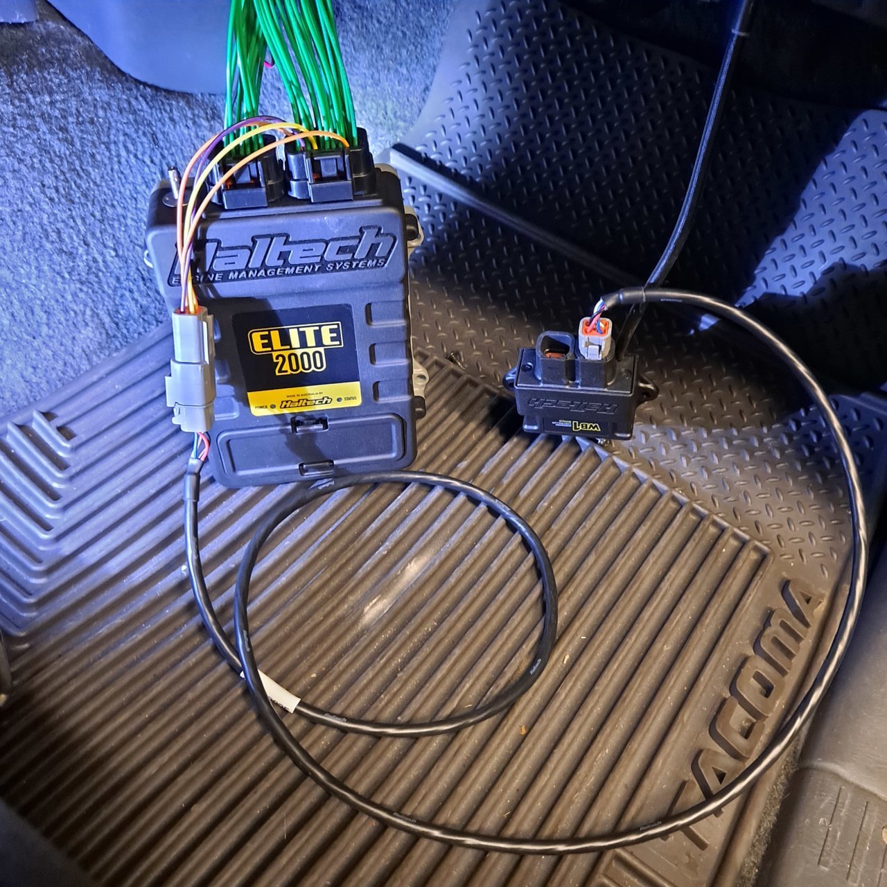

    Got the bung welded in for the haltech 02 sensor, got a plug bolt for it to hold me over till I install it.
    You will need to add this for this installation.
    It wil be installed next to the AFR 02 bung.

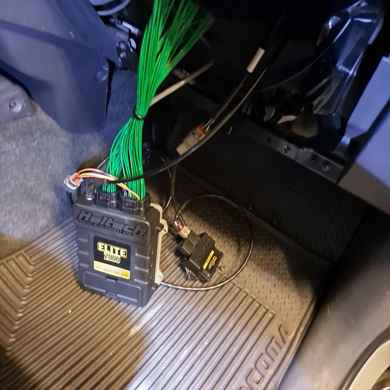

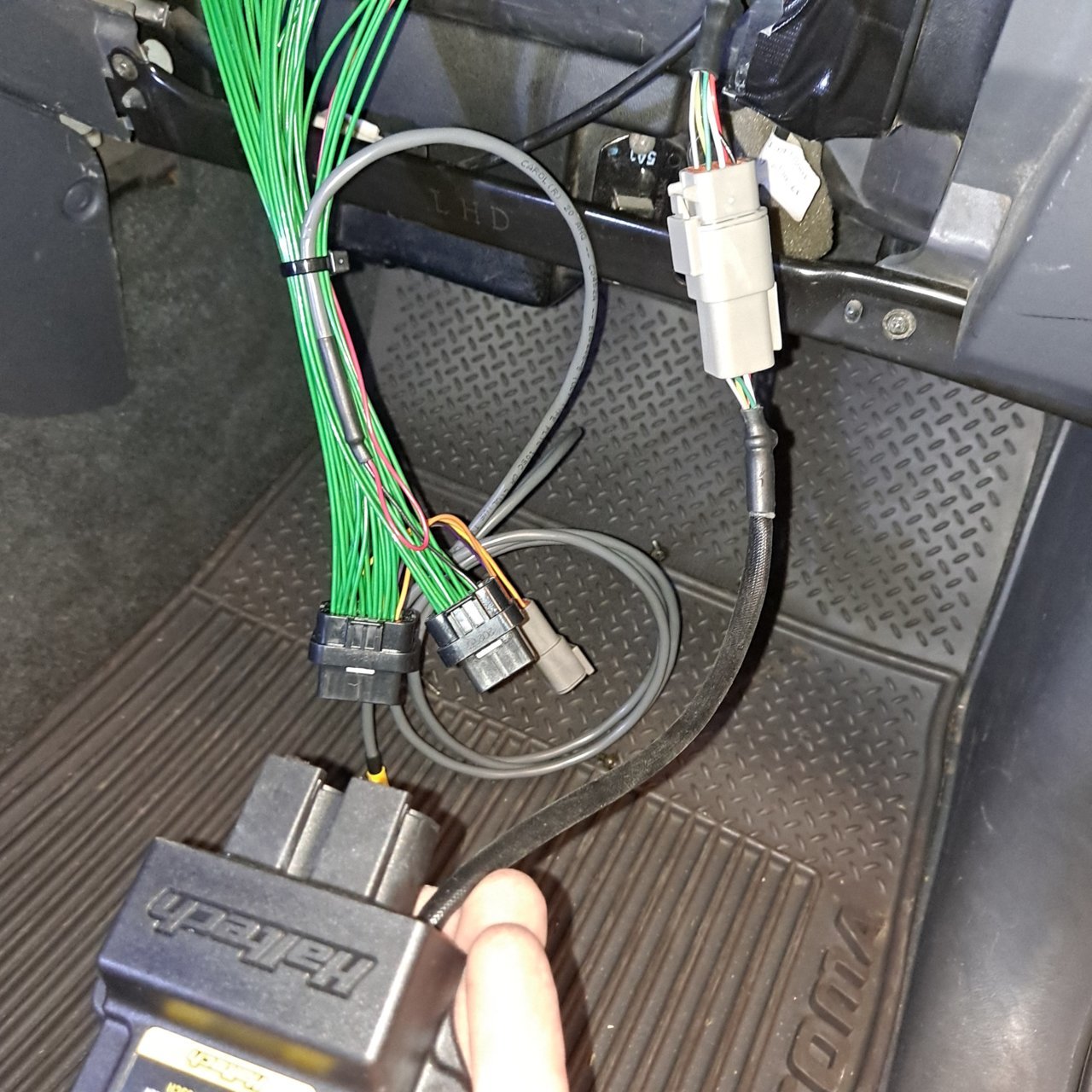

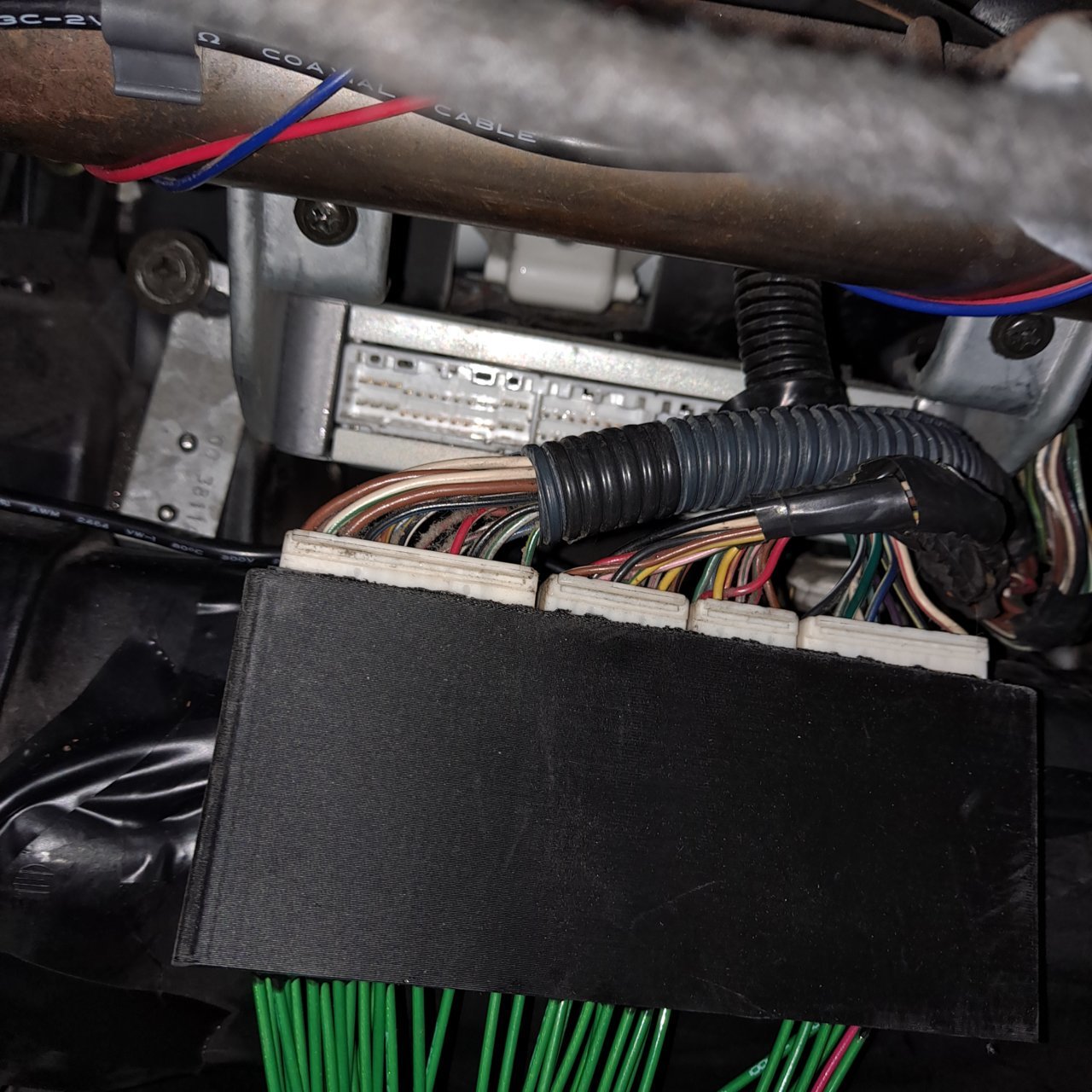

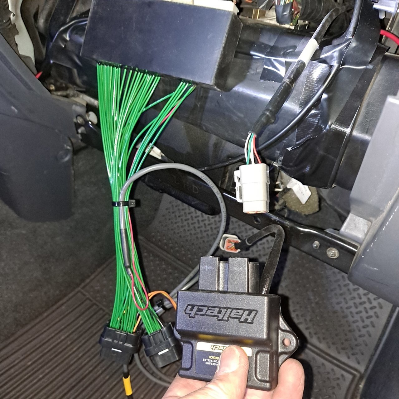

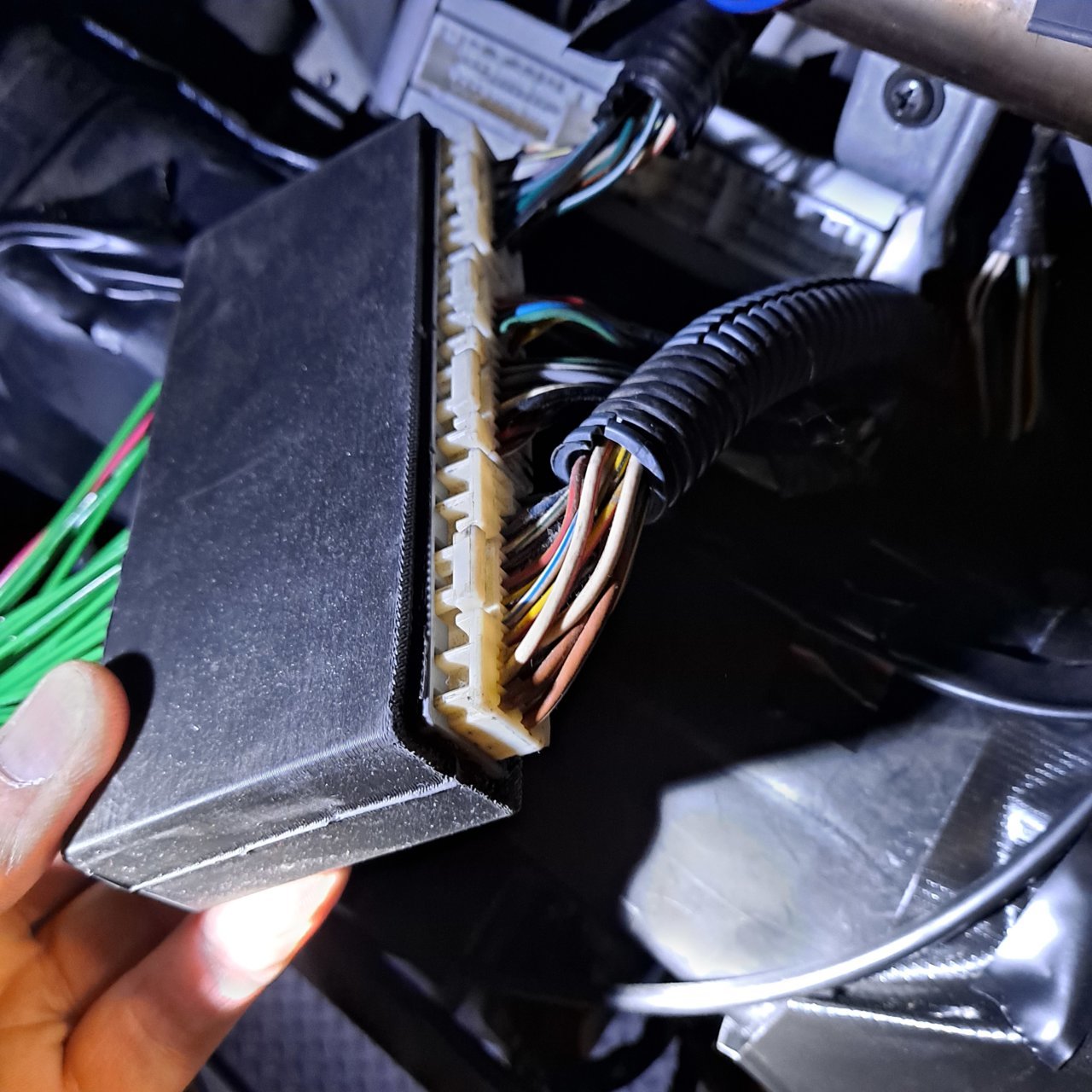

    Took about 30 minutes or less running wires + vacuum lines and got the haltech hooked up.
    Once all the wires are run and hooked up it takes a minute to go back and forth if you want to go back to the OEM ECU except for removing the 02 sensor.
    It starts and runs but is running super rich.
    So I will uninstall it so I can drive to the tuner and reinstall it for the dyno tune on Thursday.
    Once the wires and vacuum lines are all laid out it then takes less then 5 minutes to reconnect or disconnect.
    Very simple install.
    Things to note,
    1) disconnect the battery ground wire for install to be safe
    2) Make sure the haltech 02 sensor is connected to power when installed in the bung after you power the unit up, if you leave the 02 sensor in the exhaust bung and the power is disconnect to the haltech
    apparently this can damage the 02 sensor.
    3) bung needs to be welded in for the haltech 02 sensor
    4) you will need a 1/8 or 1/4 “T” barb type vacuum connector to get vacuum to the haltech.

    Well had some hiccups,
    1) the down loaded file was corrupted and took them a good part of the day to figure that out.
    Gabe sent over a new file and it started and ran just fine till the 2500rpm Mark.
    2) crank and cam sensors I have are old with lots of miles and are wearing out
    producing a weaker signal that the haltech can’t see as the coil wears out.
    The stock ecu is more forgiving of the problem than the haltech. The wires are not shielded in the jumper harness and the ecu is a lot more in depth on the haltech so it needs a crisper signal for the cam and crank sensors. Both Jamie and Gabe agreed. With the miles the toyota sensors dont hold up as much as some other manufacturers. Was recommended to use ONLY OEM sensors and of course there
    are none in the state, so having them overnighted and hopefully Tuesday will be the finish.
    So my recommendations summaries at the end with include a more streamlined plan for the next person.
    3) the plug and play was super simple otherwise for the wire harness parts.
    You can literally switch back and forth in a minute or two if you keep the stock MAF in place
