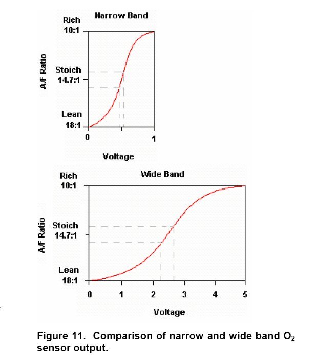

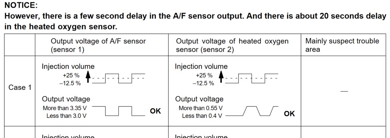

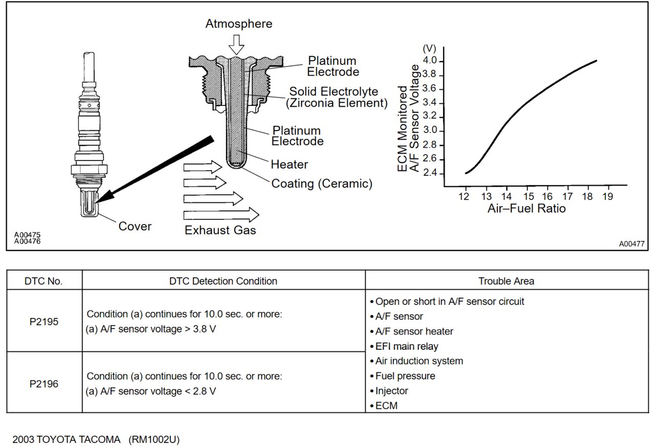

    My stock 2RZ feels like it picks up 20hp when the temps go from 100 to 60°F. Your 5VZ will probably feel like double that.
    Are you talking about the stock ECU? If so, it's probably not a case of the ECU being unable to keep up with transient conditions, but rather something like the MAF not reacting quickly enough or the AE not throwing enough fuel at the engine. I would have thought that Toyota would do something to prevent that being an issue. :confused:
    EDIT: The stock O2 sensor is definitely not fast enough to be useful for transients. See below.
    I'm not familiar with the FIC6, but I recommend that any standalone ECU controlling E85 have a provision for a flex fuel sensor. Pump E85 is such inconsistent crap that you need the ECU to compensate automatically or you're going to be testing and mixing-down your own to a consistent percentage constantly. That, and you're likely going to use a flex fuel sensor to do it anyway, so it might as well be in the vehicle.
    WBO2 controllers nowadays typically have at least one extra programmable voltage output that can be configured to mimic a stock sensor, even a narrowband. I use Innovate LC-2s currently.
    That said, it's IMO probably not trying to maintain 14.7 under boost because it's expected that > X airflow at Y rpm is more than the engine flows NA and is probably boost. Boost + 14.7:1 = warranty claims.
    I looked at the FSM and it's hard to decipher from it what the factory strategy does. They show an AFR vs. voltage graph characteristic of a WBO2, but the operating signal waveform they show is exactly what a narrowband sensor would do. Maybe it's a technical error?
    Any decent standalone is going require all of that though. It should also be capable of running closed-loop all the time with a WBO2.

    It’s a roots SC so it just dumps 10 psi as soon as you hit the gas regardless of rpm/load/etc. all the ecu does is sees knock and cuts timing and by that point no amount of tuning is going to make it feel like you think it should at 10 psi.
    I don’t know what engine you think we are talking about but in closed loop all this thing does is seek 14.7. Even the diagram you posted confirms that and it’s pretty clearly not a narrowband sensor.
    I wouldn’t really care about an E sensor unless I was pushing over 2 bar manifold. The changes it would make can be handled pretty well with the stock ecus ability to cut timing. Off the top of my head it can cut up to 60 degrees and I’ve run close to 30 psi MAP on pump e85 and never seen it cut more than 49 degrees.

    Whatever timing number comes over the OBD2 data stream is just what the ECU has calculated and commanded. What's happening in the engine bay has to be verified in the engine bay.
    What happens when you disable the knock sensor?
    Yes, it is clearly not a narrowband sensor, but why does the signal waveform look like that of a narrowband sensor? My point was that you can't tell what the ECU is doing based on that information.
    Is the stock ECU good because it cuts a truckload of timing or is it bad for that reason? You've said both. There's also the issue of AFR and octane change based on ethanol percentage.
    You don't know what your actual timing is nor what the baseline is, but I'm the one that doesn't know what engine we're talking about.
    I'm not looking for a fight and I only want to contribute to 997tacomav6's thread, but I'm going to defend myself too.

    Here's a picture I found in less than 15 seconds.
    If you can't connect the dots here I really don't know what else to say to you. The reason you can't tell what the ECU is doing is because you cut that diagram from a diagnostics protocol (lol).
    Anyway... yeah I can see you're just trying to be helpful. It's quite clear you don't have a lot of experience with this engine though so maybe just sit back and learn some shit before you start trying to correct everyone.
