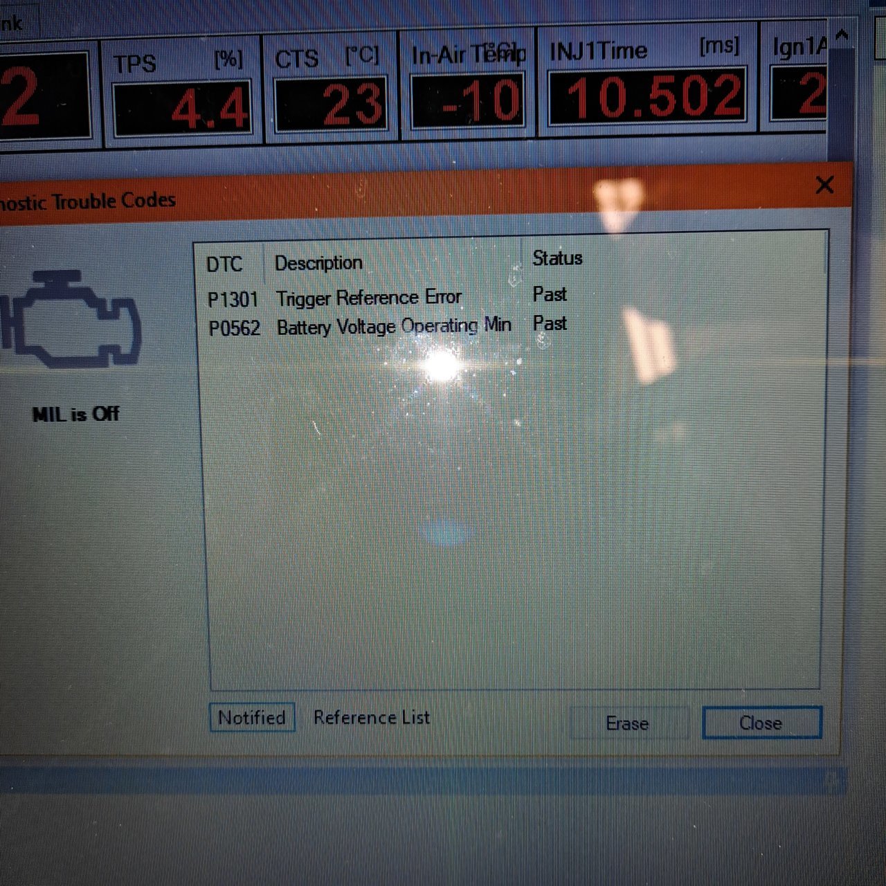

    So I had the check engine light inspected by the tuner because it can only be done with the computer and the haltech software and the tuner said it was in the wiring, So no actually check engine light is showing.

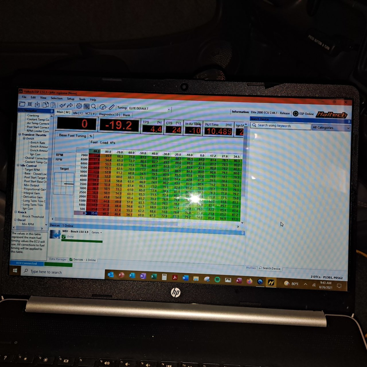

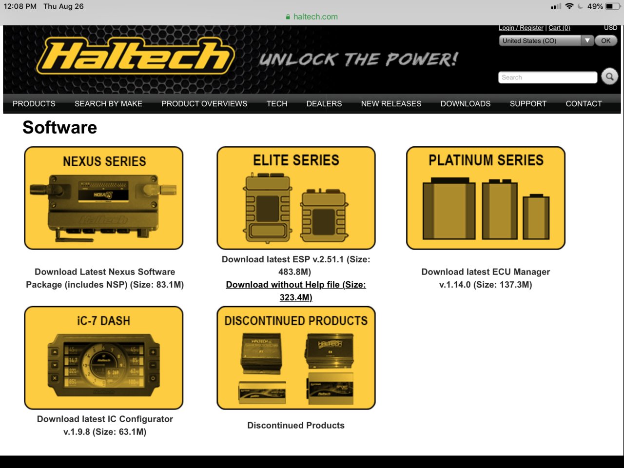

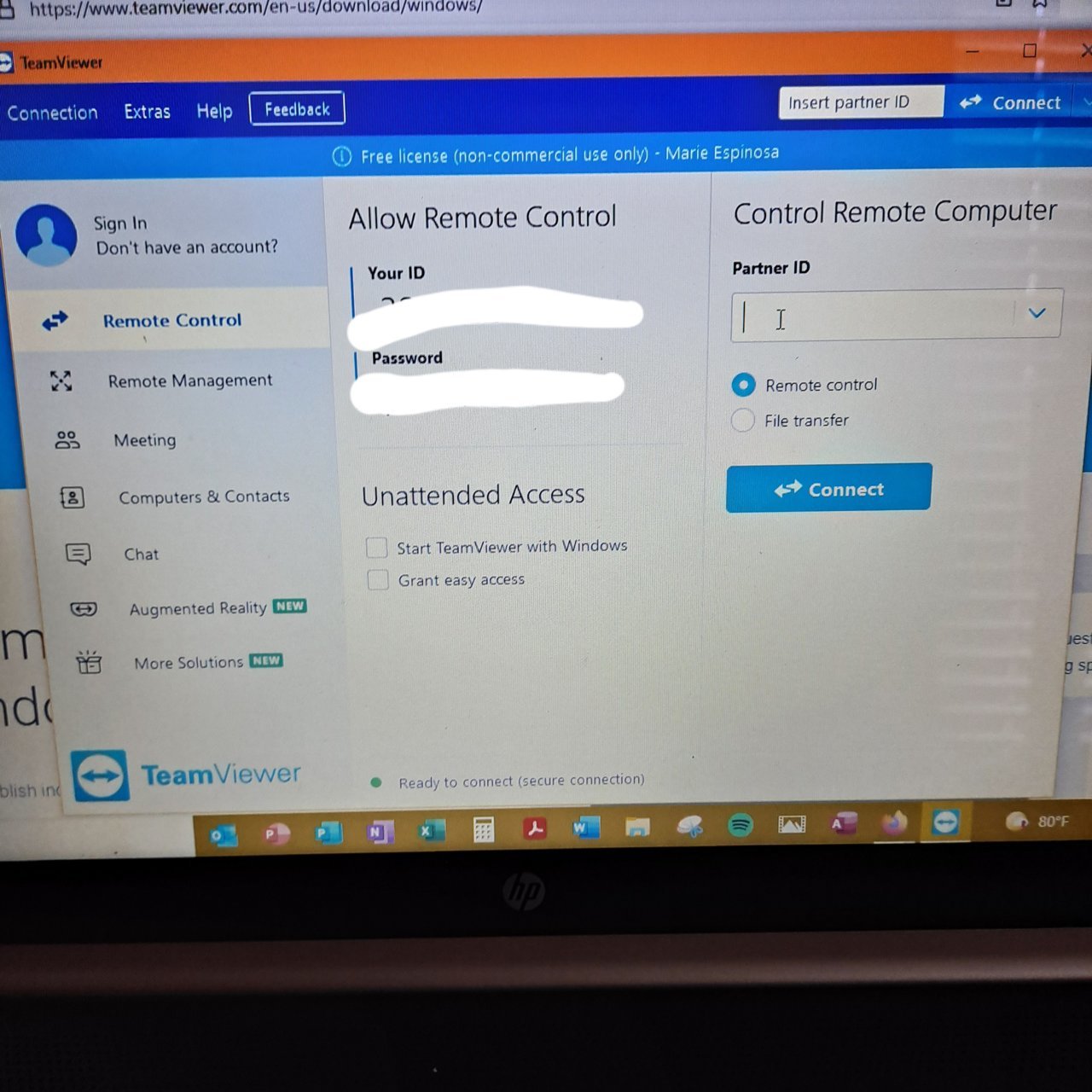

    Got a windows computer and down loaded the software from the website ESP.
    There are two different downloads needed.
    A) the main ESP download
    B) the DATA LOGGER download.
    Then you have to registered with haltech.com to go forward with the software.

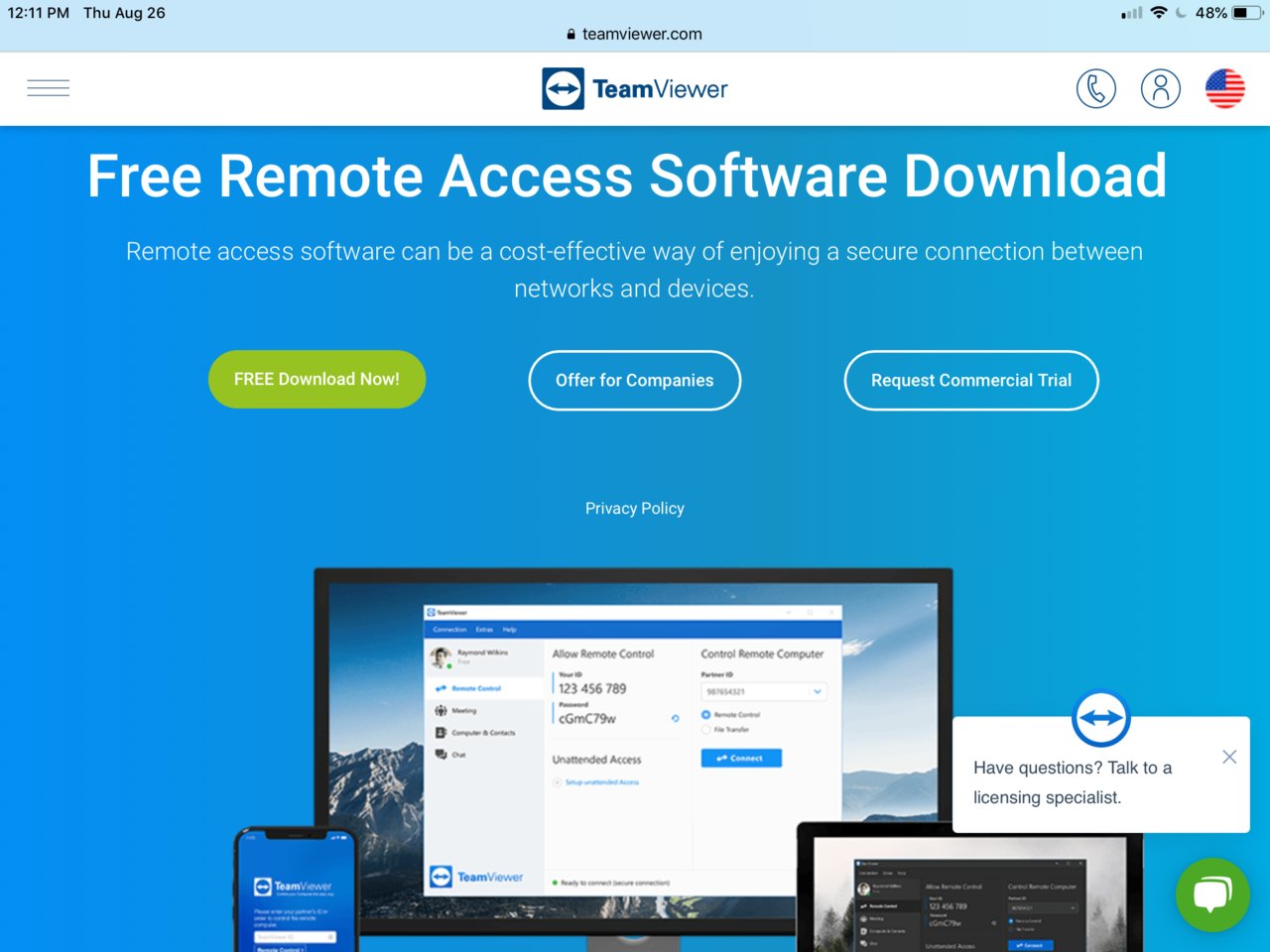

    C) In order to be able to do a remote tune you need ANOTHER download.
    You need to google TEAMVIEWER from the website as a quest=free.
    This with enable a remote access
    to get these bugs fixed today hopefully.

    Yes the timing has be be much different.
    I wonder if I can pull up the timing map on this software?

    We did a quick tie in remote for 30 minutes and he cleaned up a number of settings that
    we’re not spot on.
    Gabe fixed the check engine light, it’s related to the crankshaft sensor.
    If I hit the redline the crankshaft sensor throws a check engine light but clears after the
    engine is restarted. I need one more 30 minute remote or less because we ran out of time to fine tune the idle areas. It drops down to 500 rpms and the AC power 1500 rpm increase is not working,
    This is probably because my truck did not have AC originally and has to be wired into the haltech separately.

    Doing a little more remote tuning today and will be moving the Redline limiter to 5800rpm, Gabe says 6k is still safe with a good tune

    It doesn’t matter about the 19k, that area is literally just for seconds, maybe 1percent at that speed.
    Well we had problems with the new crank sensor,
    It will not let the rpms go over 5400rpms,
    So going to just keep it at this spot for now.
