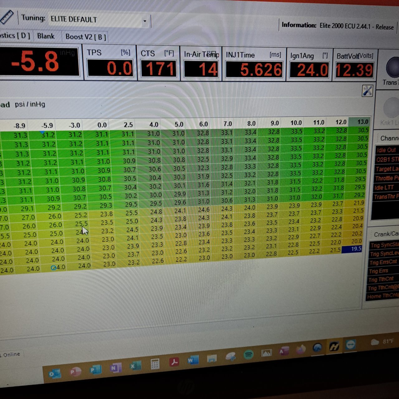

    Here is the timing map relative t boost

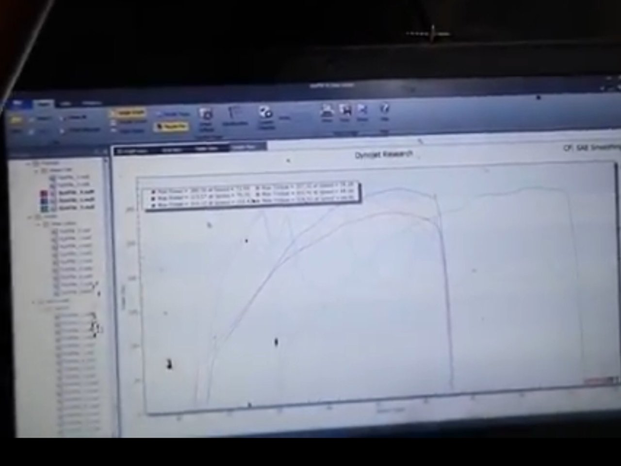

    Here is a screen shot when the tune was being done at 100 degrees.
    Tune was not complete but shows the two Dyno runs with the stock ECU and the Haltech ECU when it was being tuned.
    My October tune will be with temperatures at 50-60 degrees and with better boost numbers because of the temperatures
    You can see the new power comes on at 2k rpms now

    So it's kinda hard to see what's going on there . What were the #'s ? .. we get that there gonna be lower because of the heat. Also are they RWHP?

    The tune was not finished when this quick photo was taken, it was a Dyno tune so it was on the Dyno the whole time, so I don’t have a finished tune number because we had problems with the crankshaft sensor that Gabe had to fix later with the software and the methonal boost sensor is not working correctly right now, it’s spray inconsistently giveing me rich and then lean conditions so a new boost MAF is on order now

    Is HP still rising at 5400rpm, or is it already on the down swing? If it's on the down swing.. might be time for cams :)

    No, at 4500rpms is peak it levels off because of the cams.
    I’m ok,its a daily driver for me.
    The real fun is all the new power at the lower end that comes on immediately
