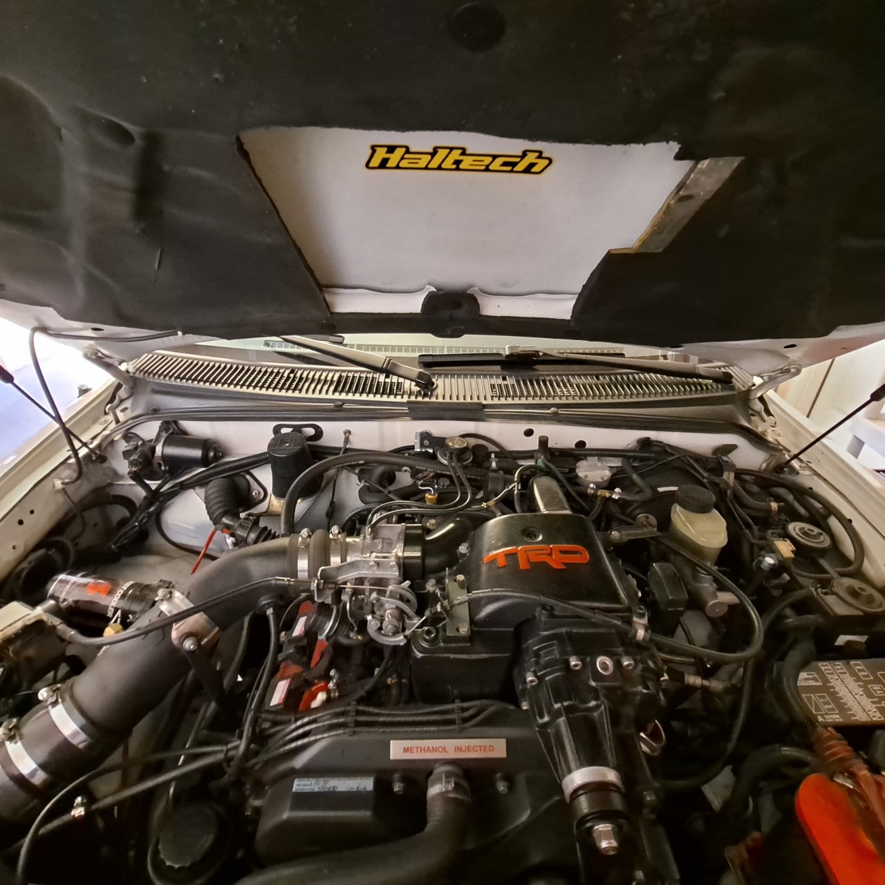

  5. Oct 11, 2021 at 12:20 PM
    #165
    1997tacomav6
    1997tacomav6 [OP] V6 5sp,RegCab,TVS1320 Supercharger,Haltech, 800k
    Oct 5, 2013
    #113940
    10,386
    John
    Denver
    97 reg cab, v6 5sp 300hp supercharged, Methonal Injection, 800,001 plus miles, Original Owner
    V6 5sp,RegCab,TVS1320 Supercharger, 56mm pulley, methanol injected Haltech ECU, AC Tvs1320 supercharger,(MUST DO) every 125,000- 150,000 needs rebuild Projector headlights HID 5 speed manual Amsoil for all drive train Smaller 56mm custom pulley, (MUST DO) 2004 DESNO fuel injectors, zero ping ping, 2004 side door mirrors Dick Cepek Rims, Michelin tires LTX, ATM Pathfinders Dynopro ATM ( that last 100,000 miles) Now running Dynopro ATM mud and snow tires KN cold air intake Cat back dual exhaust with ss exhaust tip, Raised exhaust tail pipe to 2" below body line Optima*dry cell battery,red top Alpine sirius radio, 200 watt amp, focal is165 split door pod speakers Focal door speakers Subwoffer behind seat Viper alarm, Electric Locks Dark tinted windows, bucket seats corbeau lg1 Tacoma Rubber floor mats TRD fender extenders, Bilstien shocks, King shocks JBA UCA trailer iv hitch, electric brake control, Drilled slotted brakes, High carbon steel (MUST DO) EBS green stuff 7000 series pads(MUST DO) TRD engine oil cap TRD stick shift, Marlin crawl shift kit. Rear sliding window 2002 4Runner functional hood scoop cut into Tacoma hood, 4Runner dual overhead map light Gentex Auto dim + Compass + Temp, garage,rearview mirror Snow Methonal kit stage 2 Custom 3 core aluminum radiator Linex bed liner Haltech stand alone ECU, Intake supercharger gauge. Stainless steel brake lines, Custom leather wrapped steering wheel, Haltech stand-alone ECU,
    And we got the sticker installed today

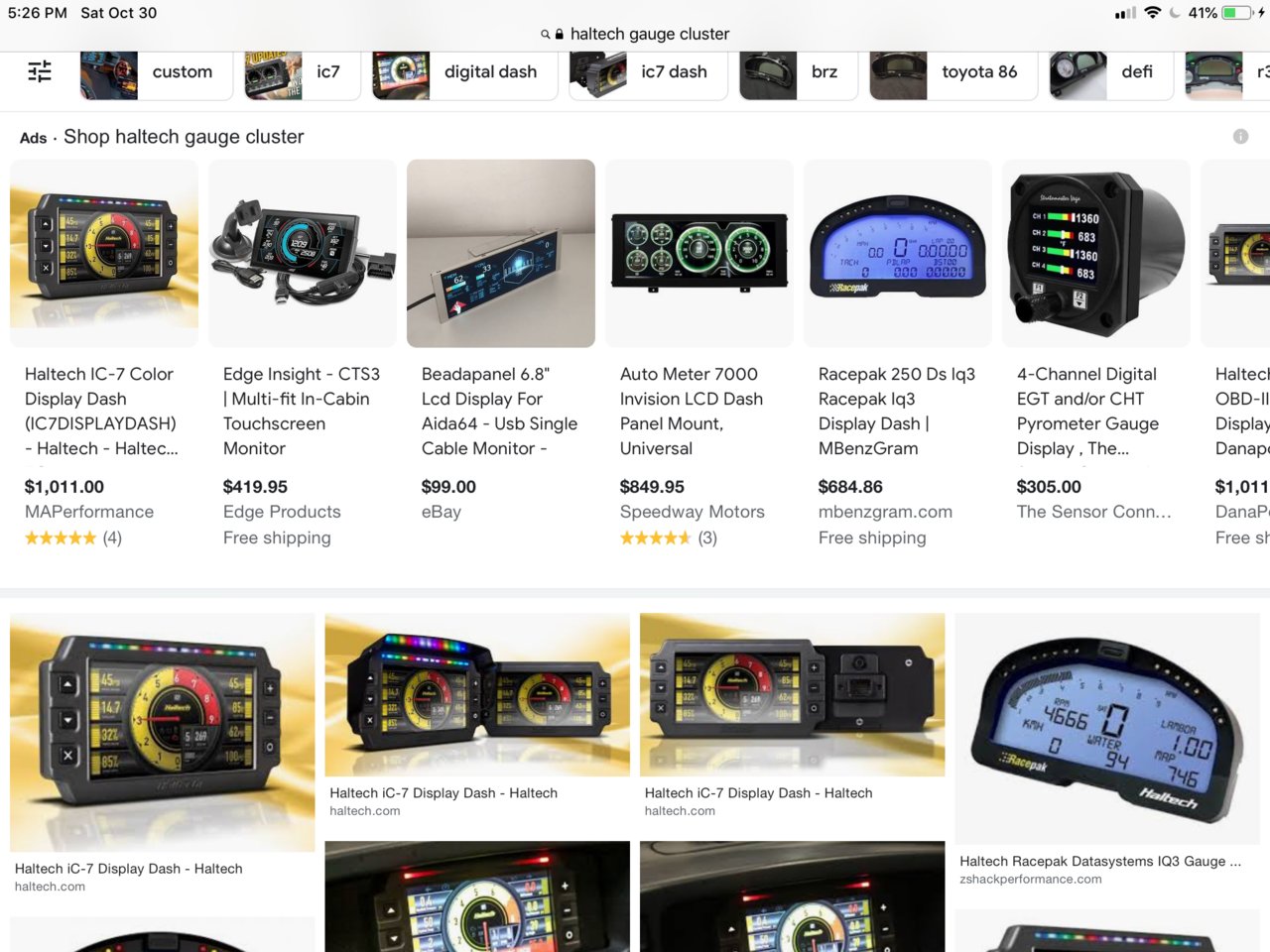

    I didn’t have a harness adapter to plug the scanguage into the haltech,
    The OBII is for the stock ECU and the stock ECU is not part of the system anymore.
    So a harness is needed to run it into the haltech

    Why not just use a much more functional Haltech screen though. You could interact more and get better data... An not have to use a crappy scangauge too haha
  10. Oct 30, 2021 at 4:25 PM
    #170
    1997tacomav6
    Oct 5, 2013
    #113940
    10,386
    John
    Denver
    :rofl:
    I agree, but I don’t want any more gauges stuck on my dash,
    They make a bunch of cool ones tho

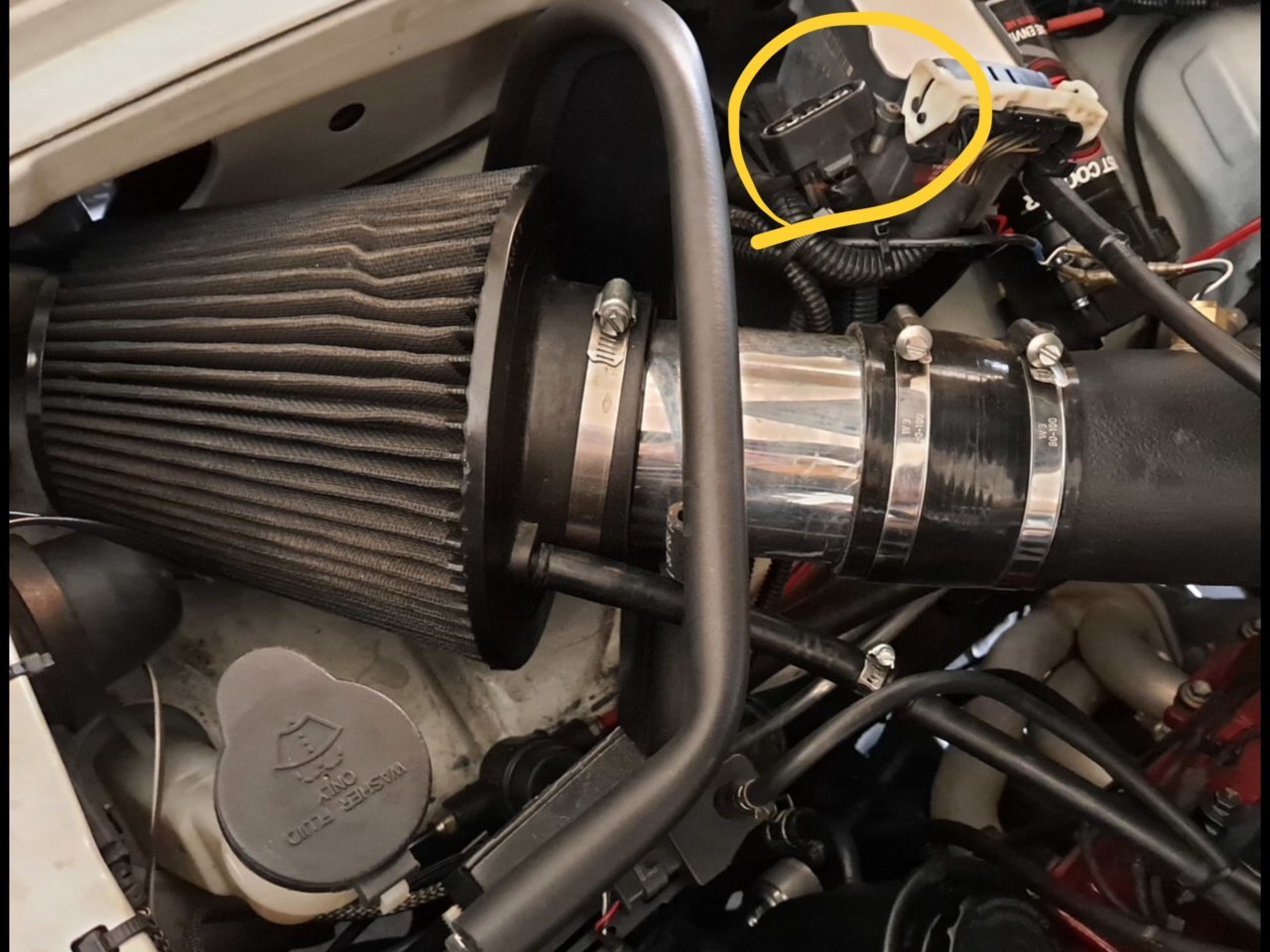

    Has the MAF sensor been completely removed? Is it solely a VE tune?
  17. Nov 15, 2021 at 6:19 PM
    #177
    1997tacomav6
    Oct 5, 2013
    #113940
    10,386
    John
    Denver

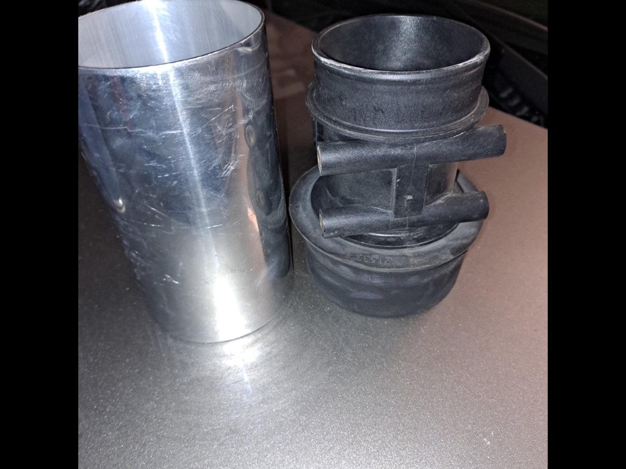

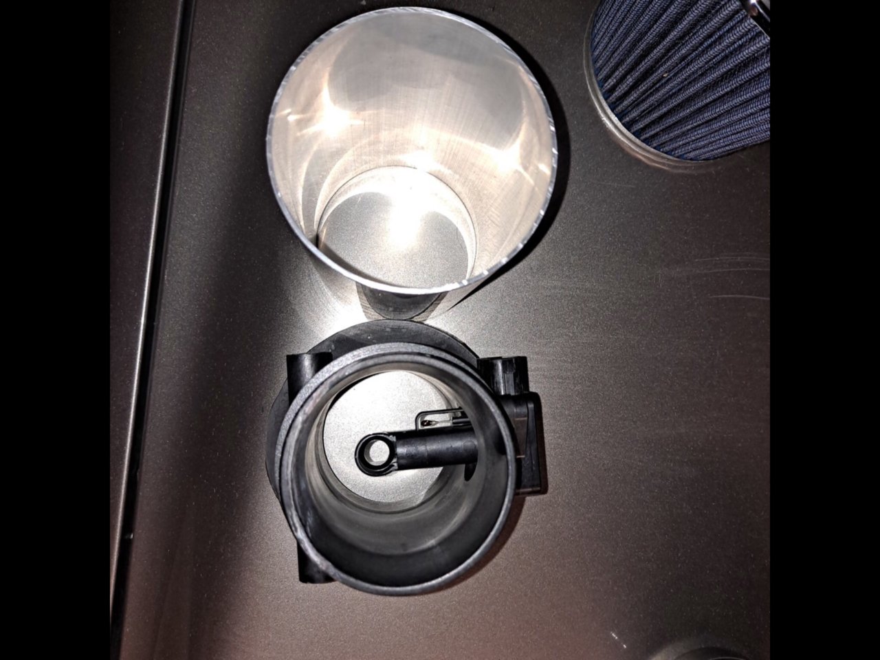

    You can leave the stock MAF and tube in place if you want.
    There is NO current going to this sensor when the haltech is plugged in,
    I just tied the MAF plug off as shown in the yellow circle
    I actually removed the entire section and put in a 3.5” tube section from the 2.5” section that was in there from stock.
