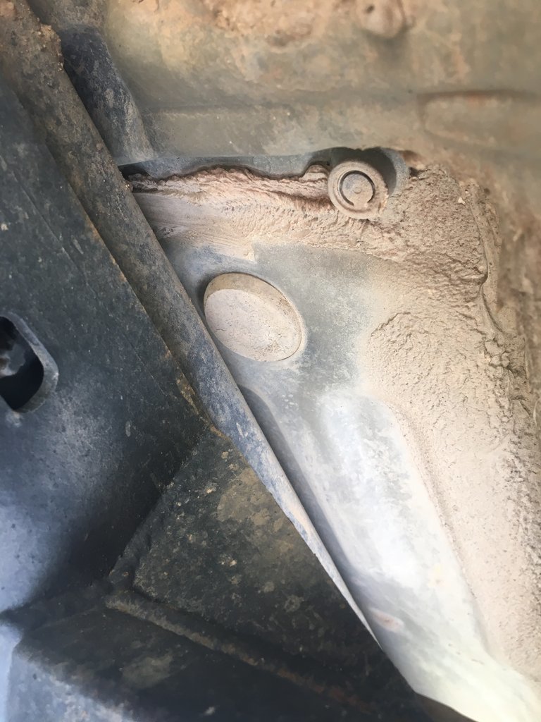

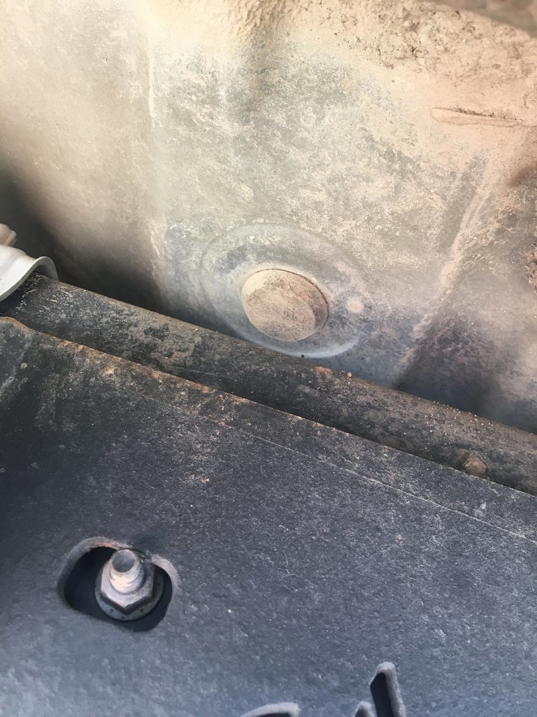

    So I found 2 rubber grommet looking things. Any idea which I should use?
    Here's the first one. It's a bit bigger. Located about where the door opens
    Here's the second. Bit smaller. Located towards the front of the driver seat.
  17. Sep 19, 2017 at 1:42 PM

    I would use whatever side the antenna is mounted on.
  18. Sep 19, 2017 at 1:42 PM
    #18
    EatSleepTacos
    Mar 24, 2015
    #151688
    59,833
    Randy
    West Valley, AZ
    2017 4Runner
    Either one works. What I did was drill a small hole in the grommet, then cut from the hole to the edge of the grommet. That way you can slip the grommet over the coax and get a decent seal, then add silicone for added waterproofing.

  19. Sep 19, 2017 at 1:43 PM
    #19
    uhplifted
    uhplifted [OP] The Hopfather
    Jun 21, 2016
    #190174
    25,191
    Brian
    Huntington Beach, CA
    16 DCLB OR
    They are both driver side
  20. Sep 19, 2017 at 1:43 PM
    #20
    uhplifted
    Jun 21, 2016
    #190174
    25,191
    Brian
    16 DCLB OR
    Sweet thanks. I'll probably try and do something similar to that
