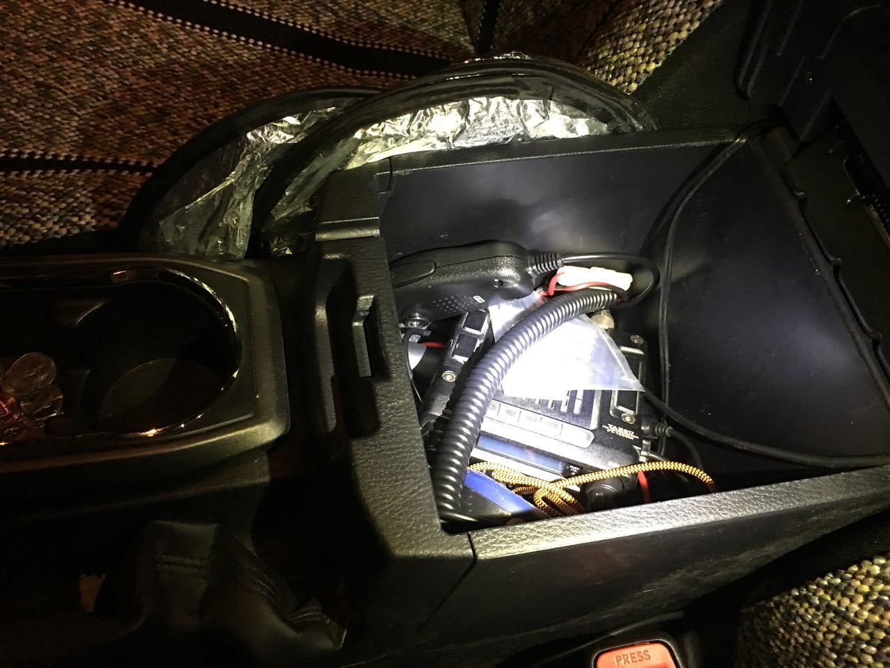

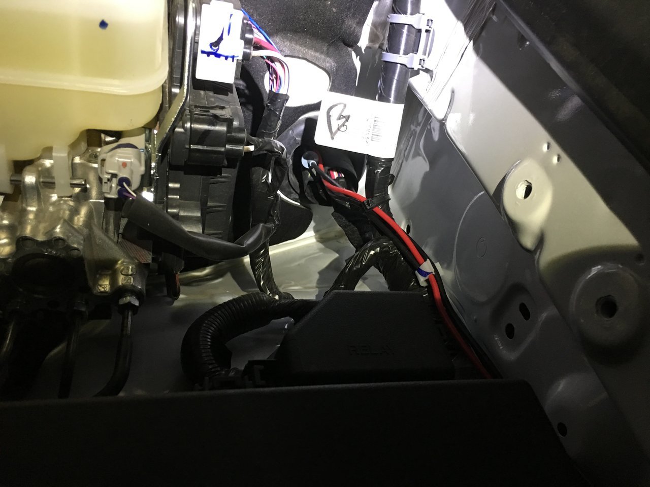

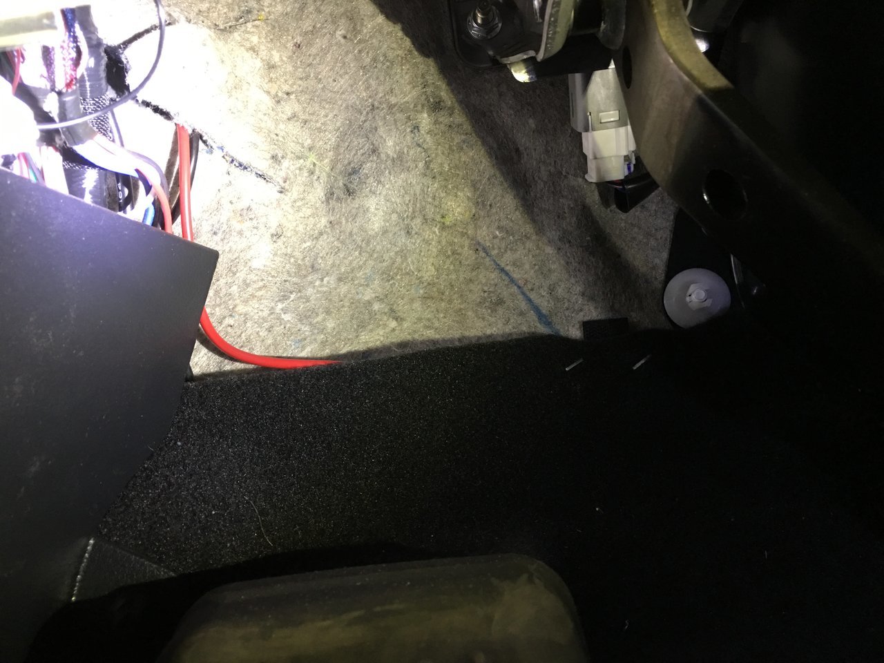

    From the battery, the power wires go straight back and through a small hole I put in the main harness gromet in the firewall.
    ... they enter the cab near the corner under the dash on the drivers side and then run along the edge of the console cover up through a small existing hole in the bottom of the console to the radio. Thread this wire down through the console hole first towards the battery so you can fish it through the hole and tuck it in along the bottom of the console cover all the way towards the firewall, then under the carpet behind the pedals and up and out through the gromet to the battery.
    Radio power wires go down and out at the bottom of the box (unseen here), the black double strand wire in this pic is just a 12v cigarette extension for the back seat, and my antenna coax goes up and out of the box in the corner and down next to the drivers seat towards the rear slider window under the carpet and up between the rear seat split (just the small part of where it goes into the box corner is visible).

    Running off the battery is independent of the ignition being on, useful if you are in an emergency and system failures happen, but more importantly, transmitting in high power is possible if you run the heavier gauge wire to the battery. I tried doing it to that output (both directly but through a cigarette lighter plug first), and my radio wouldn't transmit at 50 watts.
    My plug was still on the coax when I ran it, so I had to go in from the top- but yes, power and coax can fit through the hole at the bottom of the box.
