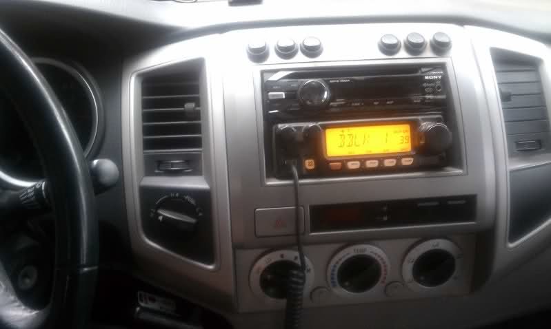

  12. Mar 4, 2013 at 10:32 AM
    MonkeyProof
    MonkeyProof Power Top
    Oct 7, 2008
    #9774
    10,099
    SoCal- SGV
    I mounted a yaesu FT2800m in the stock stereo location using a double din thingy..
    Crom likes this.
  13. Mar 4, 2013 at 10:40 AM
    PreRunnerSeth
    PreRunnerSeth Well-Known Member
    Aug 12, 2009
    #21110
    4,281
    Apex, NC
    15 Black DC OR Prerunner
    Ugh, This is a VERY bad place to mount a Ham radio. Mobile ham radios generally put out as much as 50W depending on the setting. CBs only put out 4W and this is why they are ok to mount like this. A Ham radio operating at a reasonable duty cycle and 50W will get way too hot mounted like that. They need space around them to breathe. The Finals wont last long like this.

  15. Mar 4, 2013 at 11:13 AM
    MonkeyProof
    Oct 7, 2008
    #9774
    10,099
    SoCal- SGV
    Thanks for the thought on where its mounted but its been here in this location since late 2008 with everyday use at full power. Never any problems so I'm not worried. I know the 2800 and 2900's have a problem with the power transistor blowing but I Havnt experienced that problem yet with either of my 2800's. I have another one similarly mounted on my rock crawler as well.
