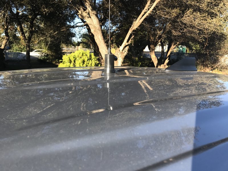

    IMG_0246.jpg Larsen NMO thru the roof. Works like it's suppose to. Unscrews when you want it off for those low clearance areas. Just drill the hole and do it right.

    This is how I want to eventually do mine. Any pics with tips on the headliner? I have an antennex NMO hole saw so set there.

    Sorry no pictures. Headliner is easy but time comsuming. Look at youtube for Taco sound dreading install. That will help you out.
