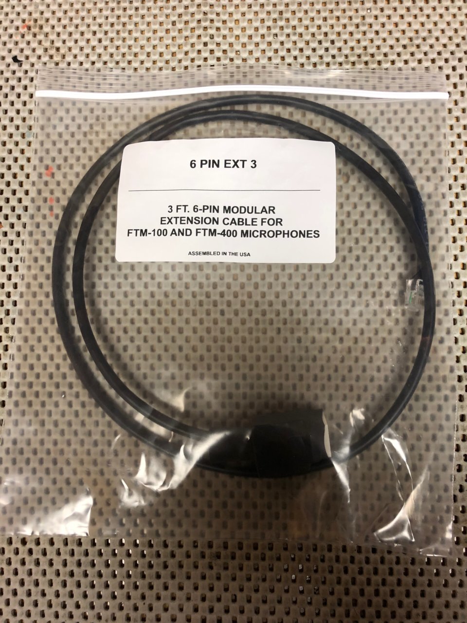

    Smoking hot deal on that radio right now. I too picked one up and got it installed. I'm waiting on a microphone extension cable which will allow me to finish up the install to my liking. Sale is good through the end of the month on the Yaesu FTM 400 xdr.

    A little late now, but these extension cables are little more than different kinds of RJ phone cords. I made my extension out of $5 in cord and a pass through coupler. All from Amazon prime.

    I'm glad you brought that up because I went that route and was unsuccessful. I purchased a 3-ft RJ11 cable from N2RGA Cable Sales which was guaranteed to work with 400 xdr. I then purchased a Tripp-Lite pass through coupler from Amazon Prime, connected and plugged in. No joy on operation as the microphone went dead. Back to stock configuration and all is well. Sooooo, I checked with HRO and they have a dedicated cable albeit a $13.00 investment. I don't know what went wrong with my first attempt, but I'm hoping this new cable works out as I really need that extra bit of cable length for my setup. I'll report back this weekend after I get it installed.

    I know some couplers and even cables don’t have a 1:1 pass through. Meaning some are interconnected to one another or whatever can cause some issues. I just made sure what I bought mentioned shielding and other buzzwords lol.

    Picked up and installed this microphone extension cable from HRO and I can report all is working well.
