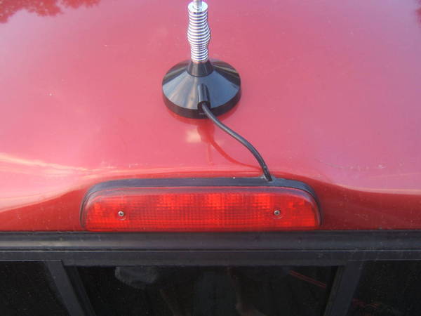

    This is how I ran my CB antenna. Granted it's only RG59 and not thick cable. The hardest part was the headliner. About a dozen interior panels had to come out before it would drop without bending too much.
    Thanks John. I'm pretty sure I'm ready for them, now just gotta get a couple locals to sit in with me.
