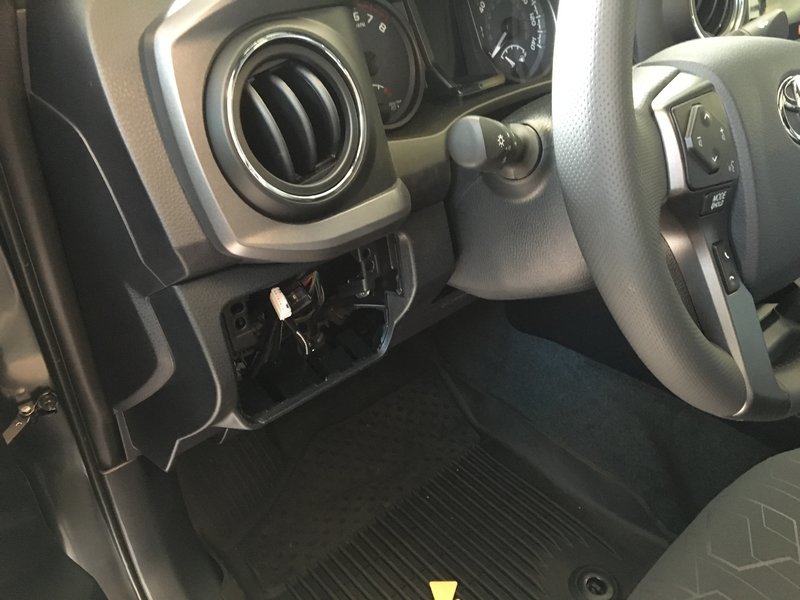

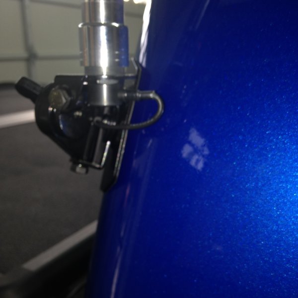

    I got around to installing my Kenwood D710 in the 2017 Tacoma today. I have searched for weeks for what mount I could use to no avail. To my surprise, the bracket from my 2008 Tahoe was an EXACT MATCH!!! the offset even matched the Toyota hood as you can see in the pictures.

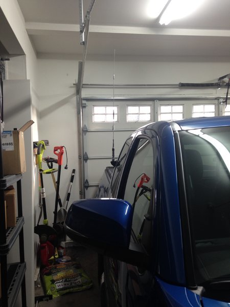

    The bracket was ordered from Comet and the antenna is a Larsen NMO 2/70B. 144/440 antenna.

    I also saw some using the GoPro mount but didn't want to disrupt the wife's view out the windshield. This also keeps it out of the direct sunlight.

    Nice job! I was thinking of a similar antenna mount but it doesn't look like RG-58 coax will fit in the gap around the hood. Were you able to use RG-58 without pinching or did you use a smaller size coax?
  8. Sep 18, 2016 at 10:46 AM
    ChrisK7UND
    ChrisK7UND [OP] Well-Known Member
    Sep 14, 2016
    #197268
    558
    Colorado
    2017 Tacoma TRD Sport Double-Cab
    LED Interior Bulbs, Hondo Garage Phone Mount, Tacoma Bed Mat
    That is rg58 and its loose. I can slide it with hood closed no problem. The fender bolt is a little flimsy but no fender flex and the antenna is light. Not sure I would put a heavy fiberglass antenna in this location as the fender bolt is somewhat wimpy.

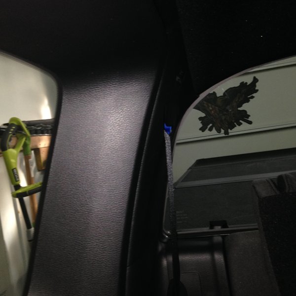

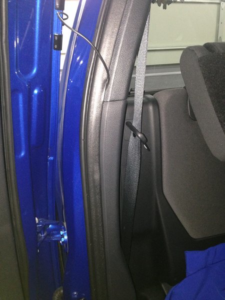

    image.jpg image.jpg image.jpg image.jpg image.jpg Hope this contributes- just installed my dual band antenna using a lip mount from comet, mounted on the trailing edge of the access cab door. This mount comes with 18" of reduced size lead wire and 16' of standard '58

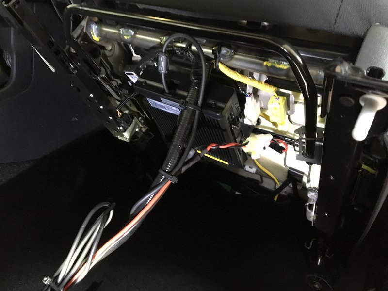

    Where'd you mount the transceiver body?

    Yes where is the RF deck and does it have the gps module in it? Also the mic attaches to the RF deck so where were you able to mount it?

    The RF deck is under the drivers seat. Mic is plugged directly into the RF deck. Routed all wires in factory wire chase under the door trim.
