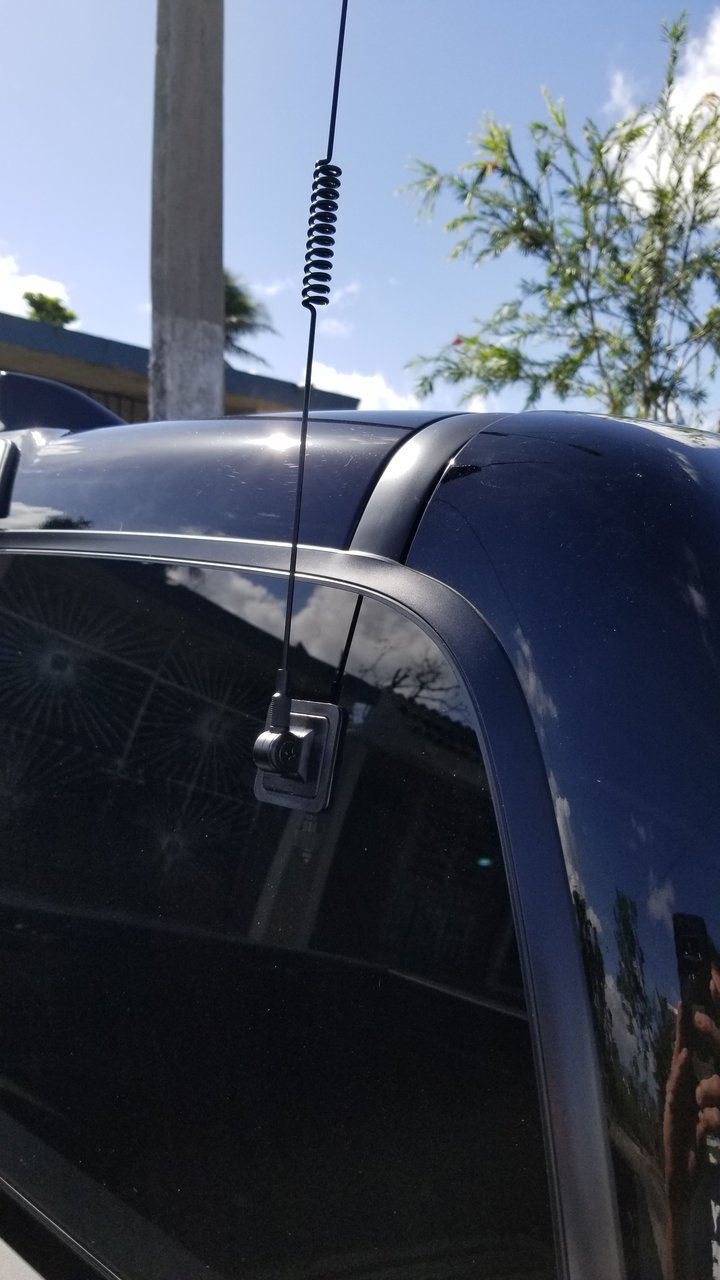

    Nice set ups, gave me some ideas with scosche mounts. Since I'm right handed I'll go with the dash install, not to Comfy with the left side face Install . Ysesu ft8800r, glass mount dual band antenna. 73, de WP4AA.

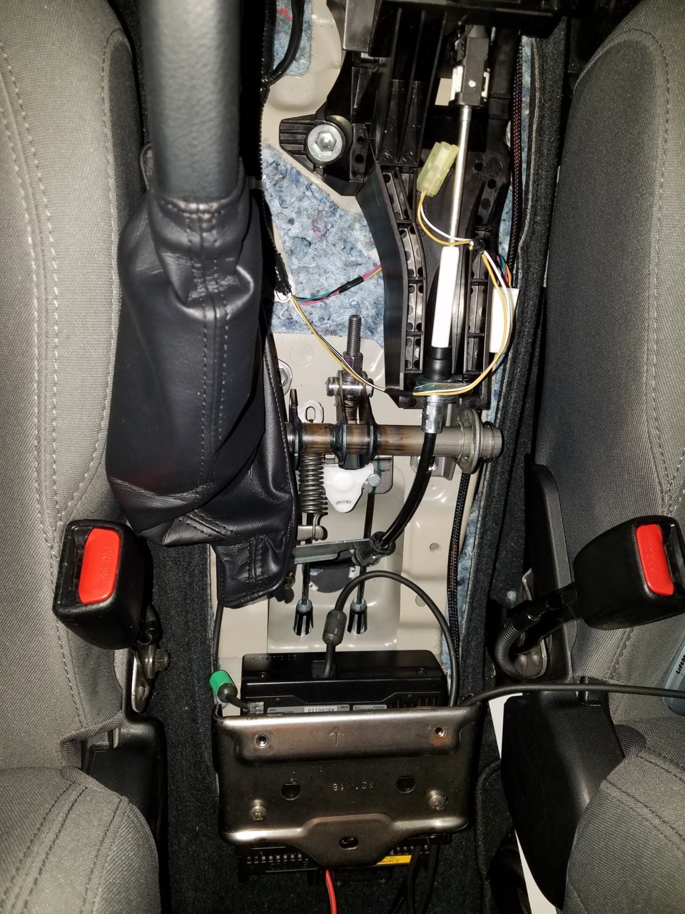

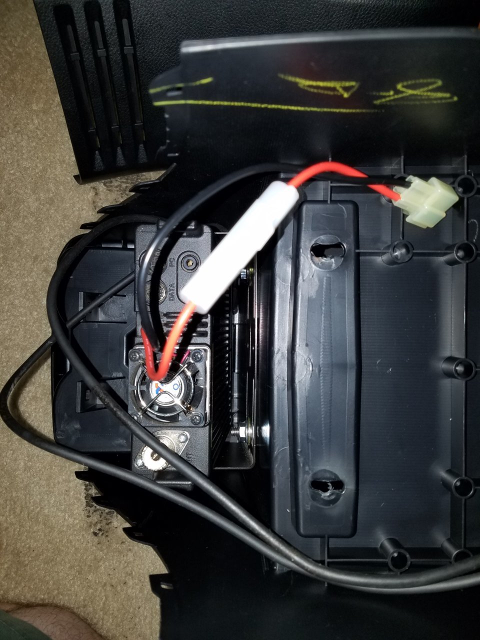

    Are other people also using the inverter mount space to install the main radio box for units with remote heads? I have only seen one post on TW where someone did that. The G710 body fits that spot great. Of course I have a lower trim without the inverter installed.
    I almost mounted it in the space between the center console cubby (the one with the lid) and the back cover (did you know that comes off?) but ended up securing extra wire length there. Picture shows install before I changed my mind.

    I had mine mounted in front of the shifter in that cubby with no GPS problems and now have it mounted right up against the roof of the truck next to the dome lights. No GPS issues at either location and neither has a very good direct view of open sky.

    Does the body stay cool enough in there? I like it being concealed but worried about heat.

    I've read about the glass mount, how is it? Still using it? Any reason I shouldn't go that route?

    I have not used it enough to make a final determination, but the way I figure is that some trim levels have the inverter there and you know that will out off some heat. There are already some venting slots cut into the center console rear cover near the floor which will also help.
