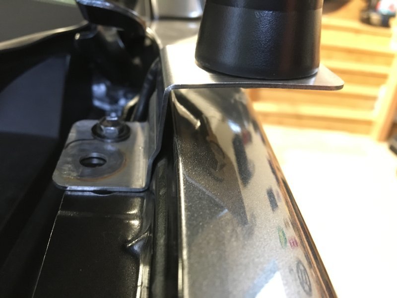

    Tint can degrade the swr so you might want to check it once you decide to mount it there. I would look at either Comet's stainless bolt on mount that goes on the hood and uses one of the bolts to mount it to a fender. I think they also make a 2021 mount that uses the bolts on the back of the tailgate. That is made for a LED light but you just take a step drill bit and enlarge it for the size of the antenna mount. What I am planning on doing with one of the mounts is doing each one in front for one dual band and one in back for another and eventually a Icom 7000. The rear mount will take a bigger antenna that the HF radio will use. If you don't or can't find one that is made expressly for your rig find someone who can bend 14/16 ga Stainless and have them make you one. I had a friend make one for a 72 datsun pickup I had years ago. Good luck if you haven't made up your mind and regardless hope things work out for you 73

    @bandaidman I totally agree about the factory or aftermarket tint on glass windows. In fact, Cushcraft noted the warning on their glass mounted antennas. I have great success on my Sienna SE and Camry using half wave cushcraft, but my ‘21 Taco just have no place to install the antenna. I am looking at hood brackets that does not look to appealing to me on the truck...so my other option is a truck bed bracket from Caliraised. I am trying to stay away from mag mounts on the truck. I know, there is still a lot to explore. Thank stour for your input. For now, I am just using an HT whenever I’m in the Taco.

    I like using half wave antennas as opposed to the little quarter wave antennas. Antenna gain is much better. I limit my max transmit power to 80 watts and do mostly repeater operation while mobile. With that said, my choice is pretty limited. I am looking at the CaliRaised Antenna accessory bed for the Taco and while shopping around online, I found an advertised 3/8" NMO Hole Mount from antennafarm.com that MIGHT fit the Caliraised bracket...I am just not so sure on what type of whip I should get for 2 meters only. Still need to shop more on this. My other dilemna is the task on running the coax cable from the rear to the front of the truck. Any tips on routing the coax from the rear to the front. If the rear antenna bracket does not work to my taste, I probably may just have to settle for a small magnetic mount with PL-259 connector...which is my very last choice.

    If you choose to use the caliRaised bracket and want to use a dual band antenna you can do what I am doing ( as soon as I can find my step drill bit.) I have a comet antenna mount with a small section of small coax that I am going to thread into the rear tail light and take it up to the cab and use the big grommet at the rear and on the bottom of the cab. I'll push it through and mount the radio behind the back seat. The comet coax (CK 3M5) comes with the connector that mounts to the radio it can be unscrewed or if you buy new comes without it attached so you don't have to make a big cut to pass the coax through the grommet you then you can screw it on and attach it to the radio. If your radio has a kit to separate the faceplate from the radio all you need to do then is run the cable from the radio to the faceplate figure out what you want to do with a speaker and set it up. I'd have it up and running but I don't climb under things very well now days and I have to wait for my son to have a day off. Good luck, installs are always fun.
