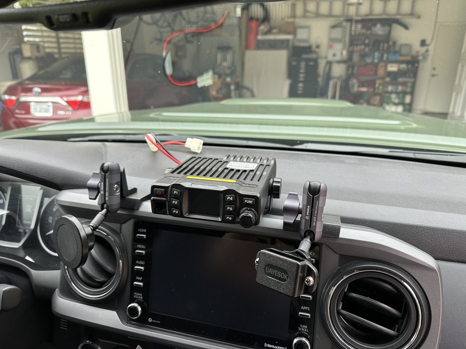

    I'd like to install this ham radio on top of the dash. Seems simple enough. Two screws into the bezel and the radio's attached. But I'd like to route the wires (two power wires, positive and negative, and an antenna wire, likely all combined in a single comb-type cable shell) towards the back of the dash (where the windshield and dash meet) and route somewhere to the bottom of the dash so I can pop them all through the firewall into the engine compartment for hookup to power and an antenna I'll install in a lip-mount on the passenger side of the hood.
    My question: any easy way to get that cable routing hidden? Are there dash components that will easily pop-off and have a bit of space to route such?
    Photo attached for location concept.

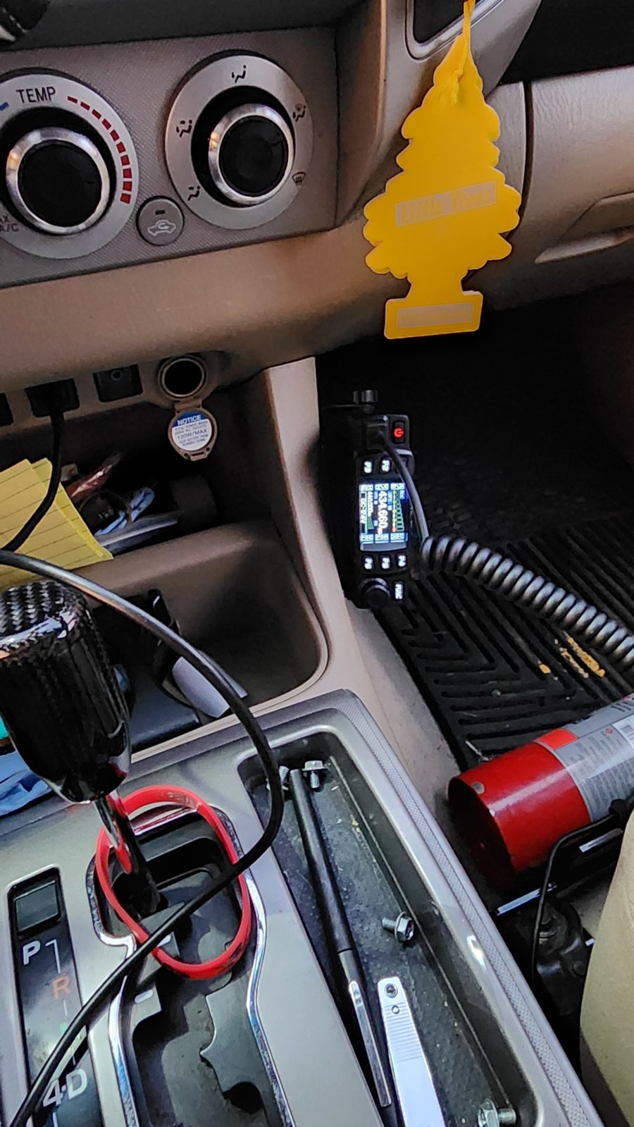

    so if you're going to mount there why run all the wiring into the engine bay I have mine tapped into the power outlet. which in my 2n gen is a constant hot, up under my steering wheel. and that still allows me to remove the radio if I end up in a new truck. though mine is mounted in the footwell against the center console area, and ive the same radio.

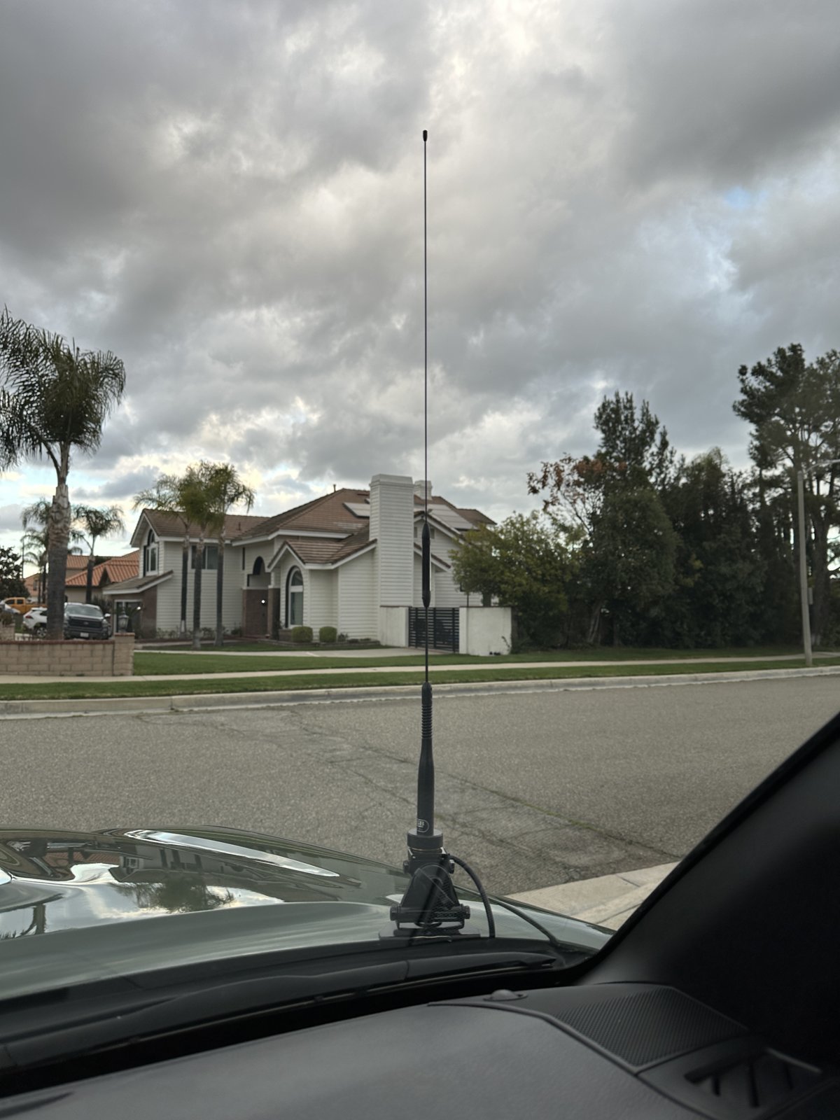

    BigCountry762x39: yes, I've seen those, but wasn't a big fan of wires hanging around in the cab. The antenna's to be mounted on a Comet 730 hood-lip mount on the passenger side, so that will end up in the engine bay and come through the firewall into the cab, and for power it seems easy enough to find a convenient source in the engine bay (lots of options for pursuing that). Do you have a photo of your install? Aside from where you got the power (the cigarette lighter I guess) where did you put the actual radio?

    And as for wiring. I've mine run behind to the fuse panel next to the wheel. And my programming cable tucked up next to the shifter area.
    sorry my truck is a mess here this was moments after competing it, and putting all the stuff back, and moments after sending my daughter into the house to grab a beofeng, for testing. before CHIRP programming.
    oh and my wife who often ends up in the passenger seat hates the fire extinguisher way more then the radio location

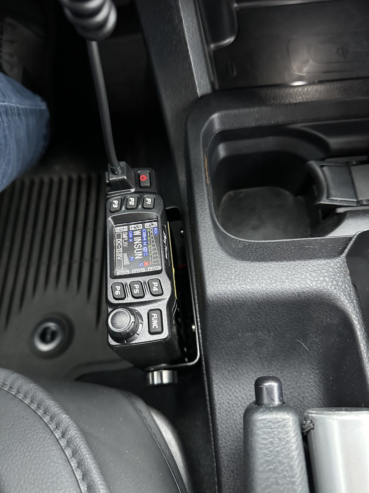

    Final install. Not my favorite, but as others have noted here and elsewhere, the Tacoma doesn't have a lot of great mounting options. I still like the top of dash location, but figuring out how to mount it and then how to hide the wires turned out to be beyond what I was willing to suffer through.

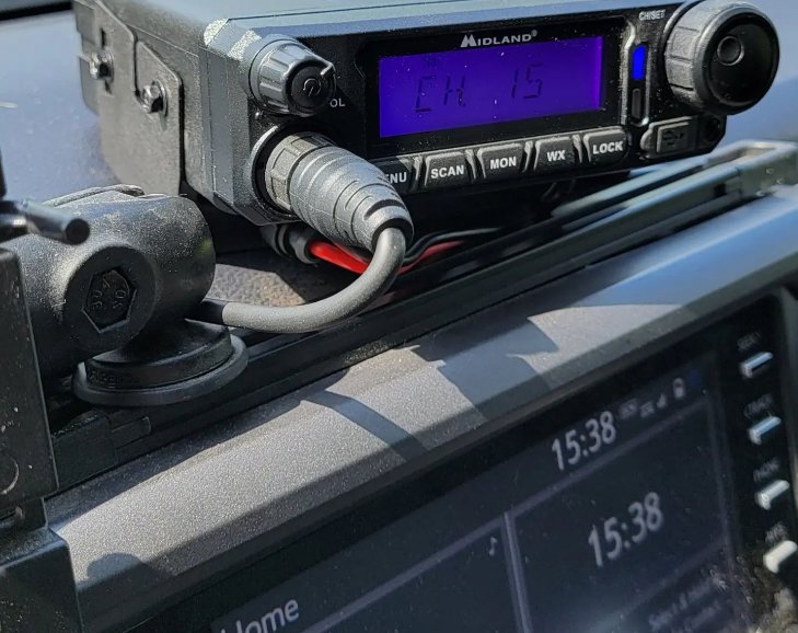

    I put my MXT500 (GMRS.. I know) on my dash just so I can easily change channels, adjust volume, or do anything really to it without taking my eyes off the road upload_2024-3-3_15-4-37.png

    you can easily drill a hole right behind the radio and fish them down. my power wires aren't even visible once I just scooted the connector the right a bit.
