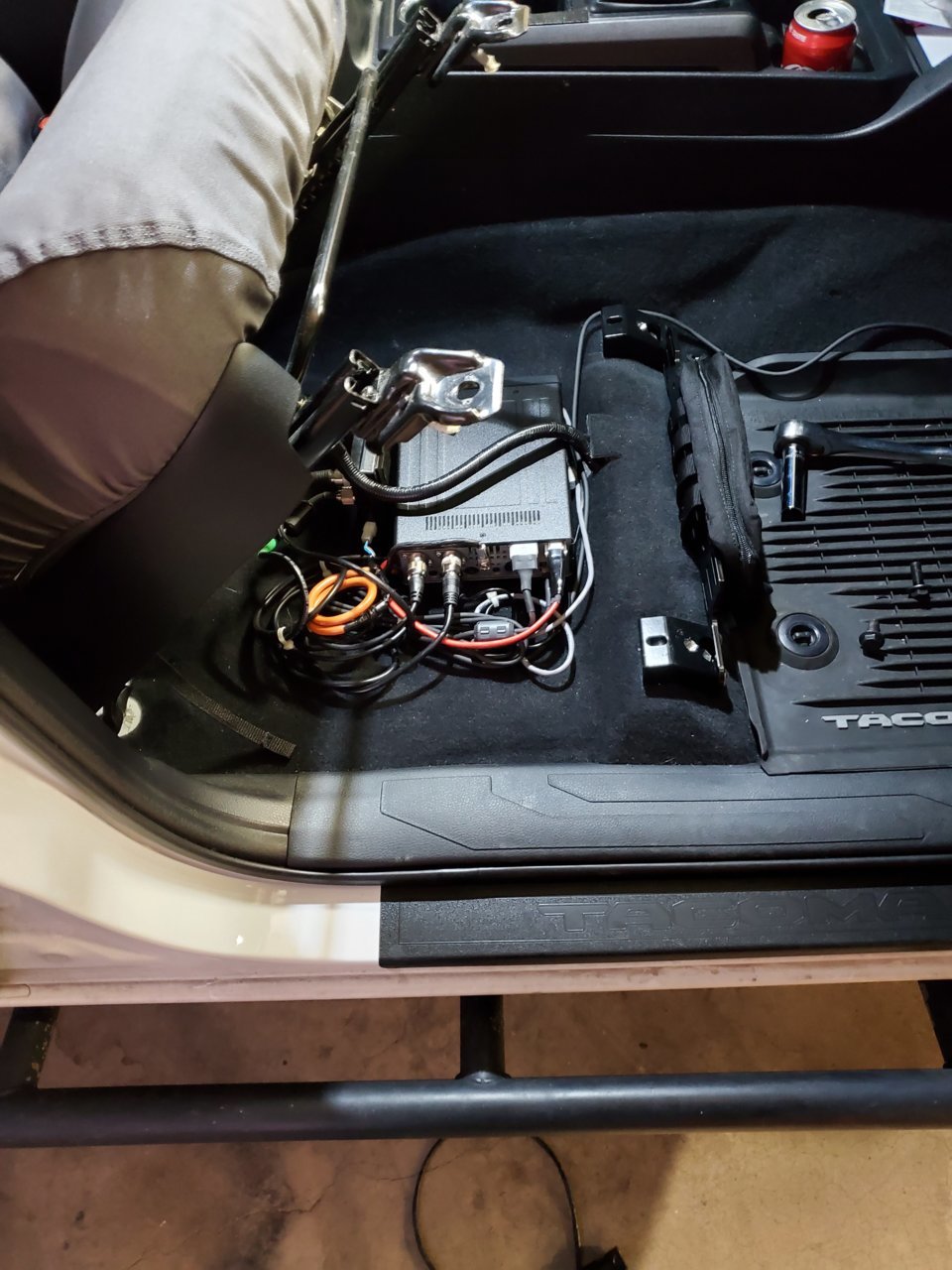

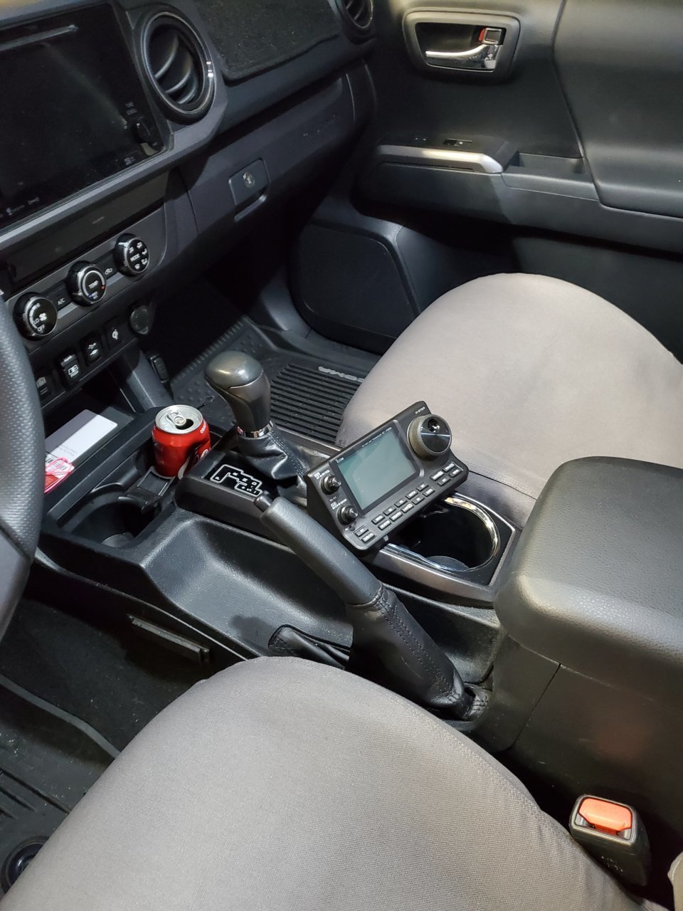

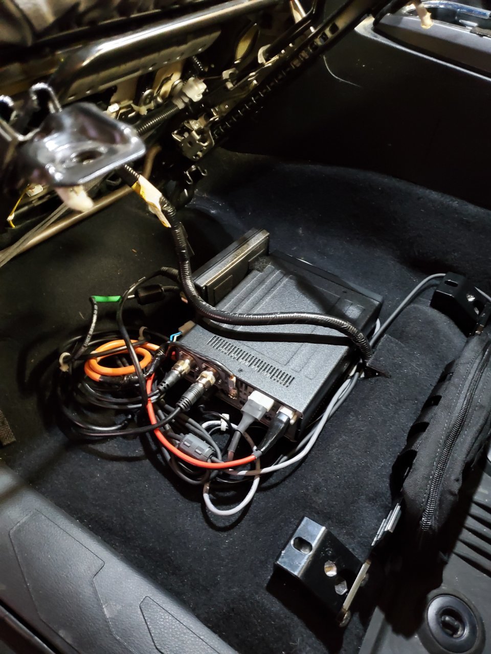

    I installed a ICOM 7100 on the center console. Its at arms length & it out of the way when not in use. Its also easy to remove to use as a home base. I leave the main unit in the truck & extend cat 6, for the control head, into my garage. Also I lifted the seat 1-1/4" with seat jackers.
