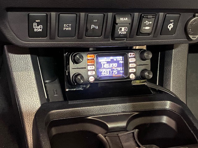

    Here is where I mounted my Yaesu FTM300 control head. The radio is under the passenger side seat and the connection cable runs under the carpet. I don't use the phone charger so using that space is not an issue for me. It sits on a Nifty Accessories FTM300DR desk stand mount which fits perfectly in that charger space. I didn't get around to screwing down but it's been there close to 2 years and is secure enough unless maybe when heavy off roading which I don't do.

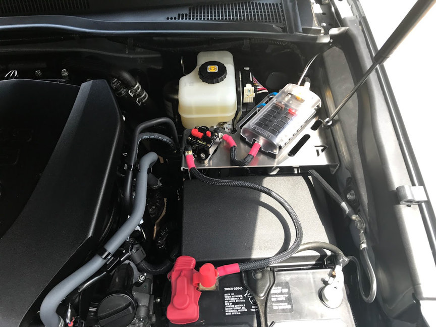

    As to the power cable, I used one gauge up from what came with the radio (can't remember off hand what the sizes are) and put the inline fuse near the radio.tacoma-fuse-blockopm.jpg
    I didn't go directly to the battery which is what is suggested, but rather went to my Blue Sea fuse block which is very near the battery and has heavy duty cabling and also has a fuse. I also have a fuse at the battery terminal which feeds the fuse block.
    I ran the power cable through the driver's side harness entry. There's plenty of room there and it comes out near the brake peddle. From there I ran it under the carpeting to the radio.
    I mounted the antenna on the hood and ran it through the harness access hole on the passenger side. That was tight and if I were to do that again I'd drill a hole in the firewall and add a gourmet or maybe a pass through fitting.

    I put in that 12 circuit fuse box before adding any electrical accessories figuring once in, unless I needed a relay, I'd be a step ahead on future wiring. I probably should have gone with a 6 circuit instead of the 12 as I can't imagine having that many accessories wired up and the extra space on the bracket could be used to mount relays should they be needed. I might change that at some point.
    Here's a good option for a quick and easy set up at the battery. You can add a similar ground connector at the neg terminal.
    https://www.amazon.com/Blue-Sea-Sys...la-435853439951&ref=&adgrpid=64958377347&th=1

    What's that bracket/stand you have your fuse box on?

    10g wire, fuses at the battery
    Feed wire through main wire grommet driver side firewall, which if you were sitting in the drivers seat would be about even with your left knee. There's a similar grommet on the passenger side firewall but I prefer to keep wiring inside for as long as possible.
