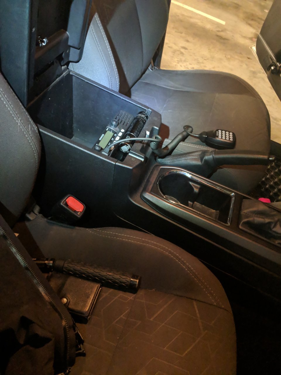

    16 DCSB SR5 4X4 "ikea furniture haulers" edition.
    Ditch light mount for antenna.
    Need a remote face mount and place in the center console cubby under the climate controls. Mount the main body under the seat.

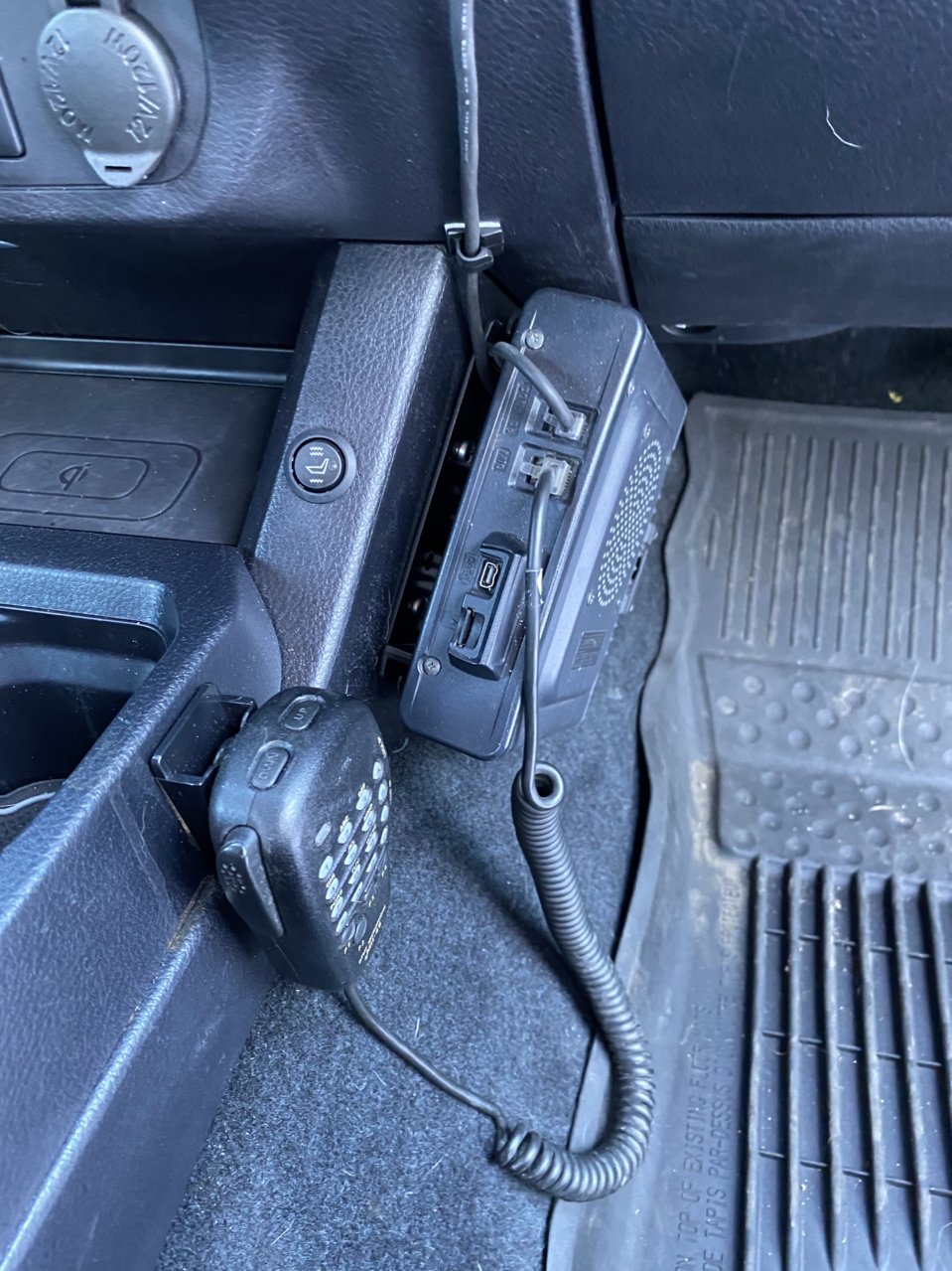

    Here is what I did. https://www.tacomaworld.com/threads/clean-vhf-cb-radio-installs.415584/page-60#post-20504043
    Bought the mount on Etsy (see below for example) as my Icom 2730 has a metal plate you can attach to the head unit. Next I removed the center console/wireless charger area and just looped zip ties around that to hold the radio body on the passenger side in the footwell.

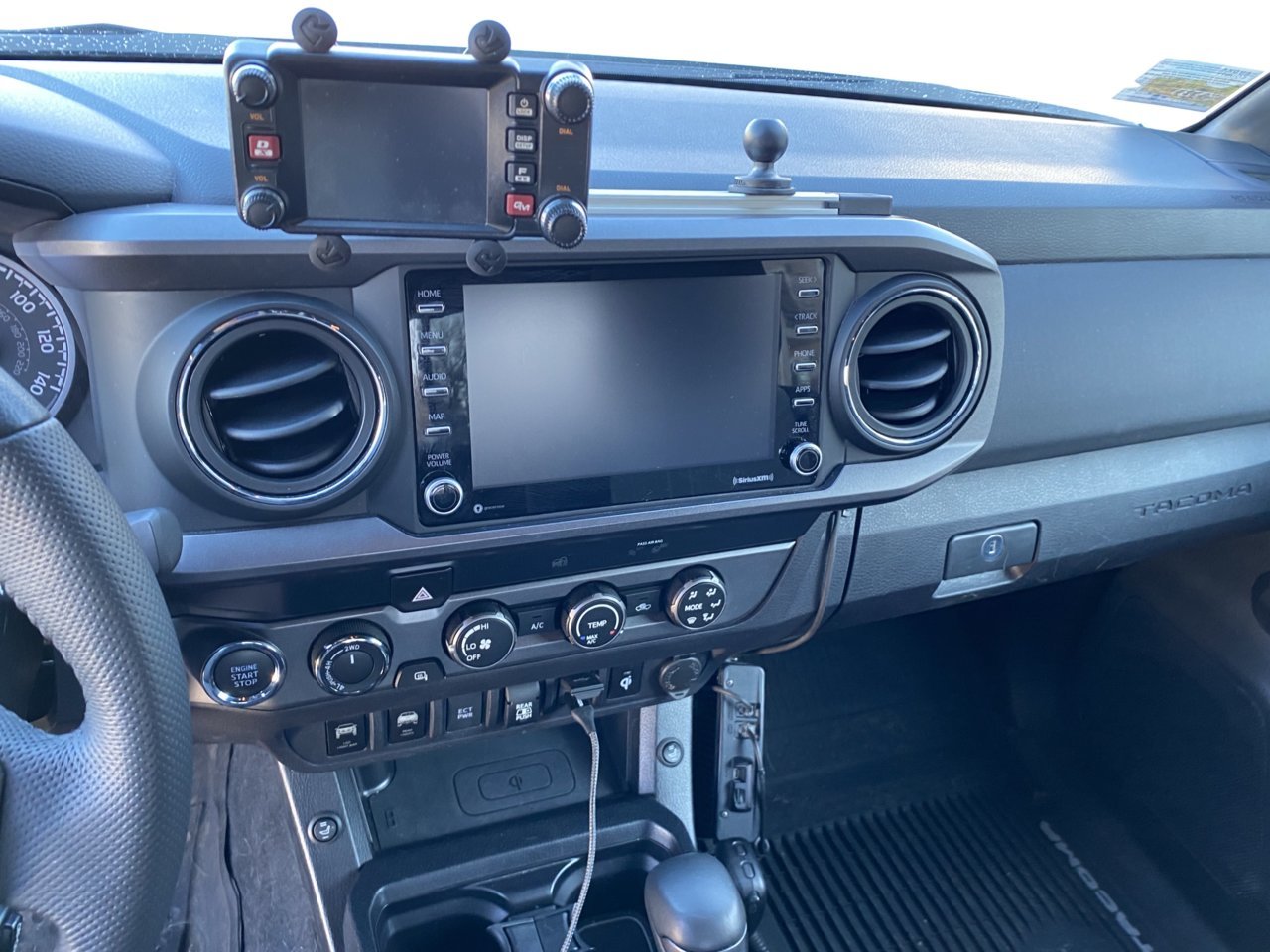

    Here's mine. Easy to see, no looking down and everything is at eye level. The transmitter is behind the back seat. I use a magnetic mount antenna.

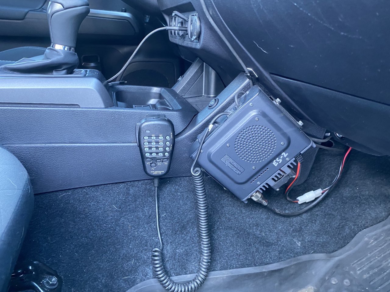

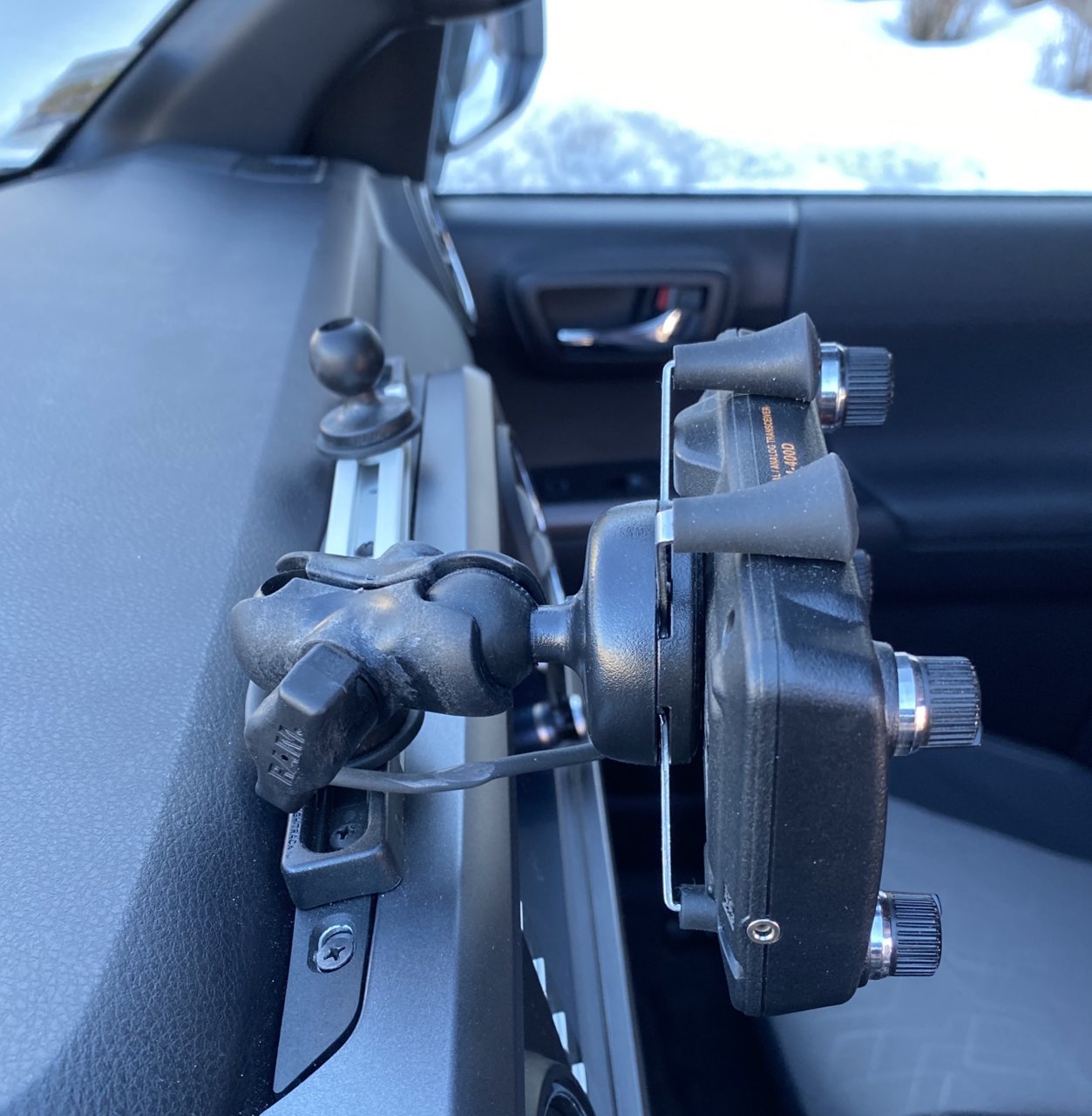

    Let's see if this is helpful. This is a Yaesu FTM-400 install in my 2020 TRDOR. The system is accessible, removable, and serviceable without being in the way of the driver or passenger or interfering otherwise with the cab space. Pardon the dog hair, because dogs do like trucks.
    The head unit is mounted using a Tacoma Track Mount bought through TacomaBeast. (https://tacomabeast.com/collections/accessory-mounts/products/tacoma-track-mount-2016-2019)
    The antenna is mounted using a CBI antenna/ditch light mount. (https://cbioffroadfab.com/product/3rd-gen-tacoma-antenna-mount/)
    The main unit is mounted using using the Yaesu MMB-60 bracket. (https://www.dxengineering.com/parts/ysu-mmb-60)
    MidWestTRDPro and Old Marine Cal like this.
  11. Feb 28, 2020 at 7:56 AM
    calebc
    calebc Well-Known Member

  12. Feb 28, 2020 at 7:58 AM
    EchoDeltaSierra
    EchoDeltaSierra Well-Known Member
    Apr 13, 2015
    #153078
    415
    Georgetown, TX
    2020 TRD Off-Road
    Nitro 4.88 gears OME suspension ST/Maxx 255/85R16s
    It was machine screws, not wood. I'll _always_ have two radios in my truck, mobile and handheld. The thing that took the most time was deciding where to mount that damn thing were I could move the seats and use all the storage. I restored to permanently affixing the bracket.

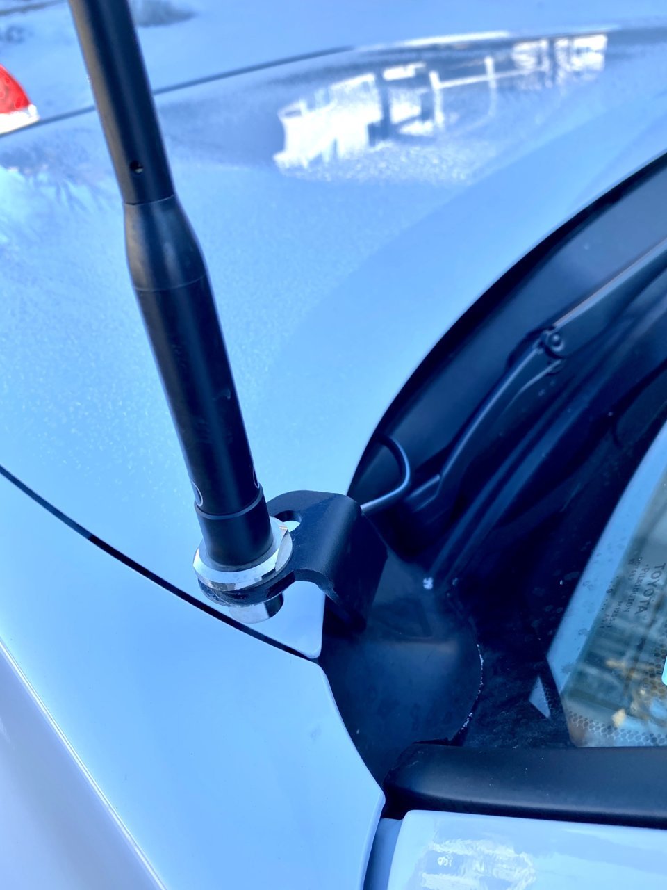

    connerclan97
    connerclan97 Southern Xpeditions
    Aug 18, 2017
    #227212
    289
    Steven
    South MS/Northeast TN
    2018 Black Tacoma TRD Off-Road 4x4 DCLB
    List of mods in build thread
    Mine is mounted to the left side of my console, up by the dash. I’m running a Diamond K400 lip mount with a Larsen antenna. This is a horrible pic of the antenna mount, but you get the idea.
