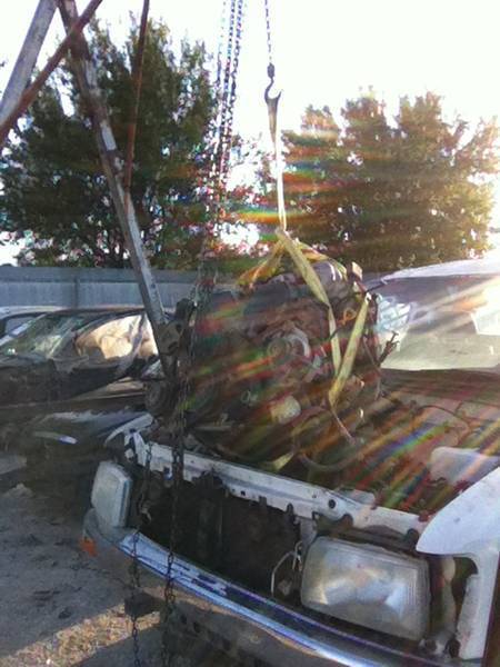

    i pulled an engine from the junk yard for $220 to build it came with a power steering pump, ac compressor and alternator. for that price.
    when i pulled it i was just going to put it in and be done with it but me and a buddy pulled the valve cover off and time cover off and to my suprise it was a super clean engine. new timing belt and new water pump. cams are clean and there is not a single grind in them like my current cams.

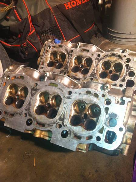

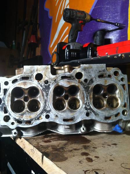

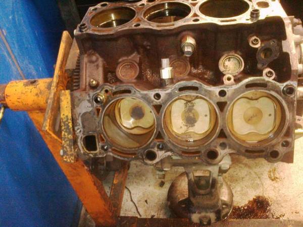

    i decided to get the heads off and see what we were working with for pistons and cyl walls.
    theres a little carbon on them but not to bad. hardly any blow by like my old engine.

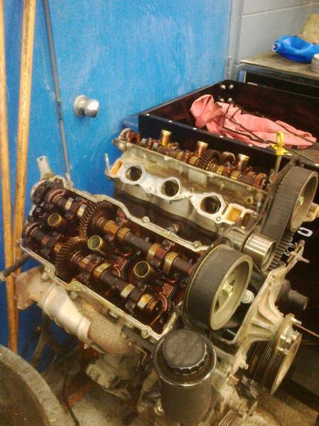

    doing a top engine soak now...with some stuff, idk what it is but my tech said "its the shit"
    so here the cam shaft we pulled out.

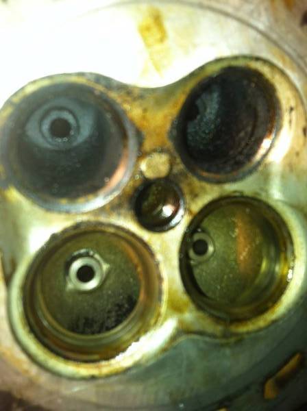

    after an engine soak. cleaned all the carbon off.

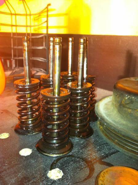

    i did this in about 2 hours, i broke the heads down to their components. valves, springs, retainers and keepers all out. it didnt take very long at all, it will take a ton more patiance to get them back together.
    these were taken apart using a 8" C clamp and a 17mm socket, i will cut the side out of the socket to put them back in when i get the heads decked and lap the valves.
