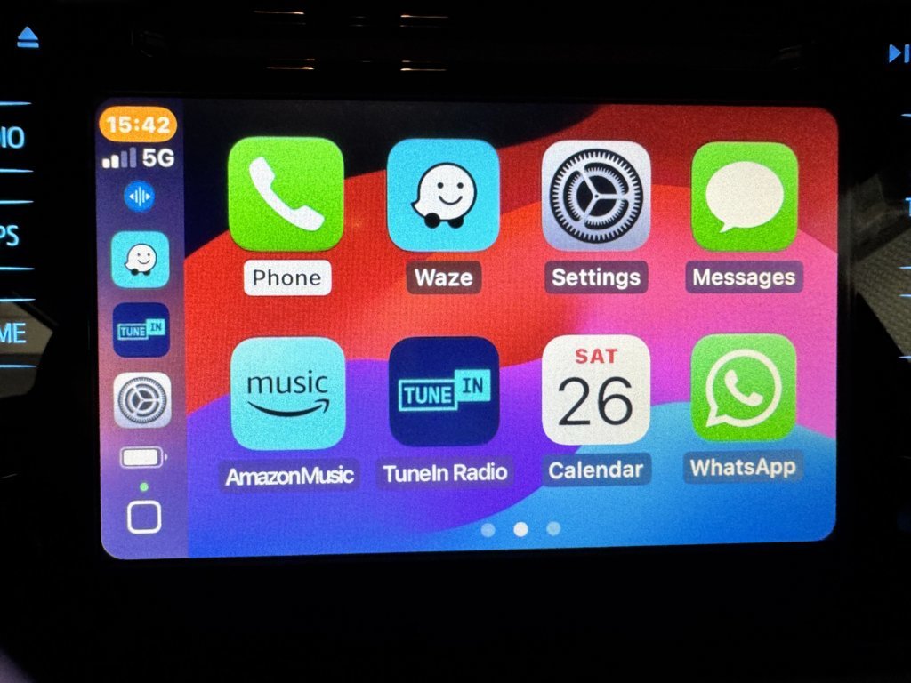

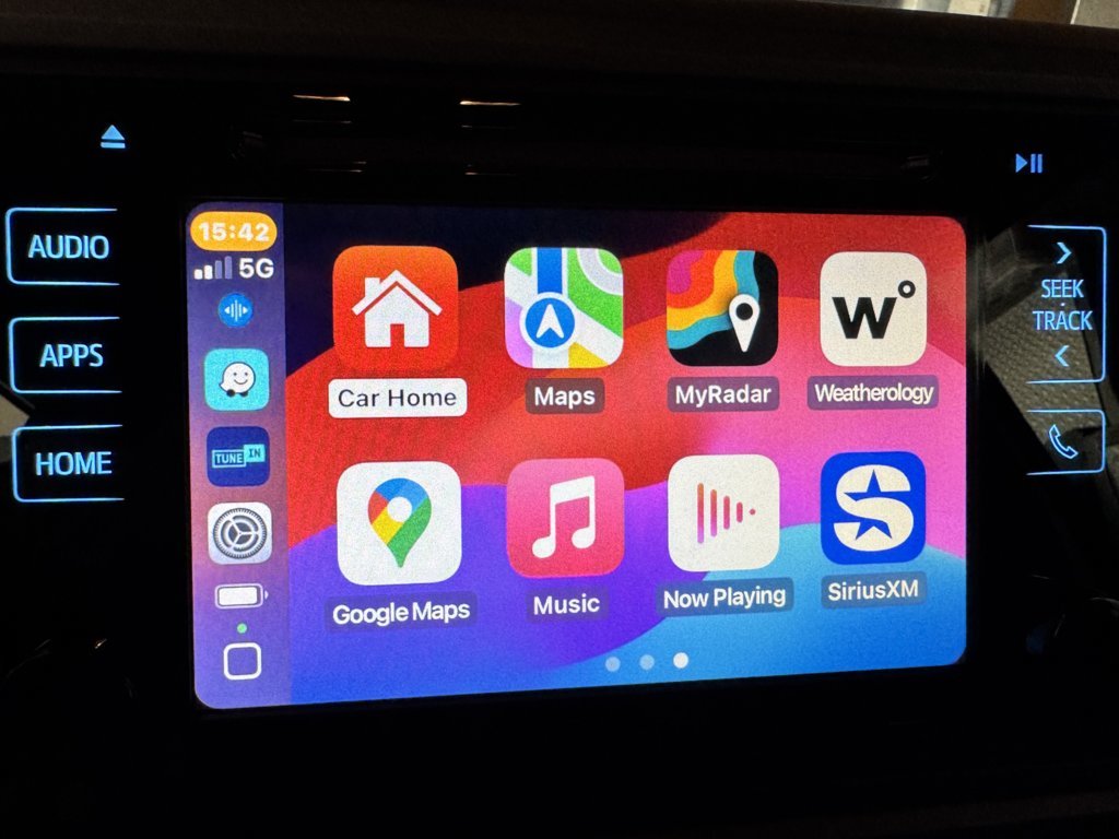

    I posted a photo of my CarPlay screen and it appears to me that resolution is excellent. I've only had the CarPlay module since February, but cannot detect any difference in speed between it and OEM. But then again I am very old. I also believe that Hamilton offers everyone the $50 welcome discount which reduces the price. Hope you enjoy it.IMG_2622.jpg IMG_2621.jpg

    Yes…I have the Hamilton Motor Company CarPlay module and couldn’t be more pleased. I’m listening to KSLT Radio right now on TuneIn and it is crystal clear with no pauses or lags…just music. If you get the Hamilton unit I’m sure you will be pleased. My rig is a 2017 TRD OR.
