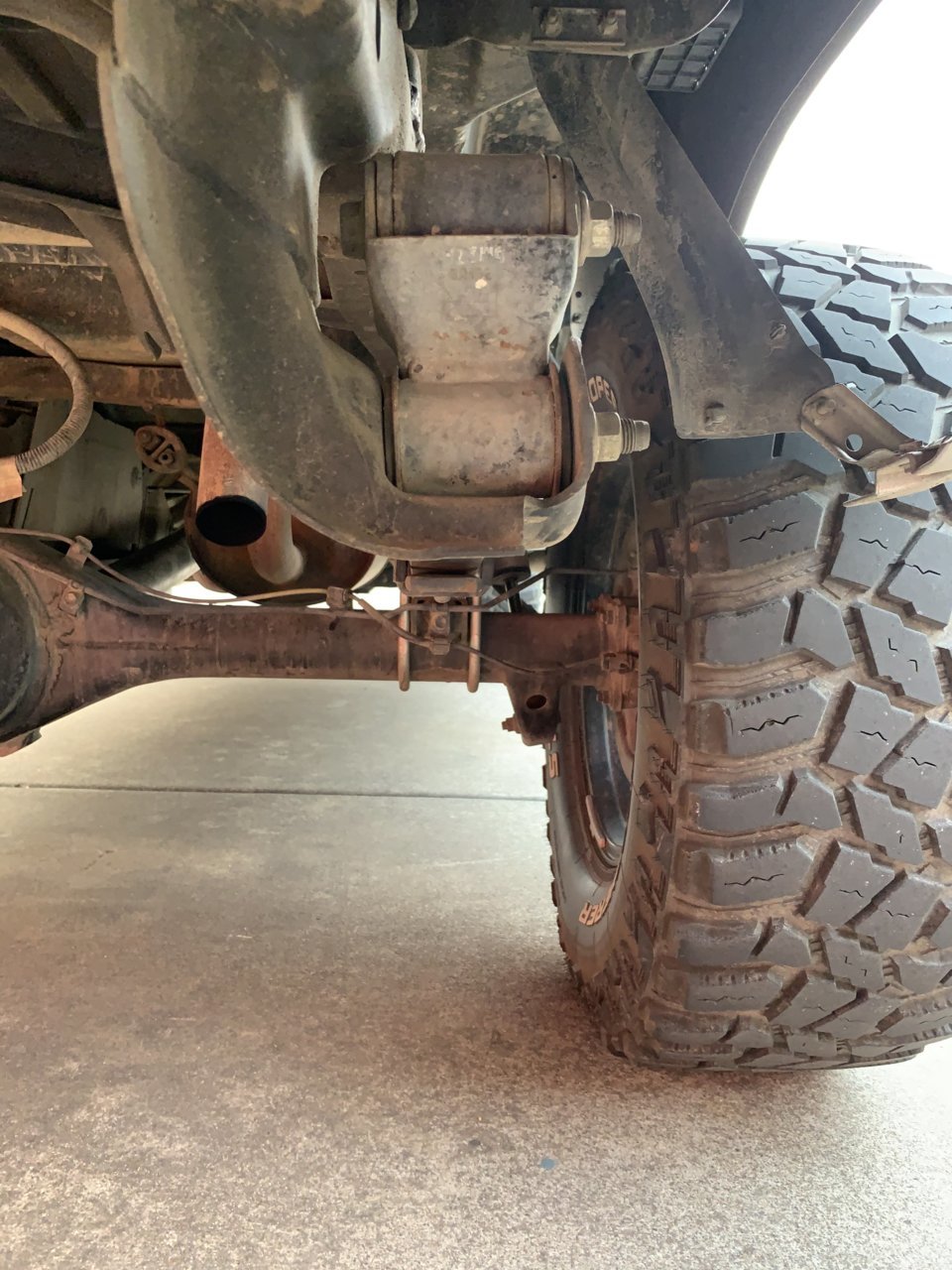

    Been trying to decide between the two styles myself after discovering this;
    I knew I had a problem a couple months ago, but now it’s stressing my leaf!
    BAMF is winning on price, but that’s all I know for sure. I read somewhere that my 47R Dakar’s will bind with the BAMF hangers...?

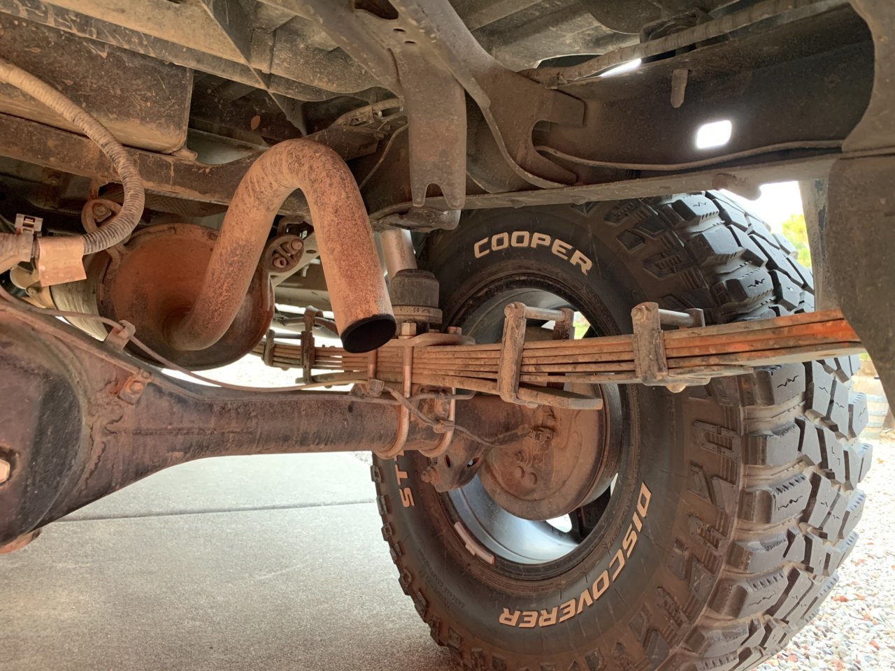

    Re: Dakars, they'll bind in any hangers when they get drooped out. The leafs fan out and the second leaf can get jammed in the shackle. The fix is easy, just trim off 1" from the end of the second leaf.

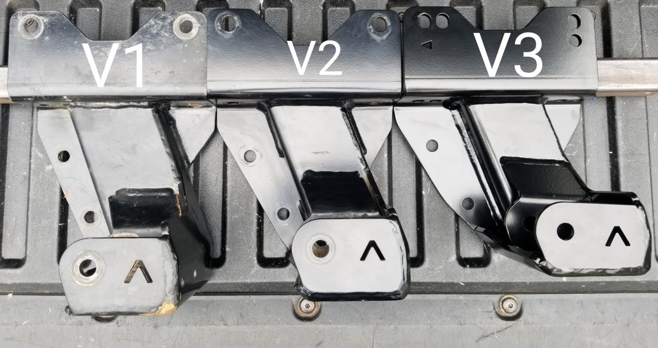

    Here's a link to some of the updates on the Hh version 3, the highest clearance hangers on the market, which started shipping in August 2020
    https://www.tacomaworld.com/posts/24090674
    There are nearly a few years of info out there now and some of it is outdated now

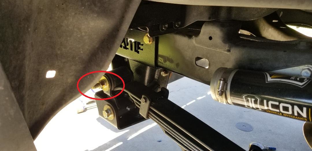

    I went with BAMF cause the Archive ones had the possibility of flipping the shackle out of the hanger if it drooped too much. I don't know if it was fixed/addressed. Along with the BAMF customer service.
    Edit for pic

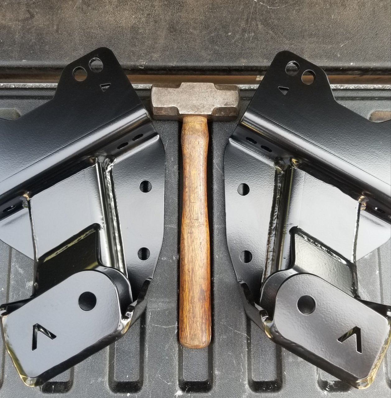

    The possibility was eliminated by having the ramped front lip all the way across, which makes the Hammer hangers really rigid and tough, and also why they get rave reviews for ride quality, and of course durability off the charts.
    The real reason some people had that happen is because they had another brand relocation and it was improperly setup or it was not possible to put the shock tabs low enough, so it bottomed out the shock and let the springs over extend, Hammer hangers did their job and increased droop, just bad shock setup. It would be like putting a 16" shock in the Archive relocation. I have a drawing to explain it.
