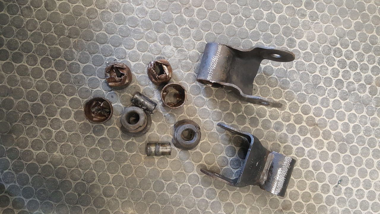

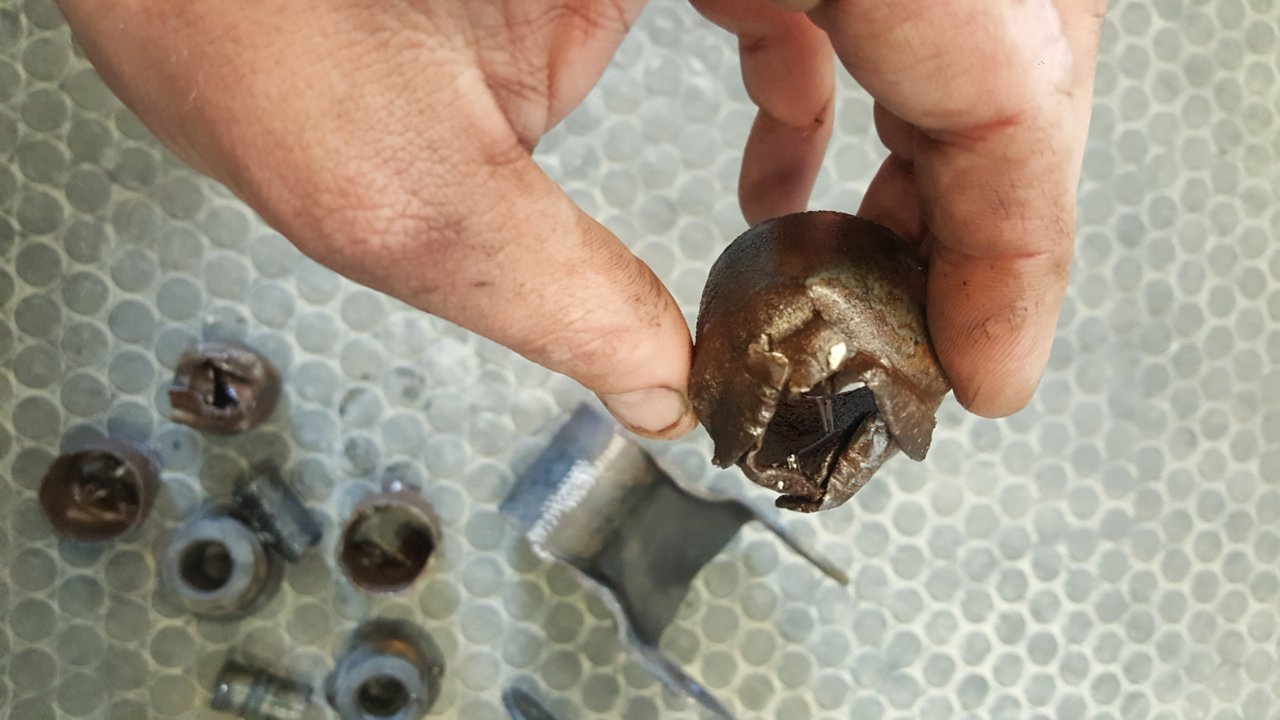

    So I screwed up and mangled a shackle bushing. Eric schooled me about separating the metal sleeves from the shackles and was then kind enough to drop one in the mail last night. Cant compliment him enough. And these hangers are the most legit suspension upgrade you can do as a favor to yourself.

    Heres the secret. Get a dremel and metal cutting blade. Grab your AirCat or whatever Harbor Freight Air Saw with about 3 or 4 blades. Cut 4 slits in the metal inserts on the rolled edge with the dremel. Continue on those slits into the body (phrasing) of the shackle with the Air Saw. Grab a rubber hammer and flat head screw driver. Beat the 4 individual cuts inward. Do it on both sides of the shackle. PB Blaster is your friend now. Once you have the 4 sections beat inward of the shackle, take your hammer and punch or screw driver and punch it out. Here is the aftermath.
    Metal inserts gone...that I didn't know were there...FML...Thanks Eric!
