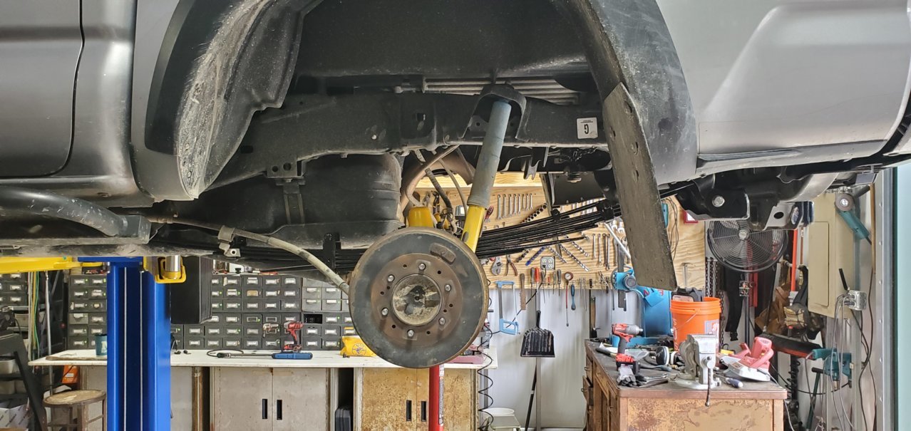

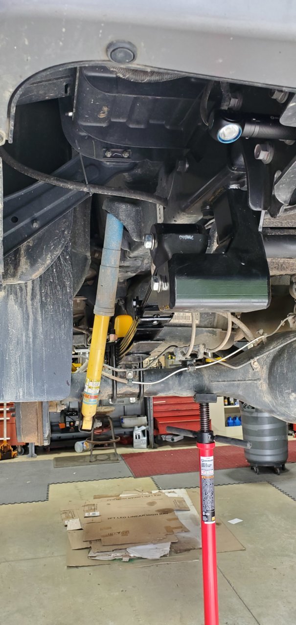

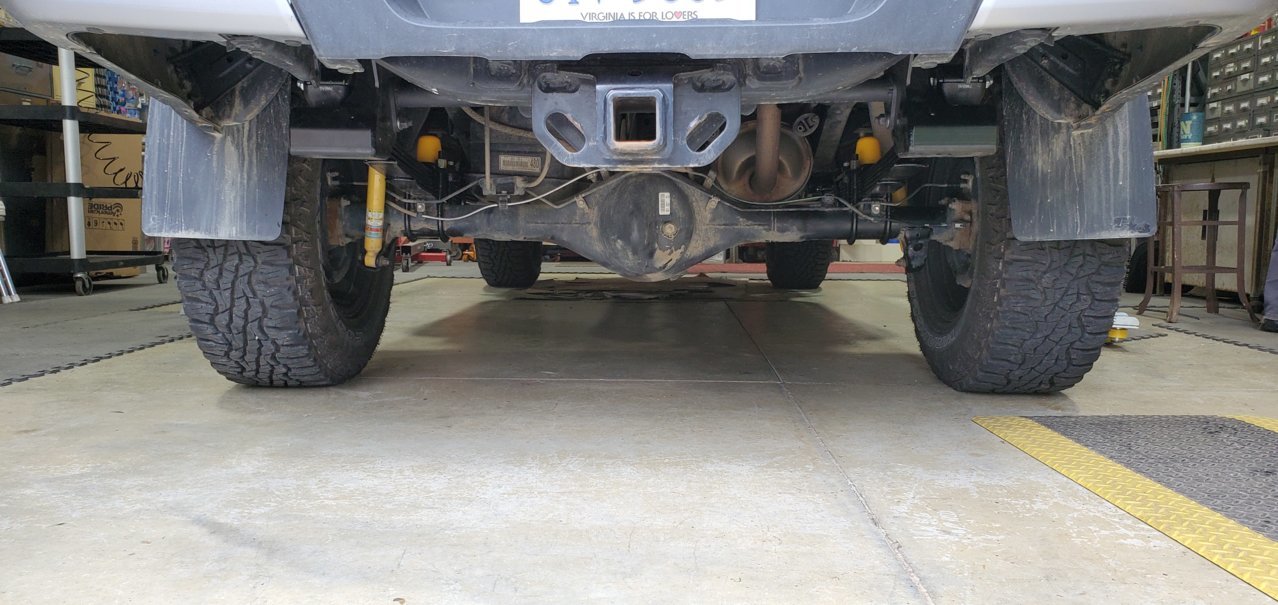

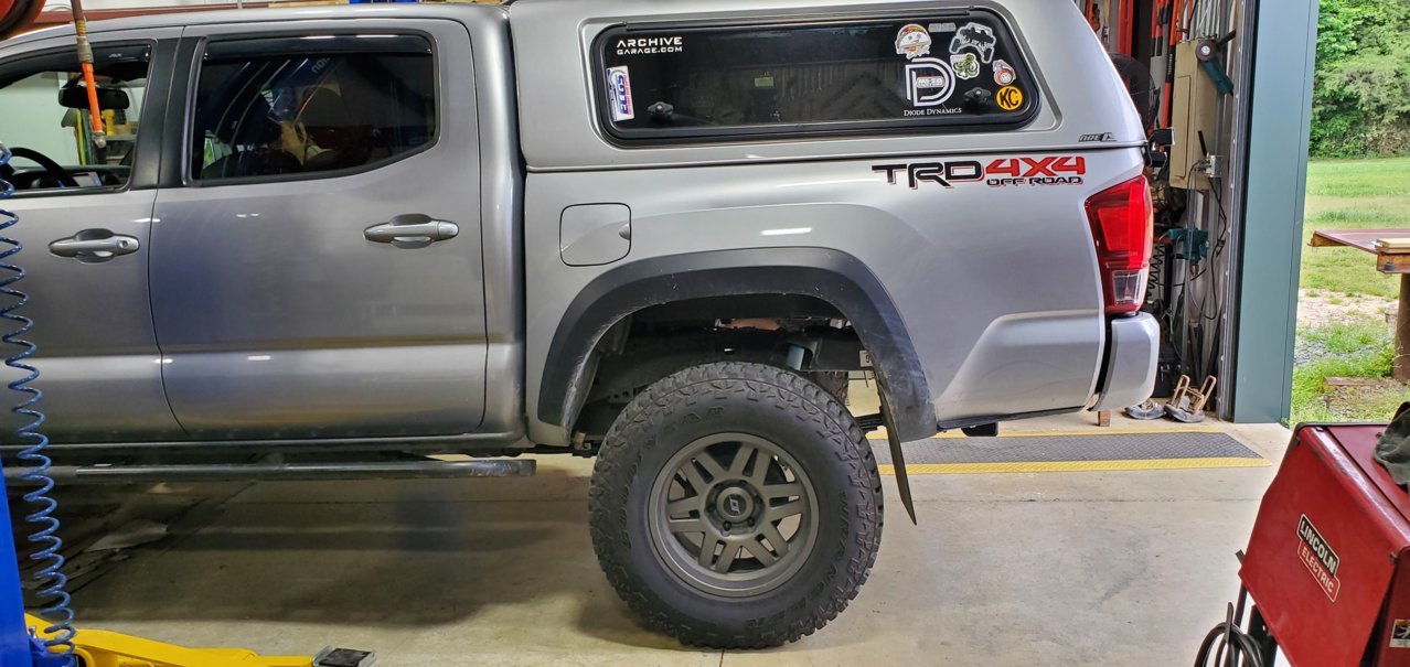

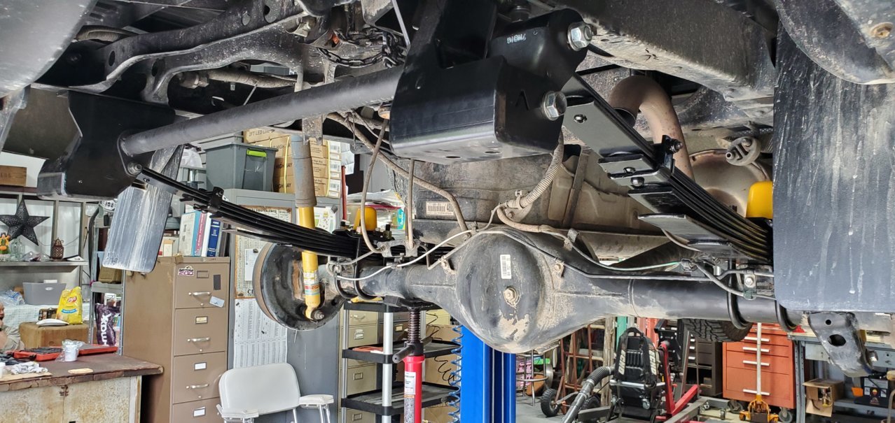

    So I upgraded (sorry Eric:anonymous:) my leaf springs with the Dobinsons L59-111-R Heavy (comp to Medium Dakar level but I think max 880#).
    So most all of my edc (tools, recovery gear, 285/70r17 spare, etc.) items are out in the photos/install.
    Took pre-leaf measurement off the hitch bottom in the nearly level garage floor (photos aren't at same location though):
    Before 16.25"
    After 19"
    [​IMG][​IMG]
    Install of the @ARCHIVE u-bolt flip kit and his bump stops was smooth, ended up cutting 3/4" off the top once snug for clearance and assurance should a better, say East coast fabricator for instance, larger stack of leafs be needed I'd have room to adjust.
    Dobinsons L59-111-R leaf installwinstall p
    went smoothly.
    Drilled out the e-brake bracket to mount using the @cubie fix a la the front bracket bolt.[​IMG]20200524_152121.jpg 20200524_152112.jpg
    Can't say enough about the absolute fit, finish (crosstube is diy) and beefiness, it is undeniable. The reality is the HH's are now one step further enhanced by the new leaf's...bumps haven't been "tested" yet.
