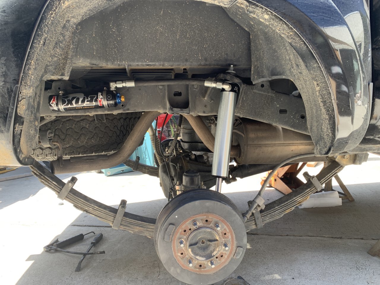

    Yeah, I heard some audible sounds when I semi whipped around the bend in my office small parking lot.20200526_123244.jpg
    You can see where it's lifted more (subdued line/different texture or matte finish.)

    Went with Dobinsons, the sleeves have 2 sets of holes for their hollow zerk end fitted bolt sets...apparently bypasses needing to pull them off. I didn't get their bolts. I reused my HH hardware and the front shackle OE hardware.
    I did have to drill out the e brake bracket and used the front end leaf1st bracket for mounting it.

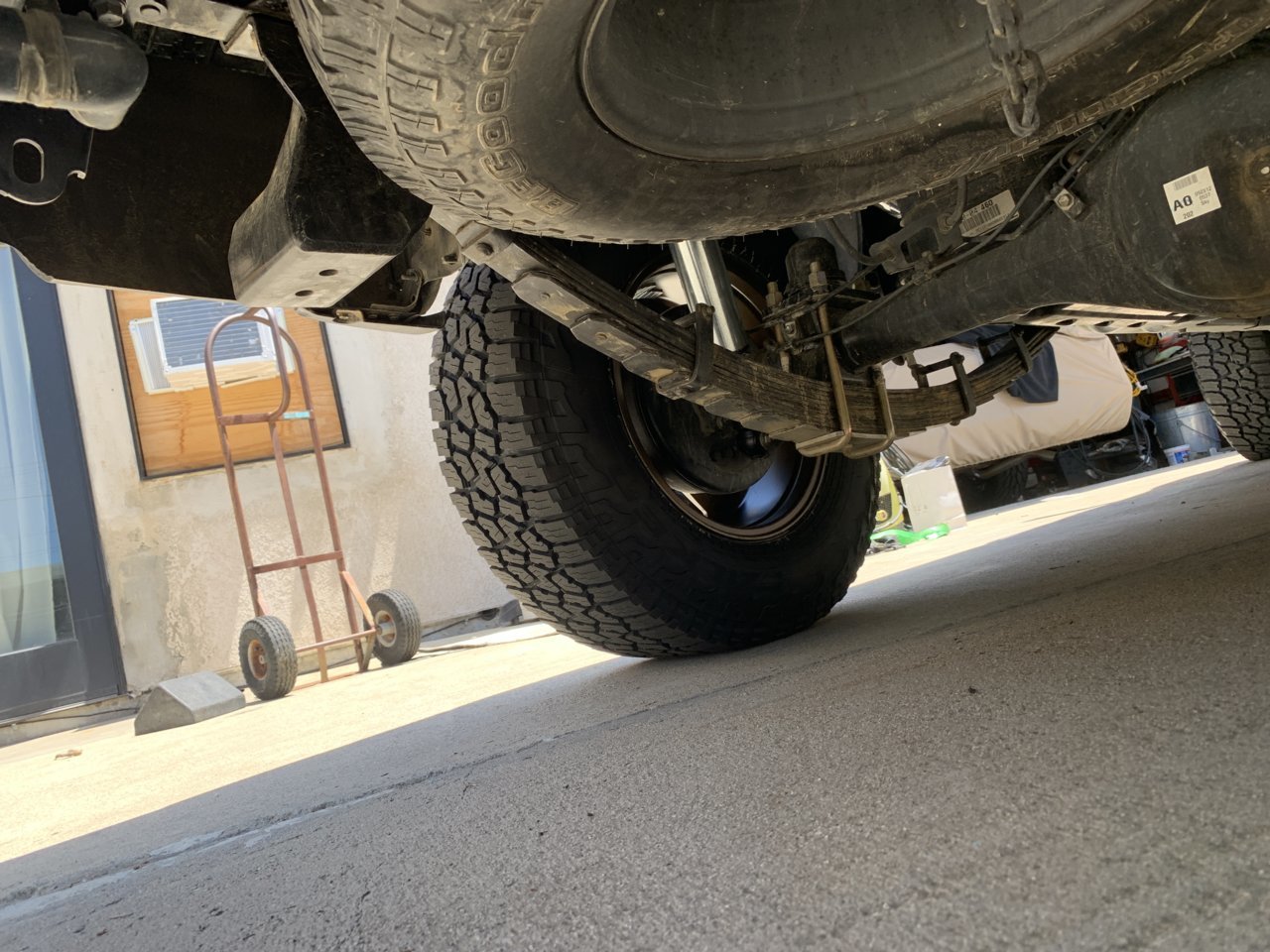

    Read about the Dakar leaf issue, noticed this today.....lame. although I’m sure it’s better with the hangers
    ARCHIVE[OP] likes this.
  18. May 31, 2020 at 6:38 PM
    #2018
    EatSleepTacos
    Mar 24, 2015
    #151688
    59,846
    Randy
    West Valley, AZ
    2017 4Runner
    Not quite that bad but still an issue. I recommend trimming the second leaf back, about 3/4”-1”
