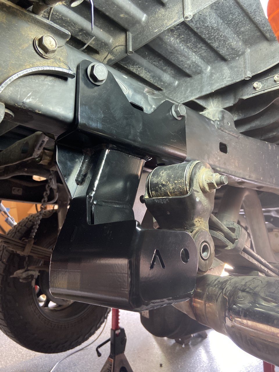

    Installed my HH last week...install was surely a PITA but easily doable with patience. I found it easy to just cut the stock hanger parallel with the frame about 1/4” under the frame to get to the bottom rivets easier. Excellent quality, construction, powder coating, and packaging.
    Ride quality improvement is immediately noticable. Can’t wait for my Deavers and Fox DSC through accutune to get here.
    Im currently on factory leafs with an icon AAL with overload left in and they feel so much better for those wondering.
    (pic was just mocked up to make sure all holes aligned.)

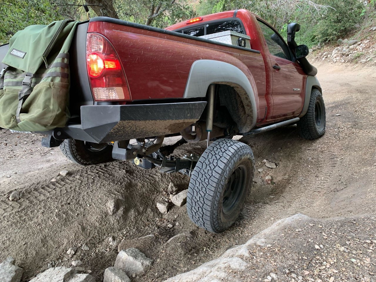

    Nice little Flex Friday showing @whatstcp setup with Hh, Archive shock relocation and Dakars. Notice the Dakars are not all fanned out like happens with stock location shackle pivot point.
    And with the Archive relocation, he actually has full bump travel, not just droop, plus 2.5" shocks for the plush ride and cooling. Win. Win.

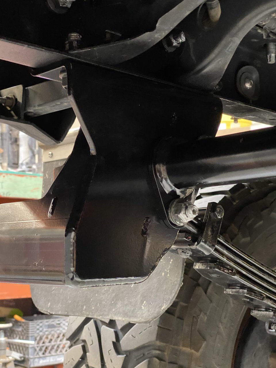

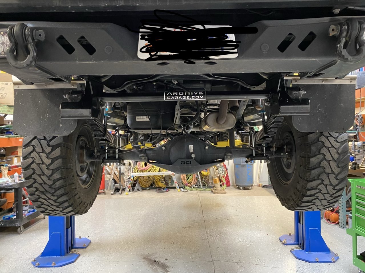

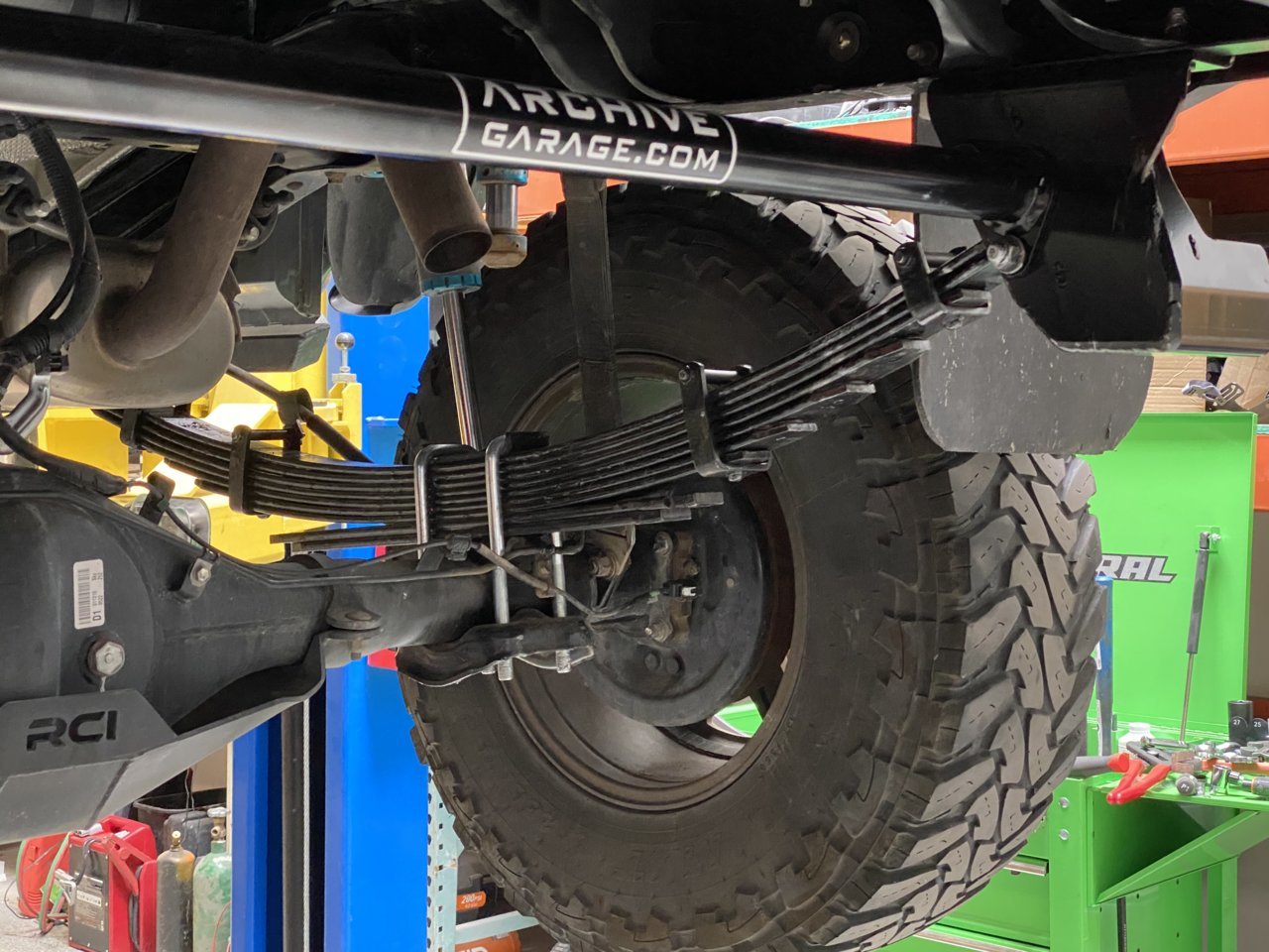

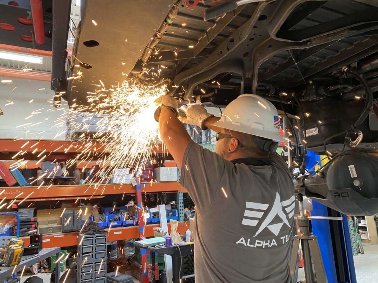

  19. Jul 2, 2020 at 7:09 PM
    #2119
    H3llRid3r
    H3llRid3r Well-Known Member
    Jan 23, 2017
    #208396
    3,458
    SLcUT
    2018 DCSB Cement TRD OR
    Not much stock left.
    Made this happen today.
    It went relatively smooth. Took about four hours to complete. The plasma cutter comes in handy, and the fact that I had knowledgeable people at the shop to guide me.
    We ran into two snags. First, had most everything put back together, then noticed the U402R III was on the left and the U402L III was on the right. Not sure why it matters, but swapped them anyway.
    Once again got everything 100% put back together, when a co-worker noticed the bolt on the upper shackle was facing the wrong direction. That sucked! A 5’ pry bar and some cuss words got it swapped around.
    These hangers are amazing. I freaking Love them. Smoothes the ride out while cutting down on the ass end chatter.
