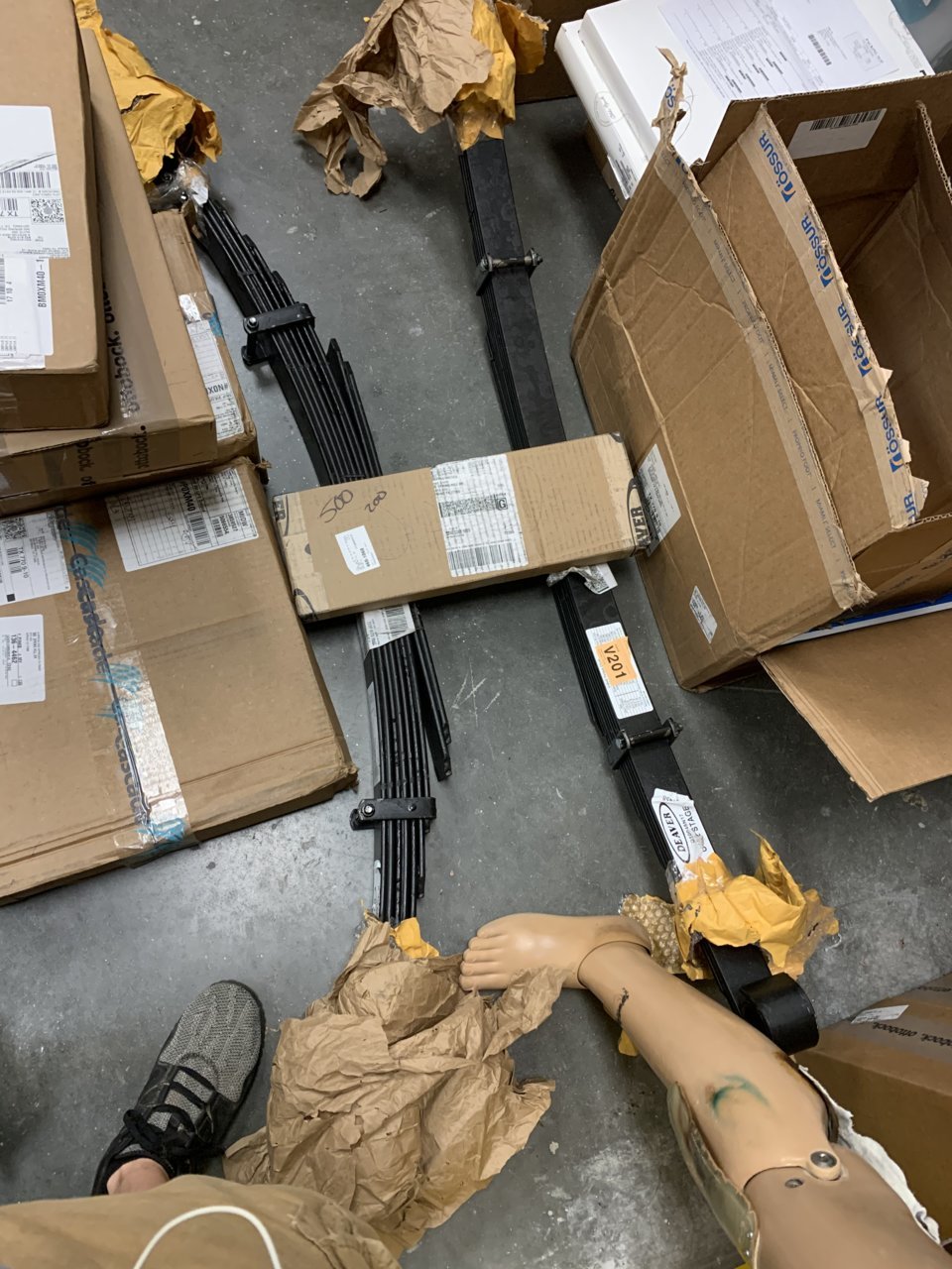

    From everything I’ve read and the comments from eric I chose deavers as well...and they just showed up on Saturday...can’t wait to get them on. I will more than likely install the cross tube as well in the near future too.

    Ol'gray mare
    Ol'gray mare Well-Known Member
    May 13, 2019
    #293171
    427
    West, Tx
    2017 MGM DCLB TRD OR Geared, locked and tuned, rear disc brakes. 2018 TRD PRO White boss' bone stock
    Build thread coming soon.
    You will not regret the Deavers. I love mine, U402 stage 2. Now that know about the HH and all the rave reviews I can't wait to get them with the cross tube and experience them for my self. Some times I think my truck is riding a little rough after having them in for 2yrs now. Then I get in the boss's stock '18 pro and realize just how spoiled I am.

    whats up with the fake leg?! :anonymous:
    my Deaver stage 3’s will be here tomorrow. Can’t wait to get them on. HH’s should be shipping in about two weeks as well. Will be installing everything at once probably.

    I make prosthetics...I have all my parts sent to the office so I can sneak them in the garage so wifey doesn’t know.
