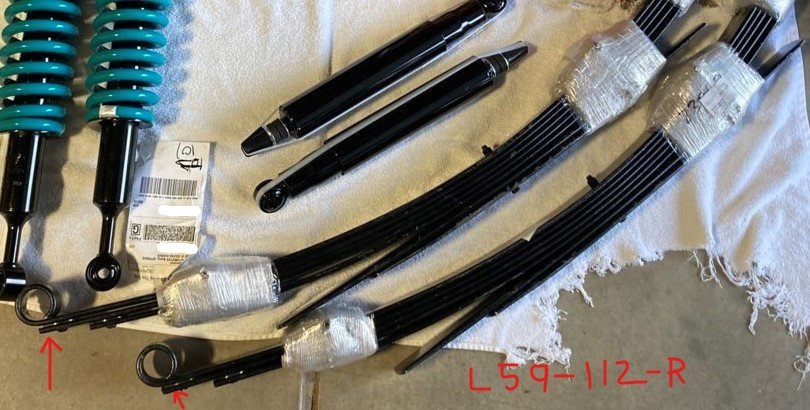

    9/1 UPDATE:
    8/23 orginal post:
    Borrowed this pic from @doubleb97 to warn customers with the super heavy Dobinsons L59-112-R (5/2) springs that there is going to be the same shackle interference, squeaking and damage that happens with the terrible OME leaf packs.
    The reason is the 2nd leaf from top extends inside the shackles, this is a design flaw and will require the 2nd leaf on the 112's only to be trimmed for proper function without interference.
    EDIT: current versions of Dobinsons L59-110-R (3/2) and L59-111-R (4/2) now have this issue because they were revised and 2nd leaf DOES extend inside the shackle. See this post:

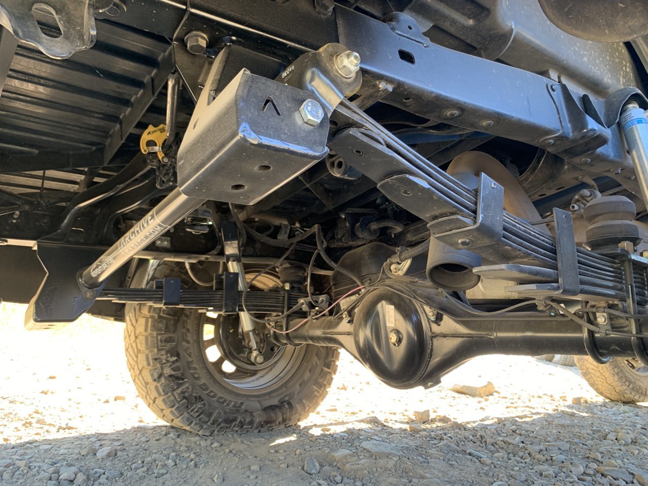

    Just sharing a nice pic of my HH & crossbar, I was under there removing the spare tire mechanism the other night. If you’re on the fence - DO NOT HESITATE to purchase the HH especially w the crossbar. It will make a tremendous difference in ride quality, durability & Flexion in the rear end (especially when paired with polybushings).
